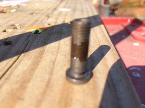

It does work very well. I only applied it to the section of the threads I would be using (center of the throw) and letting it dry for about 10 minutes. I suppose you could put it on all the threads but I didn't want to get "too much" and cause it to be gummy. Clean thread to get it started and all.
This pic is crap but it give you the idea. It was cold and I didn't see that camera (iphone) hadn't focused properly but you get the idea.
The nice thing is, if I want to go in or out a couple of turns, the screw stays where I leave it. Exactly what I wanted.
