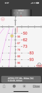

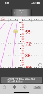

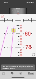

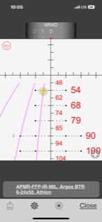

Which looks better to you same everything except scope
I love what you did here, but the MIL reticle is slightly different in the Midas Tac. It has a few more hash marks in the first MIL.
