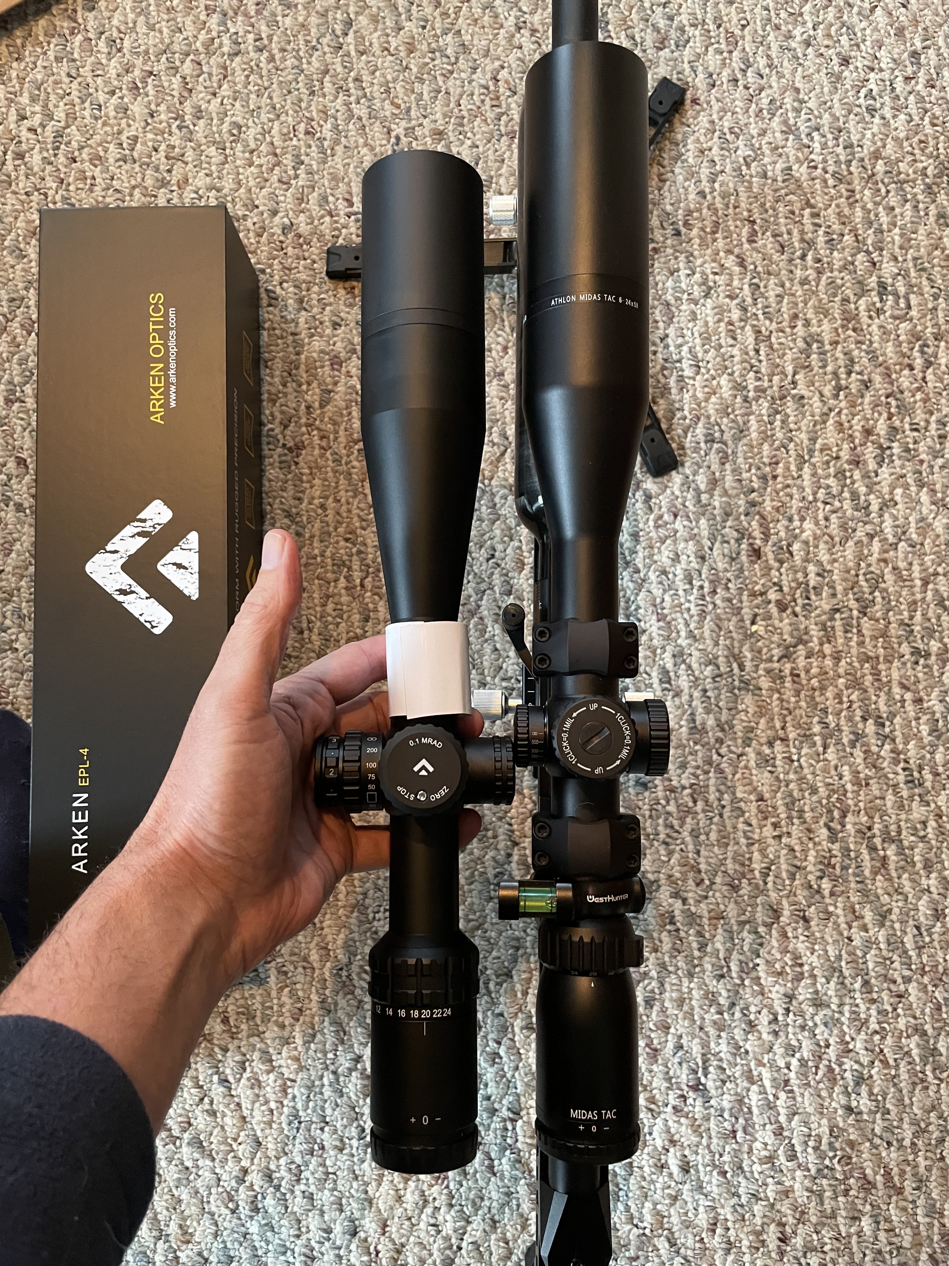

Midas Tac 6x24 and Arken EPL-4 6x24 (30mm tubes) side by side
Arken sent me the scope with it optically zeroed (middle of adjustments). They set the zero stop at this optical zero.

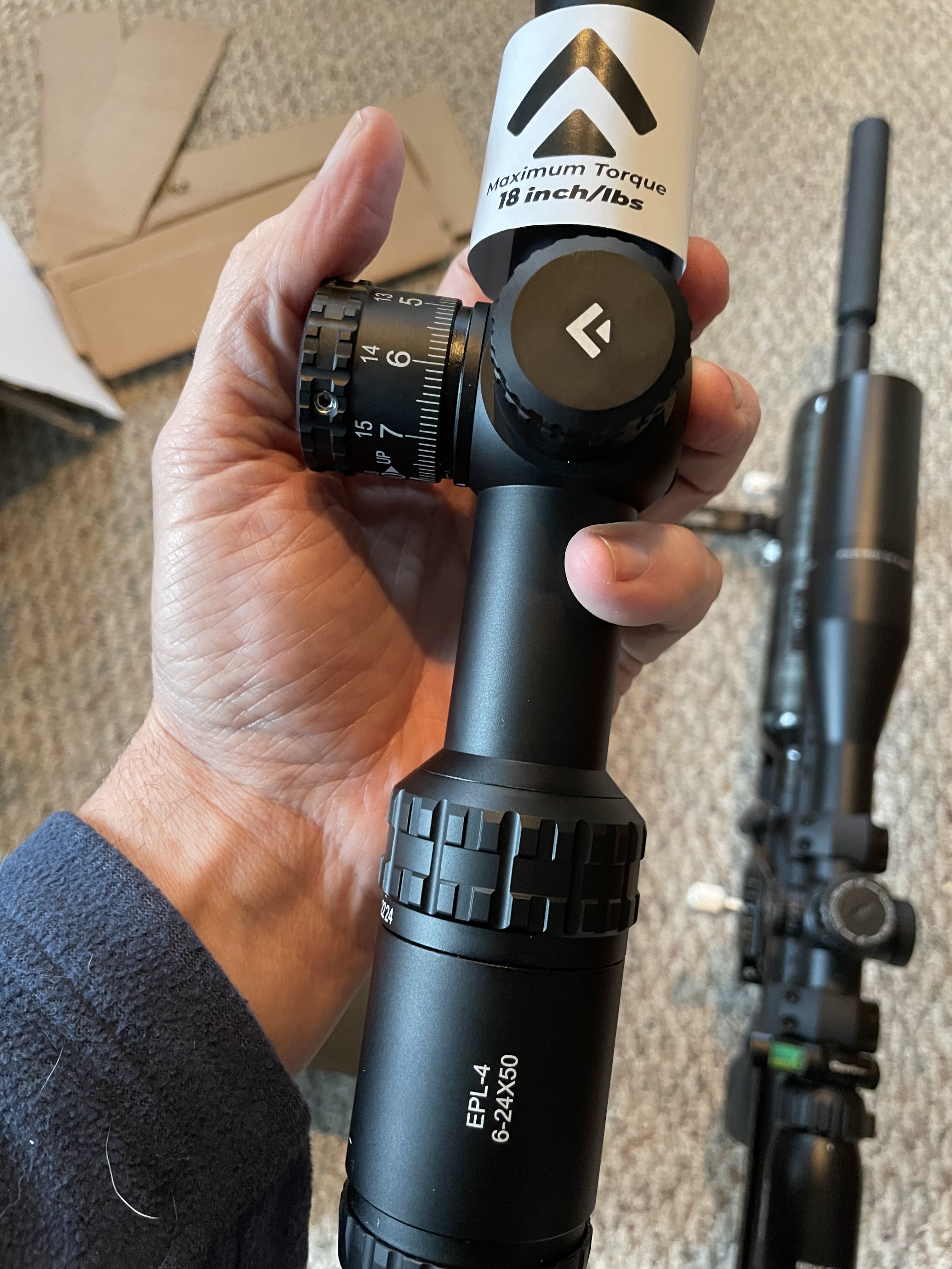

I spent some time with the Arken EPL-4 on my backyard “range” today.
Some things I noted:

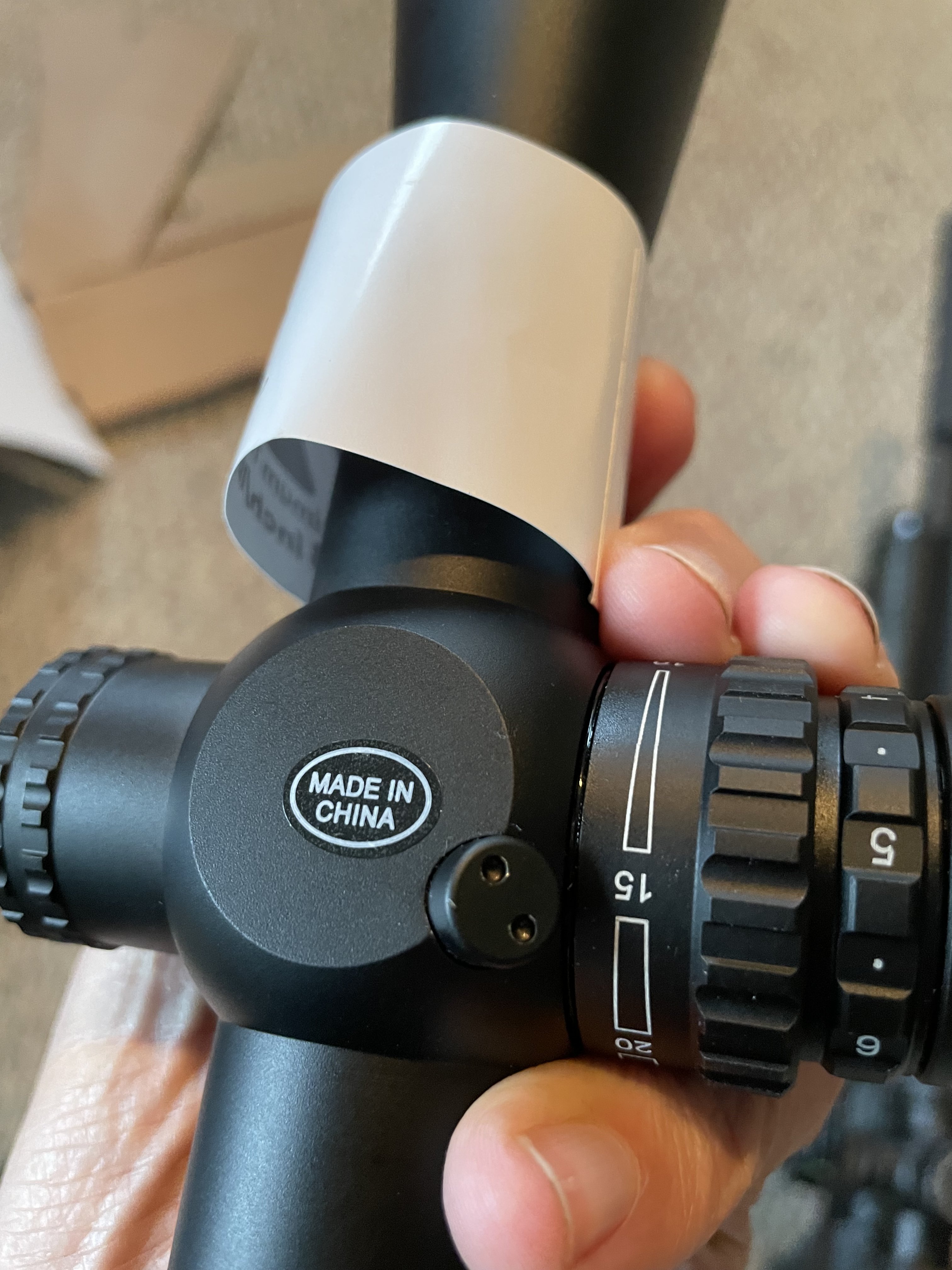

Arken sent me the scope with it optically zeroed (middle of adjustments). They set the zero stop at this optical zero. You just loosen the “zero” screw on top of the turret to allow you to move past the zero stop.
I mounted on my HW110 .22 and went to zero the scope at 15 yards - first shot hit my target dot - 1/2 size of dime. Nice job Weihrauch with rail and Arken with optical zero, lol.
Today I primarily tested ranging and parallax and minimum focus distance. I was able achieve a sharp focus (using up to 24x) at 35.52 feet from the front of the scope - I measure with a green laser supposedly accurate to 2mm at 100 yards. So, it’s pretty close to Arken’s specification of 10 yard minimum focus distance.
I had targets set at 30 (30.08), 35 (35.12) and 40 (39.98) yards. I had some very small text on the targets and focused till the text was very sharp. The distances on the parallax adjuster were pretty close, but were a couple yards short of actual distance… i.e. para scale showed 28 yards when actual distance was 30 yards. Parallax adjustment knob turned very smoothly.
Early thoughts on the glass quality… very nice at my distances today (out to 50 yards). Noticeably sharper than the Athlon Argos Gen 2 6x24 that I was also shooting with today. I did not get a chance to compare to my Midas Tac today - promise to do that soon. The Arken showed no CA fringing on the black text on white background targets. The Athlon Argos did show some slight CA on the same targets.
Final thought, the Arken definitely seems an excellent value at the $380 price point. Had that thought as soon as I achieved focus at a few distances today.
