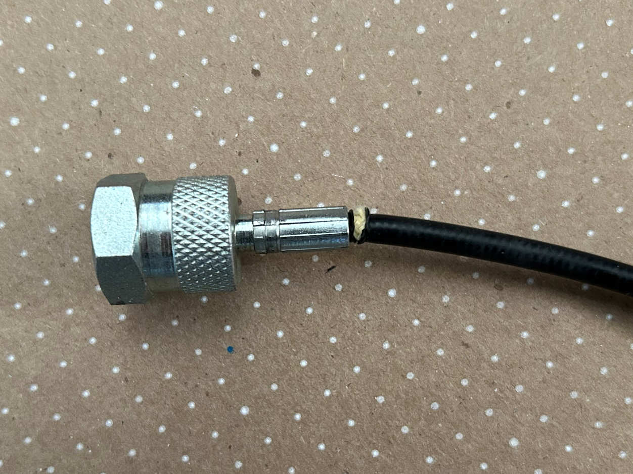

From time to time, persons comment on the safety of equipment operating at 4500 psi. I had a microbore hose fail this morning while shooting a tethered Panthera. There was no earth shattering ka-boom, only the sad hiss of a 9 liter tank venting to atmosphere. The hose was in-service for 19 years and treated gently.
JackHughs
A very long life, and a predictable failure point. I wonder if a strain relief on the ends would have extended it even further?
The hose had a coiled spring strain relief. I moved it out of the way to take the picture.
Aside from old age, this hose was permanently connected to the DIN 300 fitting. The replacement hose will connect using a Foster fitting so the hose can be removed and stored stress free between uses.
