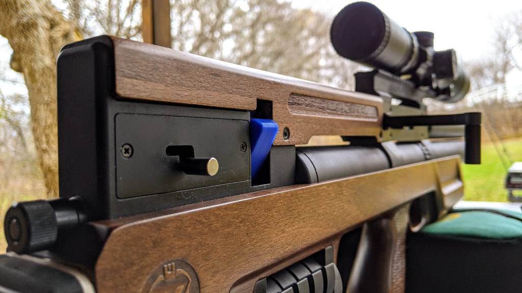

My eye is drawn towards the small knob above the butt plate. EDIT, "cocking indicator" hoping it was hammer spring adjuster.

That knob at the back of the butt plat is a hammer spring adjuster AND the cocking indicator :) I have the cricket II (non tactical) and there is a small rod that comes back when you cock it but it looks like they've made it much more visible!
Here is it in the cocked position:
@mcoulter, thank you.
may I ask, have you made use of the adjuster, and now did you find it.
@harrymoreland
Hi there, I found the hammer spring adjuster VERY stiff to turn initially. I've seen pics of some Crickets with holes drilled through the end knob which probably serve two purposes. It gives you a place to insert the end of a small allen key and also gives you some point of reference when turning it. It has loosened up a bit but its still stiff enough that I don't worry about it changing as I shoot the gun. The gun does have a pretty wide window for adjustment but as delivered I think the gun performs best with a pretty hard knock on the valve. I do see greater velocity spreads as I weaken (loosen) the hammer's hit.
