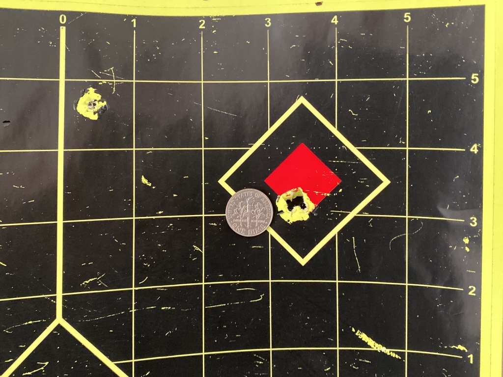

The weather has been totally nasty here, so I have only had my Taipan out with this final valve design with my reg set to right under 160bar. At this pressure - using a heavier spring and acetyl spring tensioner, I have maxed out the 28.5gr NSAs at 1002FPS (~63.5FPE) with the 600mm barrel. I'm just not seeing stellar the accuracy with anything above 25gr with that barrel though. I had a sub-dime size 5 shot group at 102 meters with the FX Hybrids which blew my mind!!!
