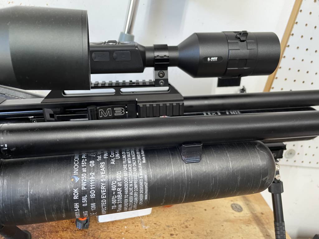

    I use the Griffin 32gr Boat tails at 1010fps; they fit in the magazine and cycle fine with the slug power kit with the pin probe. This is with the 700mm barrel and I purchased some $12 barrel harmonic spacer that fits on the carbon fiber bottle and under the barrel. Love the Maverick and it's my around the house chipmunk and squirrel killer albeit 70ft/lbs is definitely overkill but better to have more than not enough.

    That is some solid power! That will take care of pretty much any critter you want right there, no doubt. I have seen the Eaglevision magazines, and almost purchased one a few times, but managed to restrain myself, lol. Their mags are very well made from what I hear, and I think you'll like it. Do you have a link for this harmonic spacer you're using? I curious about what it looks like. I don't like the idea of wedging something between the shroud and the bottle, but if it works, then who am I to judge. I pretty much leave it at carbon lining the barrel, and tuning to get the harmonics under control. I think the harmonic tuner that FX will be selling is a solid concept though.

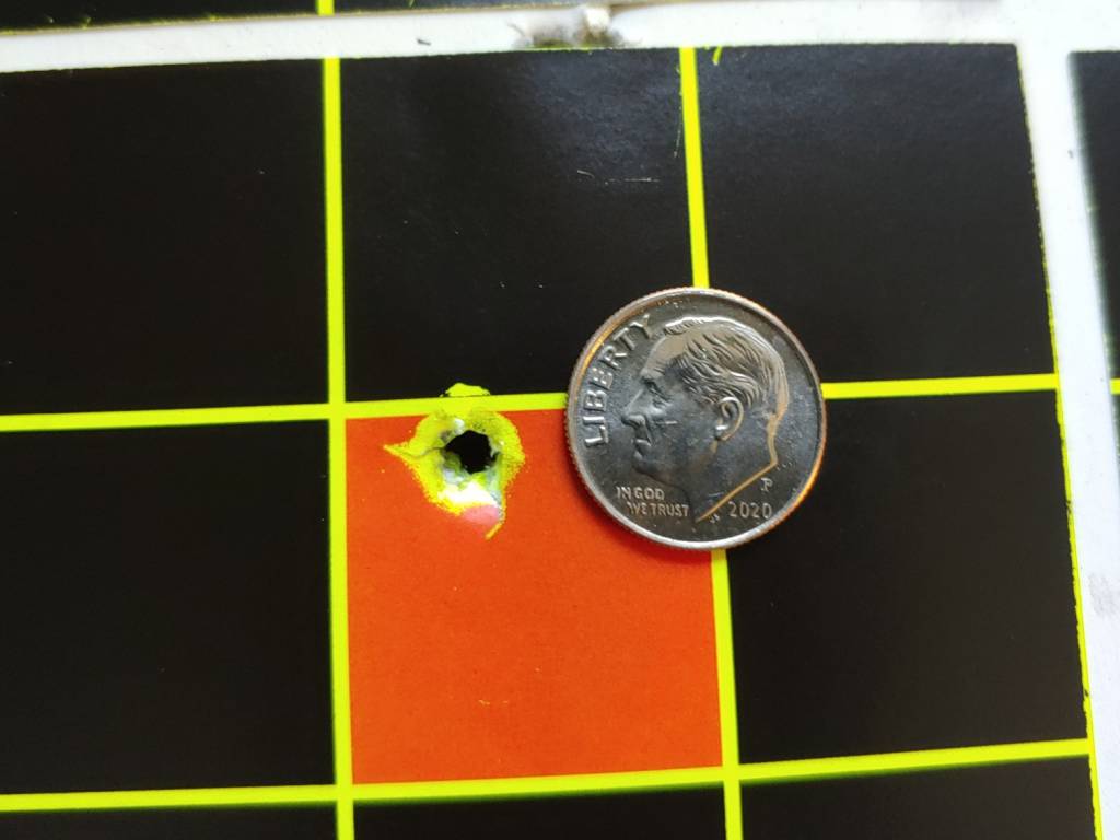

    I did get to do a little testing today with the Griffin 36 grain slugs, and they did not disappoint. I didn't have much time so, I only tested them from 970-1015 fps. They shot pretty well at all speeds. At 1015 fps, I managed to put 4 through the exact same hole at 30 yards! I don't mean a ragged hole, I mean it looks like one shot on target. I stopped at 4 shots, because I chickened out on the 5th shot, lol. I didn't want to mess up that group! That is about the best group I've ever shot I think. That isn't to say I don't have ammo that is as accurate, but I don't usually have the patience for shooting groups.. Obviously, more testing is required at longer distances and whatnot. If that accuracy holds, I will try and get a porker with those 36 grainers! So far, it is looking like the Griffin heavy slug option is a winner!
