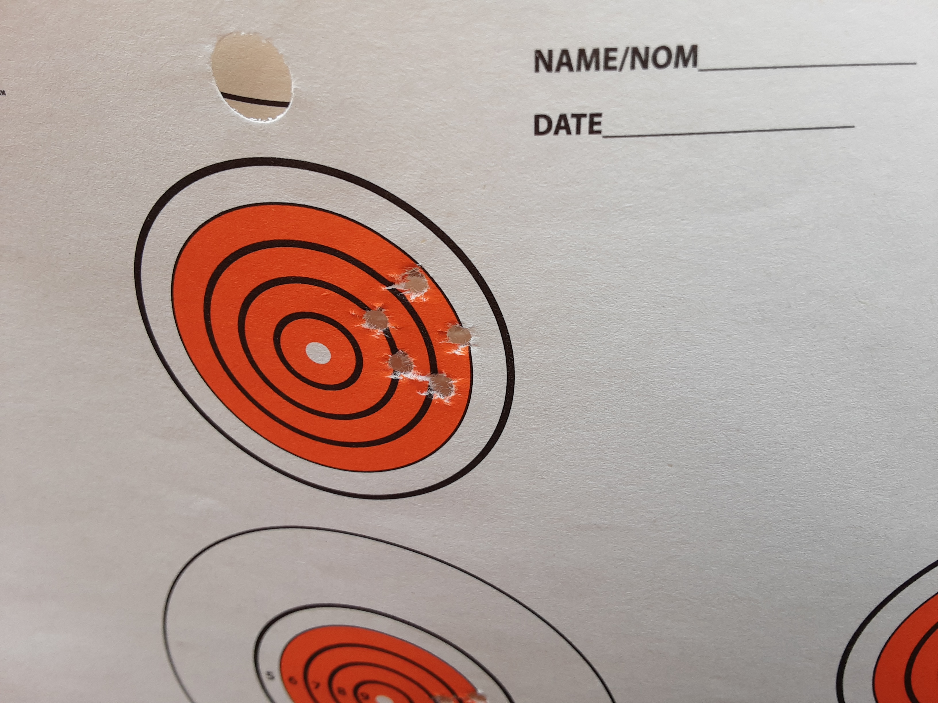

I was looking for a thread about what works with the Maverick and the standard liner. I have tried the nsa 17.5g and the 20.2g . I've had some decent groups but not very constant in accuracy or SD. It's mostly my fault for thinking the .217 would fit like the FX .217 hybrids diameter. There are a bit loose in the chamber or liner lead and gave me large swings in fps.
Then FX 22g hybrids give me more than acceptable accuracy and better SD with the factory liner.
I'm shooting a Maverick vp w 600mm barrel and 11g hammer with 110 bar on the 2nd reg. It's hitting around 930 fps and just over 42 fpe . I will probably just leave the Maverick set for the FX .22g slugs and order another 100 rounds.
The group is about the size of a dime. From 50 yards. Feel free to post pic's or share information.
