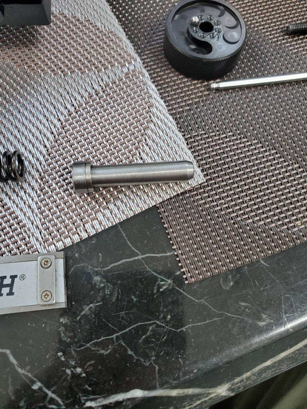

I suppose I should take this apart and look at the hammer? Can anyone confirm that the .30 cal Mavs should come with the 13g hammer from the factory? This has always ben my assumption. I thought the 11g was for 22/25.
Please advise!
Ok, so I have a 56mm hammer spring and a 12g hammer. It looks like an 11g hammer with a little weight ring added onto it, but it weighs 12g total.
My hammer tensioner is the full 6mm out. At like 135 bar I get 935fps with the 44.8gr pellets. Any more pressure than that and it's a decrease in velocity.
Sounds like I need the 13g hammer to pop that valve open at 150 and get more power.
I have a 13g hammer in my .22 Sniper. Should I just swap them? Can I still get 55 ft/lbs with the .22 Sniper with a 12g hammer? Or should I just buy the Huma kit for maximum tinkering?

Well.... against my better judgement I swapped hammer weights (12g from the VP .30 to the Sniper .22 and 13.25g from the .22 to the .30. I did this because I figured the order form Huma would take weeks to get here. I ordered over the weekend and apparently it will be here tomorrow (Wednesday)....
Then when I get the Huma kit I'll toss the even heavier 14.5g hammer into the VP .30. If the 12g works out for the .22 then so be it, otherwise it will get back its 13.25g hammer weight.
