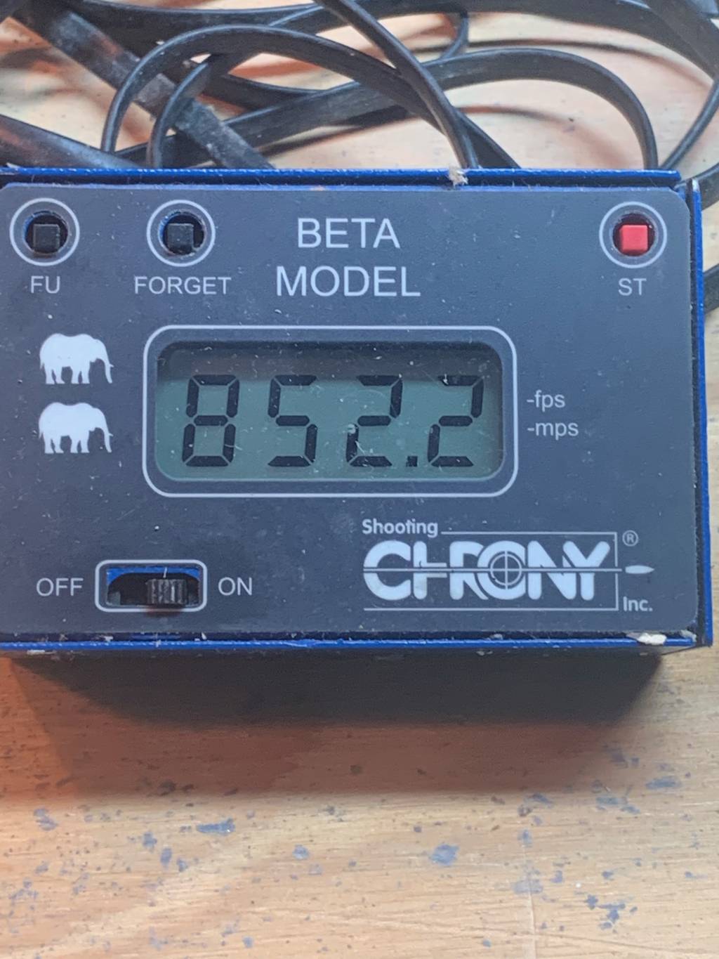

I have a FX Maverick .22 500mm. My goal was to shoot the 25grain pellets around 900FPS. Where it was tuned it was around 800. So i put in the 13g hammer weight. I now have it at the speed I wanted. Final reg at about 135 bar. Micro HS about 1 turn form minimum. There isn't much deviation on the different power wheel settings. Would like more to shoot different weight pellets if I want. The question is, will more or less reg pressure get more deviation on the power wheel settings with the 13g hammer weight.
