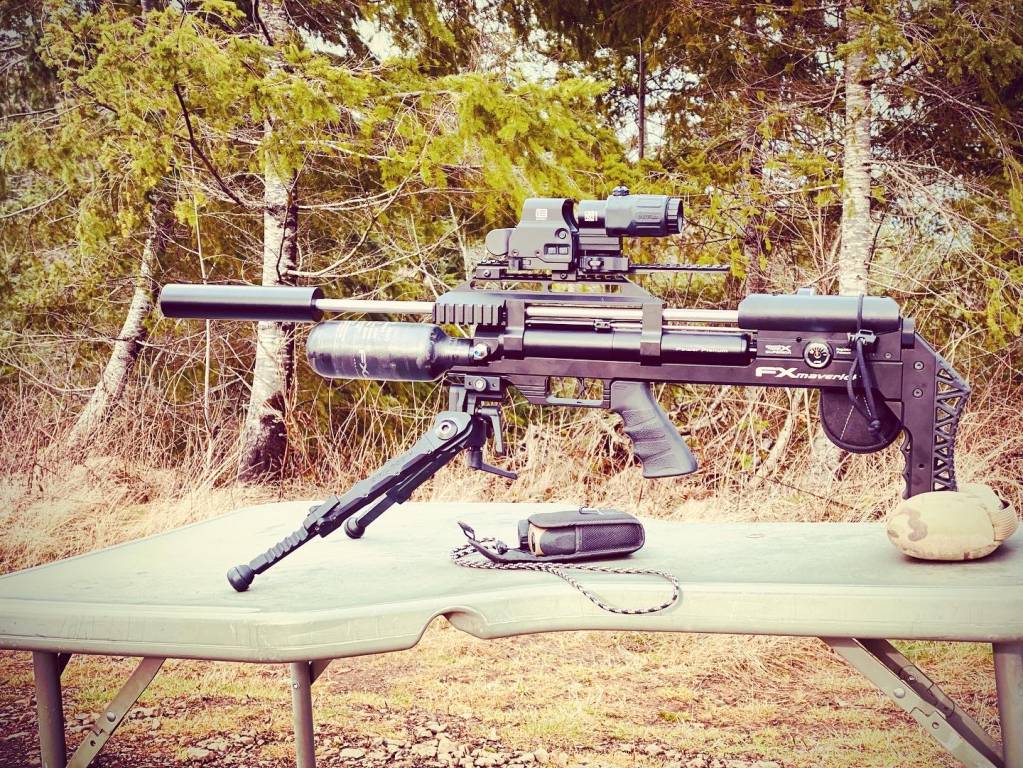

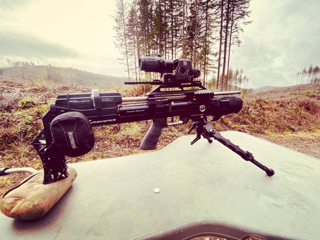

Here's my FX Maverick Compact .30 as it sits currently..

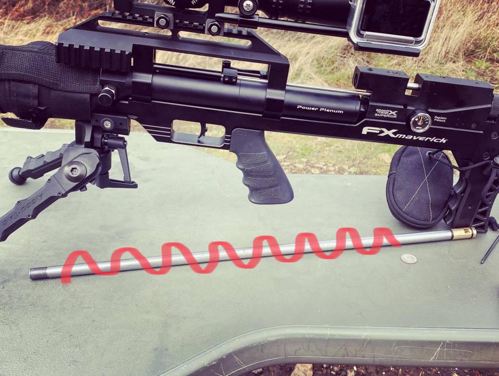

I'm running a 502mm TJ barrel (1:26" twist), chambered for smaller slugs and diabolo pellets. I was going to cut o-ring grooves to keep it a solid one-piece design, but I decided to cut the M12 x 1mm pitch with my lathe to run the brass Huma high-flow TP. Zero harmonic issues, CrMoly steel barrel is very stiff, so I don't see needing a shrouded protector for this length. Running a custom LDC that Neil Clague made for me (I highly recommend him for custom work!).
I also made a bottle cover from a repurposed neoprene fire extinguisher holder (with nylon reinforced Velcro straps). It works very well, the bottle gets ice cold this time of year, so it makes it less painful to handle (and puts my mind at ease in the field knowing that it has some form of protection).

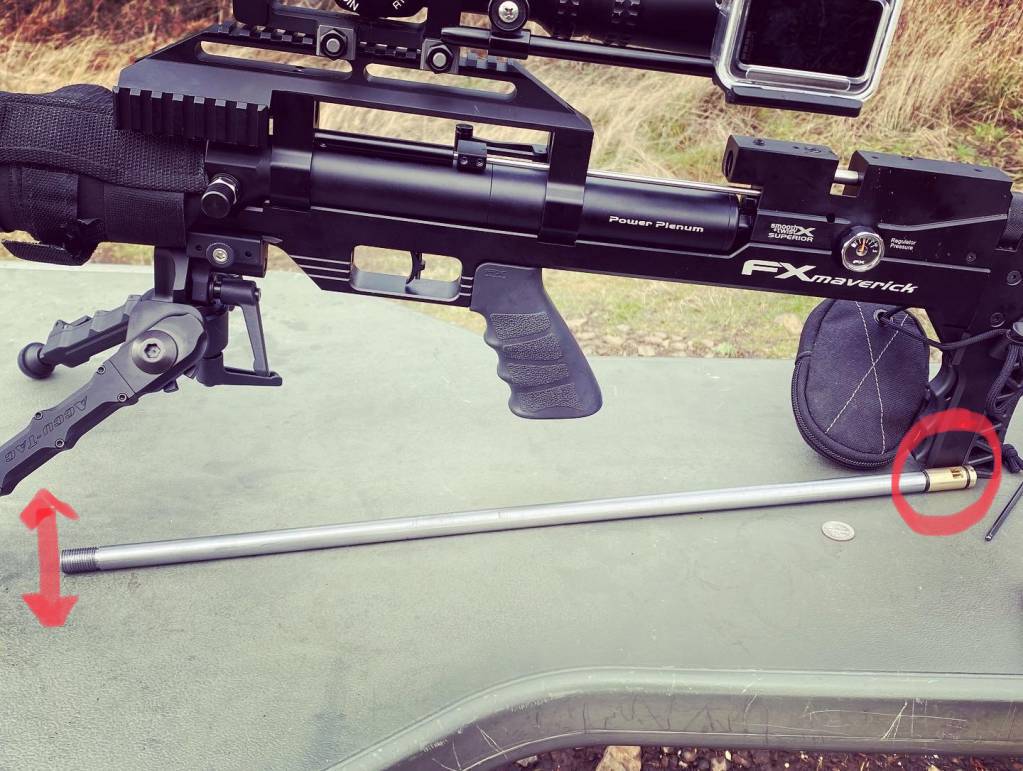

Anyways, my initial feedback and feelings for this Maverick.. first, I got off to a bumpy start with this thing. There was ridiculous latency getting my order shipped, then I found the hard way that there were interference issues due to tolerance problems with the bipod rail + CF bottle (and defaced my bottle the first time that I went to remove it). Now, if I didn't like this rifle - I would be seriously pissed, but so far this thing has impressed me enough to merit my personal time!

1. Size & weight - very manageable for me as a hunter. I have no interest in long, bulky, heavy guns. They don't appeal to me at all. I hunt in steep, slippery, unforgiving terrain, and carrying around a long cinder block in the mountains is not an enjoyable experience. The Maverick Compact is all good in this regard.

1. Tolerances are off - the rail / bottle thing is a problem that FX will need to resolve (they're already on top of this)
