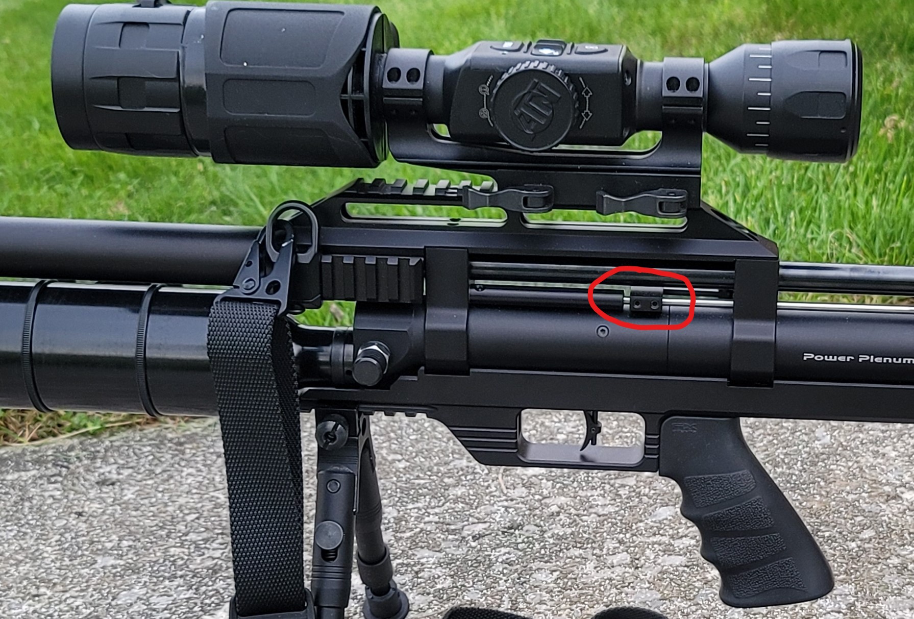

I had an issue with my Maverick after about 500 round. The cocking lever attachment that moves the probe in and out along a steel rod on the left side of the gun got loose. This caused the probe not to seat completely, which caused my reduced velocity.
the position of this screw is quite picky. If you move it up along the rod too much, the valve pin will seat then back out as you continue to close the cocking lever. I ended up placing it exactly where it needs to be by aligning it up with marks on the rod from the factory, and then I used loctite to keep them from backing out again.

The issue was exactly what N2 Shooter had shown in his post above. The linkage between the cocking lever and the operating rod.
For some reason I just could not get it through my fat head that when it came loose and I reset it that I had done it wrong. Just knew it was some serious mechanical issue.
That adjustment or the placement of the linkage is critical to the operation of the Maverick and I assume the Wildcat. There are a couple videos I have seen on YT that tell how to make the adjustment and get it right.
The fix is once you have it where it is supposed to be, remove one grub screw and use a small amount of blue Locktite on it. Then do the second one.
That Maverick Sniper went down the road because I assumed a flaw in the design and what I concluded was a weak system. I no longer believe that to be true. I have a Maverick 25 Compact that I refuse to part company with. I administered the fix to the linkage and it has never given me a problem since and the gun has operated flawlessly since the day I bought it.
I don’t believe the design is flawed but I do think FX would be well served to put some thread locking compound on those two grub screws. This is a known issue and fairly common with the Maverick. It is NOT a reason to avoid the Maverick.
I would suggest anyone who has a Maverick or is buying one to Locktite the two grub screws in the linkage before it comes loose. You will save yourself a lot of frustration that is easily avoided.
