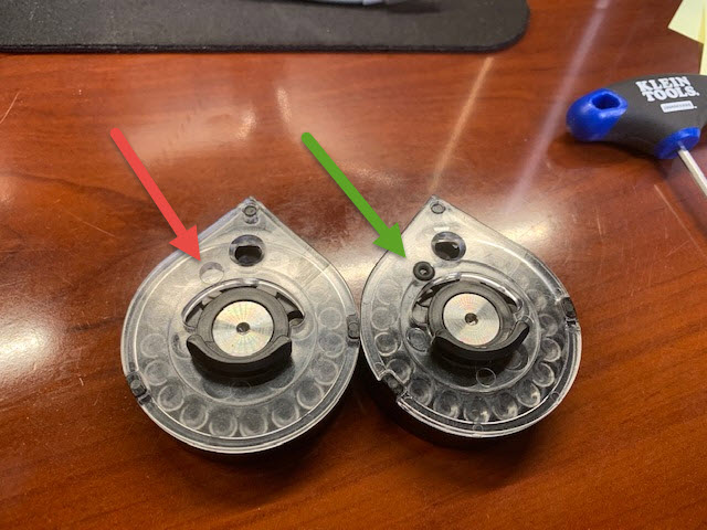

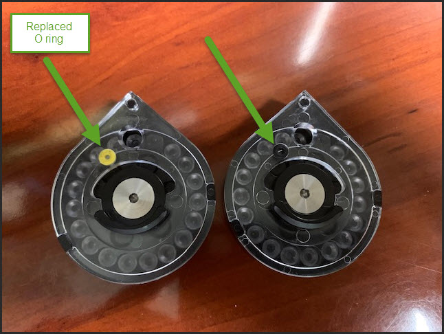

I did have an issue with one of my 6 magazines (interchangeable on by my FX Wildcat MIII and FX Maverick) that would fall out of the breech when I cocked the gun. I added 2 layers of electrical tape to the back of the magazine to make it snug and not fall out. That worked for a while. However, on closer inspection, it was an o-ring that fell out of the cover of the magazine (yes ... the o=rings are used as friction as opposed to controlling pressure leaks in this case). Fortunately, I had a very small o-ring ( on amazon these look correct: uxcell Fluorine Rubber O Rings, 6mm OD, 2.2mm Inner Diameter, 1.9mm Width, Seal Gasket Black 50Pcs) that I could super glue into the empty o-ring "hole" and it works great. You might want to order some very small o-rings to keep on hand. Just ordered some and if they fit, I'll post the size. See photos.

Please keep us posted on the size of that o'ring. I like the yellow color. At least you can see pretty easily if it is present or fell out. The first time mine fell out on my work bench (luckily) I had no idea where it came from. Seems like a poor design to me, having a black o'ring on a black plastic case just sitting there that can be knocked out and lost quite easily. Other magazines of the same brand do not have this design.
I note others are reporting the same issue i had regarding the O Ring falling out of the magazine face that creates friction to hold the magazine in the rifle. I have 10 Side Shot Magazines that are shared between my three 22 gauge Fx Rifles (Maverick, Crown and Wildcat). It is a benefit that the same magazine works in all 3. However at least 3 of the 9 magazines have lost their O rings that required me to find replacements. I ordered multiple very small O Ring sizes and finding unsatisfactory results (they must fit in the hole and be wide enough to stick out above the plastic cover to create friction).... Finally I ordered the white / clear (uxcell Silicone O-Ring, 5mm OD, 1mm ID, 2mm Width, VMQ Seal Rings Gasket, White, Pack of 20) and they fit the best. A small amount of super glue in the hole or applied to the back of the O ring hold them nicely in place. I've used the magazines with the new O rings and they have remained in place x 4 months.
