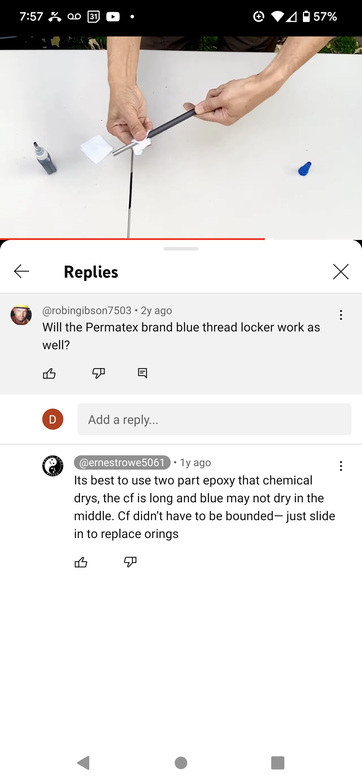

If you are going to epoxy it, make sure it's REALLY THIN epoxy. Some have use loctite, make sure it's SLOW setting.
Lol also from same video....
