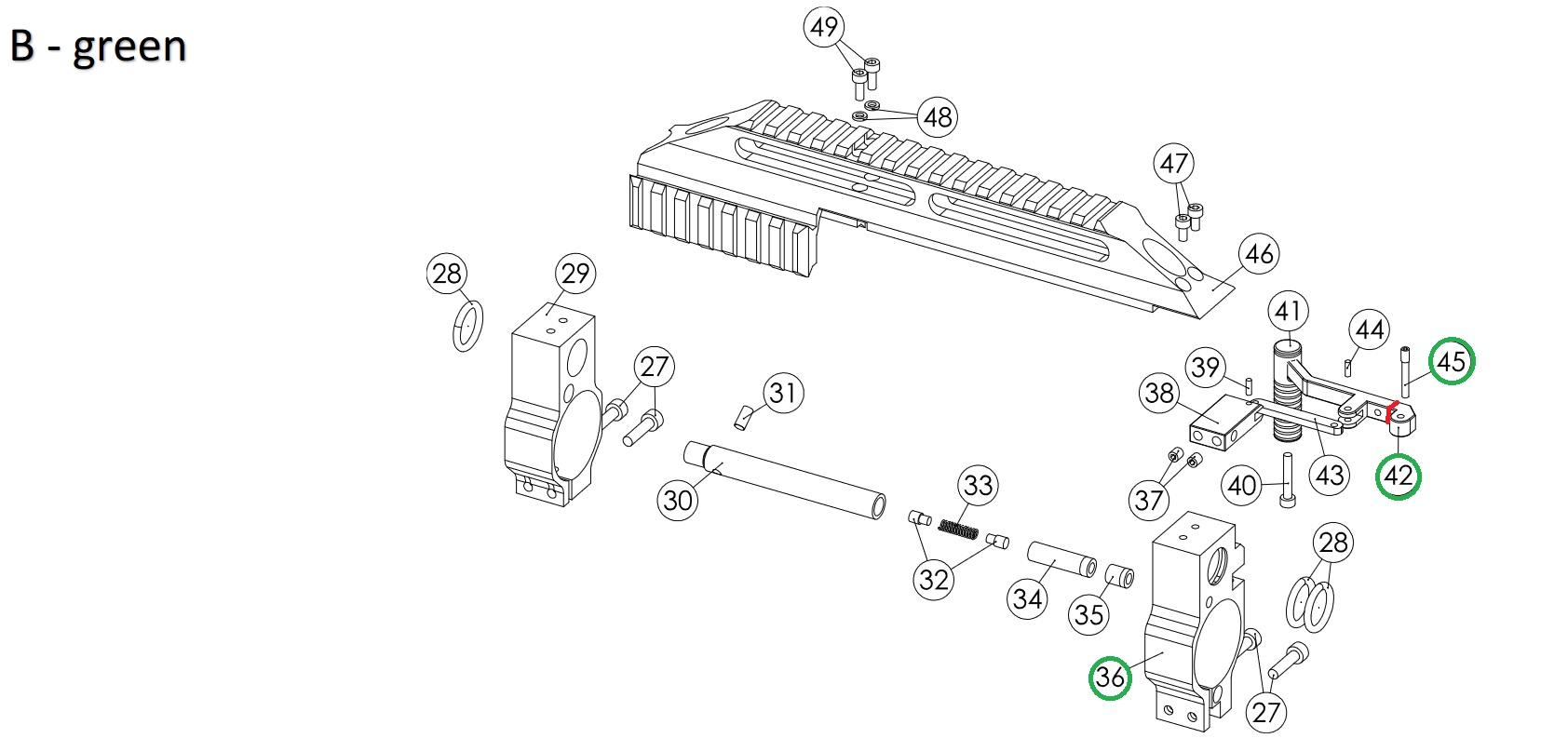

So the season are upon us, but my maverick have been at the dealer since November to get the cocking handle that suddenly broke repaired under warranty.
But while the dealer say he have gotten the handle, the m3 screw it hinge on ( m3 special part # 45 ) seem to be giving him grief ( getting it out )
Now i have not wrenched much on my maverick the biggest job was probably changing to the dual transfer port, which also took some force + heat as it was secured with what i assume are the strongest locktite money can buy, at least IMO entirely unnecessary.
I was heating and wrenching way harder on it than i liked to, to get it iut, and the end result also was the original transfer port in brass was molested beyond reuse.
So the dealer say the rear barrel support ( part # 36 ) also need to be replaced as he can not get the damn screw out, i assume he have either stripped the head on the small m3 screw, and it might well have gotten far too much / strong locktite too, and so either can not be loosned at all, or it have come loose but can not be screwed entirely out due to locktite in threads above it ( which i assume could be cleared by cleaning the thread with a m3 thread tool )
Anyway i am now looking to complete this myself, so i will need ( if dealer have not yet gotten these parts ) a new cocking handle ( # 42 ) a new rear barrel support ( # 36 ) and finally the m3 special screw ( # 45 )
I have circled the 3 parts i need on the drawing, and also drawn ( in red ) where the cocking handle for no reason snapped in November ( i know not to treat precession instruments like a rifle with a sledge hammer, the only times i have been " rough " on the handle are the few times i have double loaded )

I am thinking IF he have stripped the Hex in that m3 " special " screw, i think it is seated in a pretty deep hole in the barrel support, so will probably be very hard to drill and somehow get the part out.

So if its on there real good, well for sure i will need a new barrel support too, and the m3 special screw / pin

Yep, if the thing is still under warranty, they'll fix it. I'd love to know the 'dealer', to my knowledge that screw isn't loctite'd in. I can tell you that the only think keeping that handle from wobbling is that little screw, it's a slip fit into the handle, there is a significant gap between Part 36 and the handle. If it had been me I'd have designed it a bit differently, most definitely with a larger screw for more bearing surface, and perhaps some shims.
