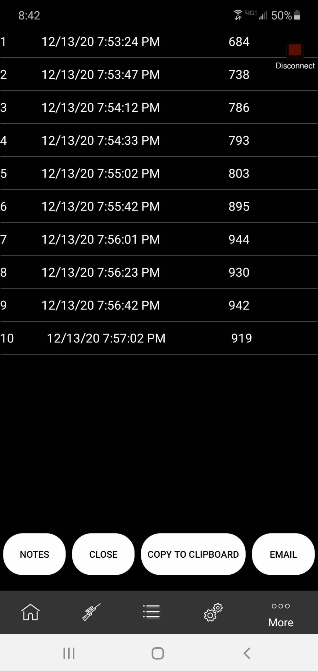

Also, out of the box, I would check to see where the high pressure is set at. I got my Maverick from UtahAir, it came with QC card that said my velocity was set 900fps. The gun chronograph at 845fps, my gage showed a hair above 100bar, when I opened up the reg to see what the high pressure reading was, it was at 200 bar. So much for the 20-30 spread! I lowered the hp to 150bar and the final regulator to 120bar, now I'm getting 950fps...
Cloudrider, I can appreciate your understanding of regulators and valves after that many years in the PB industry. Notes taken. The Huma in my Impact MKI/MKII was a little fussier than I liked having a creep of between 10-18bar. If I only filled to 200-210 it was well within a needle. My Maverick from Pyramyd Air had no QC and no velocity check. The gun was unshootable OOtB as the trigger blade was set near the bottom of the post and after one pull jammed on the trigger guard. Had to pull out the .050 allen to adjust it up to clear and make it right for my style. Second reg on my gauge was set to 110-115 bar. I walked through the Ernest and 68 whiskey tune videos and then checked my first reg and it was set to 145 bar, in specs of the 20-35 bar. My first 10 were JSB 18.13 on PW #7, they were much faster than I expected @1025.
This is shot #30-40 with the JSB KO and a proven tune for them out of my Maverick as I experienced just before the failure. Thanks for your insights.
