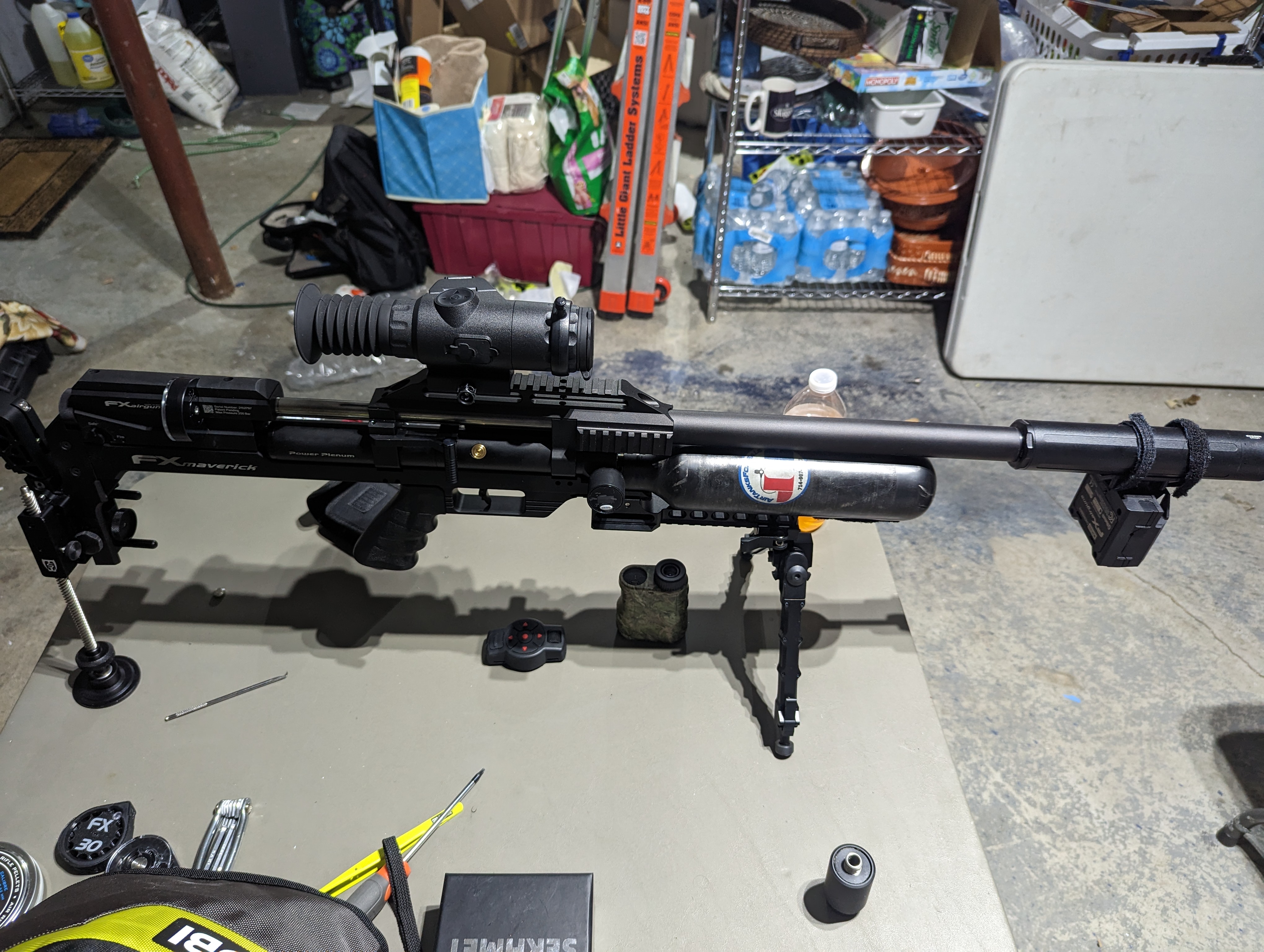

This is the Maverick with 600 mm barrel & wraith mini. See attached setup.
I took a while to Chrono last night and have fX pellets shooting ~900 fps. Finally got out today and tested out my new setup and tune from 35 yards. Think I found the sweet spot.
Regs set at 155 and 125 with hammer at 5.97 mm and powerwheel at 7.

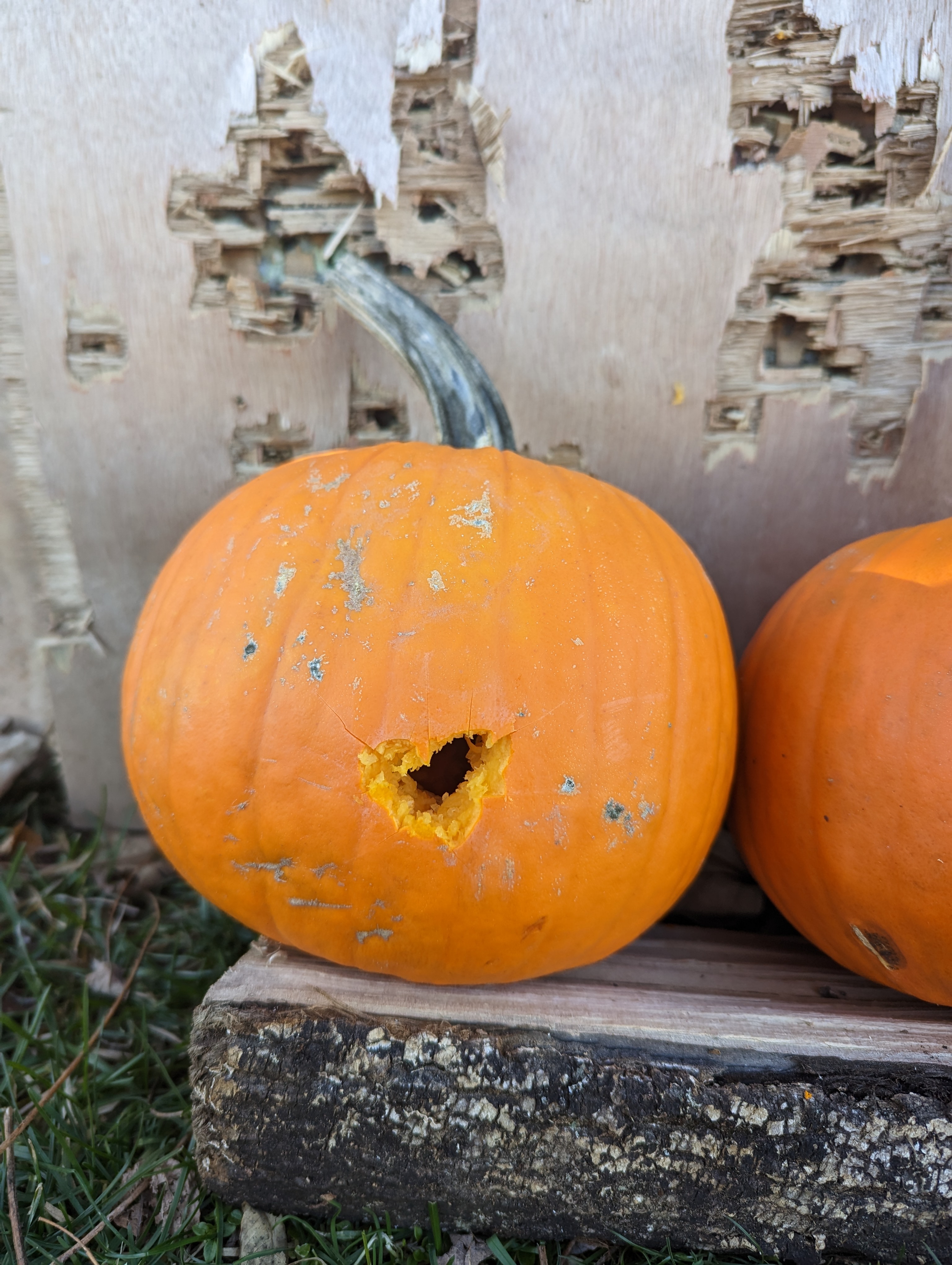

10 shots through same whole at 35 yards through pumpkin. 2nd...8 shots on target with 1 flyer, warming up... Last one is 5 shot group from same. Lots of work getting here but happy. The only issue been having is getting the mags to set correctly. It is very picky and will not forward pellet unless it's perfectly inserted. Is there a work around for this on the maverick? I have a 3 stock mags and 2 from Orion the iguana hunter. I like his mag design more and very good when inserted correctly.
