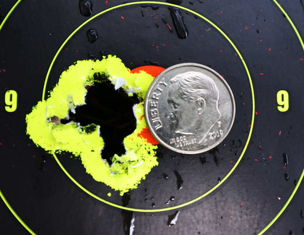

A good while ago, I bought a Kral Arms Puncher Jumbo, and it groups fantastic, but I had a sentinel scope on there, and the POI kept changing. The turrets on that scope were already a bit too sketchy for me, sometimes taking 3-4 shots to get "settled in" after an adjustment, so I just bought an Aztec Emerald 5.5-25 sfp. Fantastic scope, absolutely love it. It was easy to zero, and the tracking is phenomenal. Well, after zeroing it at 50 yards last night, I brought the gun inside, refilled it, and let it sit overnight. This morning, when I took it out at 50 yards again, same shooting position, target distance, no wind in either scenario... There was an 8.75 MOA verticle change. The power is the same, the distance, position, all that is the same... It just dropped by 8.8 MOA. I zeroed it again and it is grouping perfectly. Little bigger than dime-sized groups at 50 yards, I'll attach a photo. My first thought was the scope rings must be loose (fx no limit scope rings), but all the screws on it for attaching to scope, gun, and verticle adjustment are snug. I also thought maybe the silencer or shroud was loose maybe, but they seem very snug as well. Is there anything I may be missing here? This isn't the first time this has happened. It never happens while using the gun. It always happens overnight, though not all the time. The gun is stored on the ground, standing on the bipod. It is out of the way, and doesn't get bumped or anything while not in use.
