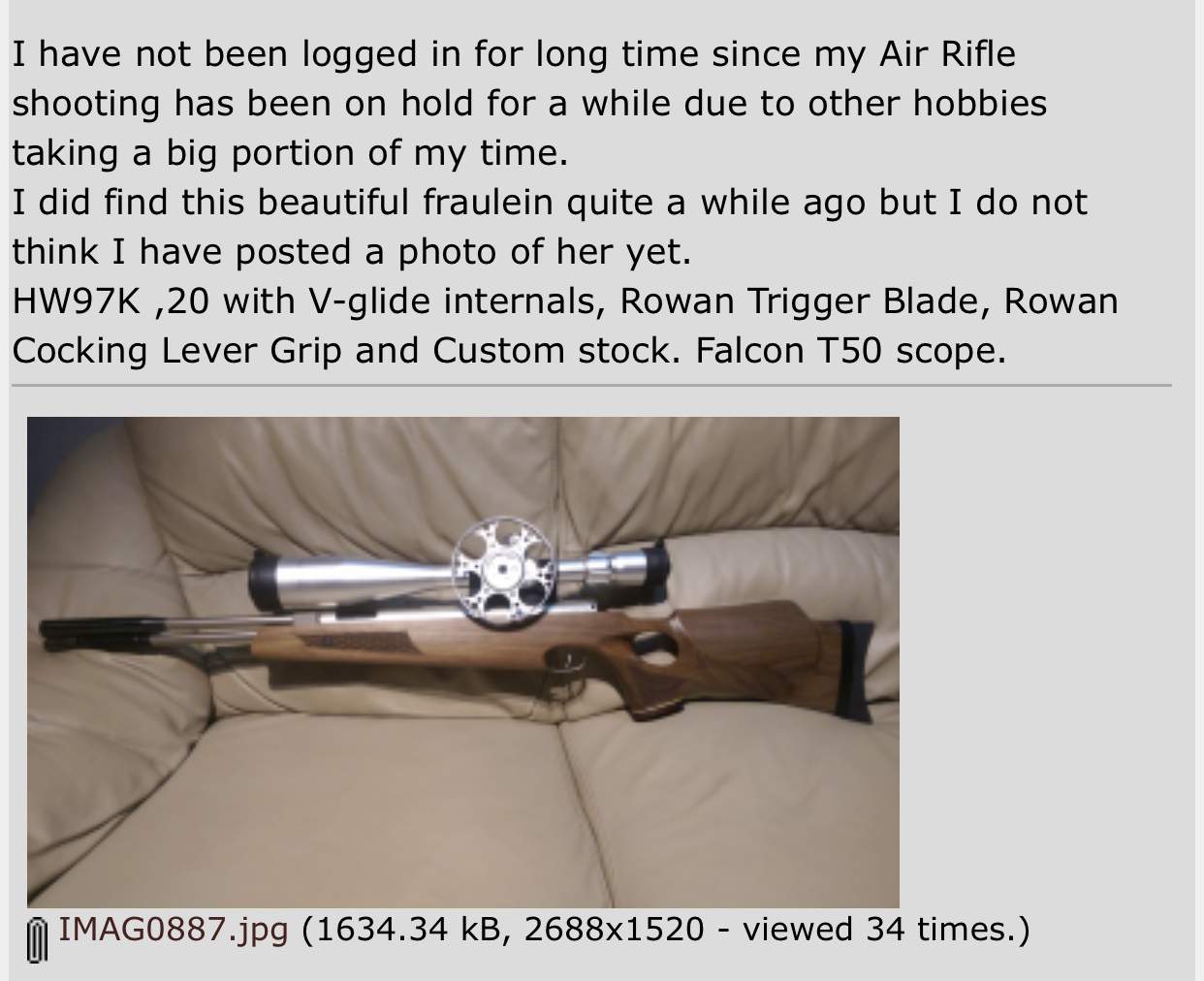

Ah, on a springer.
Not mine, but she sure is a looker (y)
