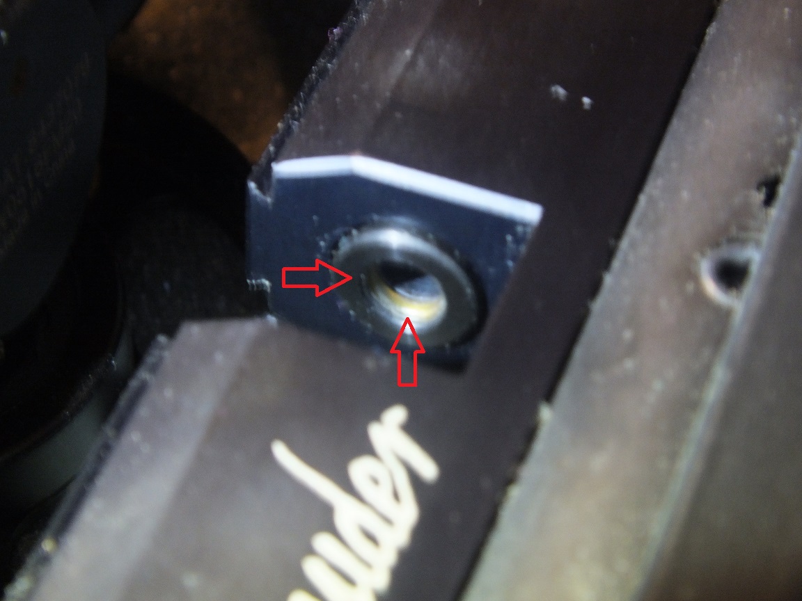

Similar to what others have said, but with maybe a bit more info. Not all bore cleaners are O-Ring friendly, and of course with a patch getting stuck, it may have added to the problem. There is an O-Ring which fits in a groove on the INSIDE of your bore, near the breech (magazine end), which seals the contact between the Bolt and the inside of the Bore. If this O-Ring is damaged or missing, it will act as you have described. It is difficult to inspect on an assembled Marauder, but you might be able to get a peek at it. I would check that first.
Reactions: sonny and Rosco
Here is a picture of the seal to check...
It just pops in, but it is tedious to do when assembled due to limited working space. Personally, I would put it in without major disassembly, unless I was wanting to do additional things to the Marauder. If you call Benjamin/Crossman and tell them you need a breech O-Ring for an XX caliber Marauder, they can get you the right part.

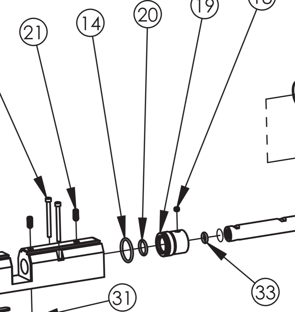

I believe you are actually looking for part number 33. The tube on the far right is your actual barrel. The other two O-Rings are associated with the sleeve which the baffle tube screws down on.
​Your best bet is to call their support, and tell them you need the O-Ring which is INSIDE of the bore at the breech end of the barrel. Tell them it is the O-Ring which seals the bolt inside of the bore. Be sure to give them the caliber of your weapon. By the way, what is the caliber of your Marauder?

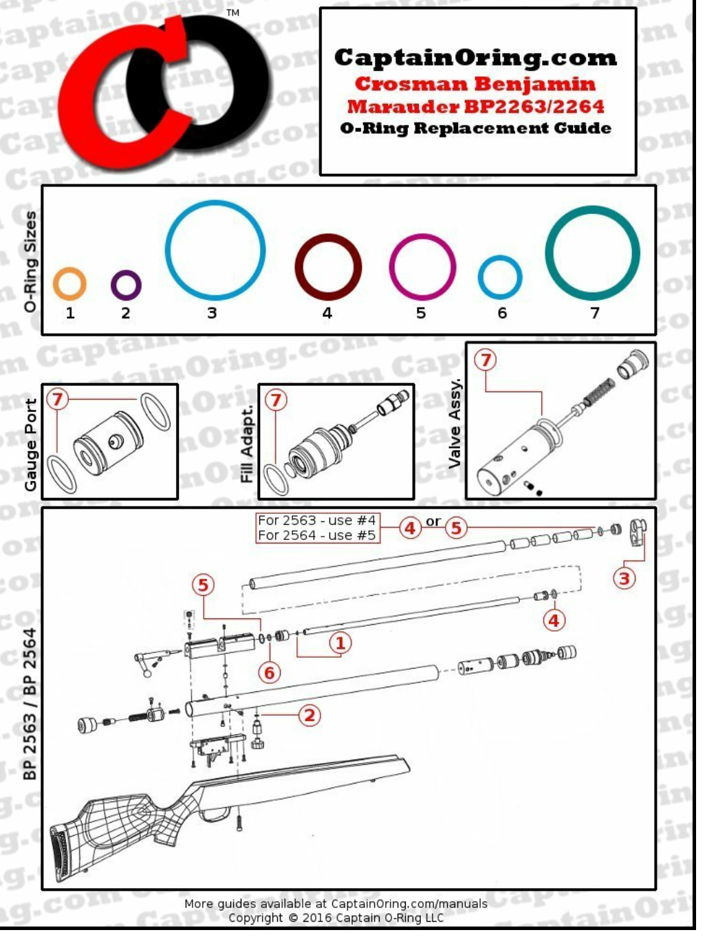

I chuckle when I see that diagram. So few of those parts are still in my Marauder. Yes, number 1 in that specific diagram is your missing breech O-Ring. I tend to prefer either factory O-Rings, or very highly reputed upgrade O-Rings. If you choose to fully take apart your marauder, pay very close attention to protecting the O-Ring on the Gauge block, as there is a very sharp burr from the factory where the gauge screws through, it tends to slice the rear O-Ring on the gauge block during removal and installation. Many people deburr that hole when they have it apart to avoid harm to future O-Rings. Also, the O-Ring at the port to the barrel (number 2) is easy to lose as well; watch it like a hawk. It may remain on the port, or be stuck to the barrel during disassembly. And finally, fully degas your air tube before any disassembly. Usually, firing 60 shots is sufficient to achieve this. I fire until I hear no sound, other than the click of the hammer.
