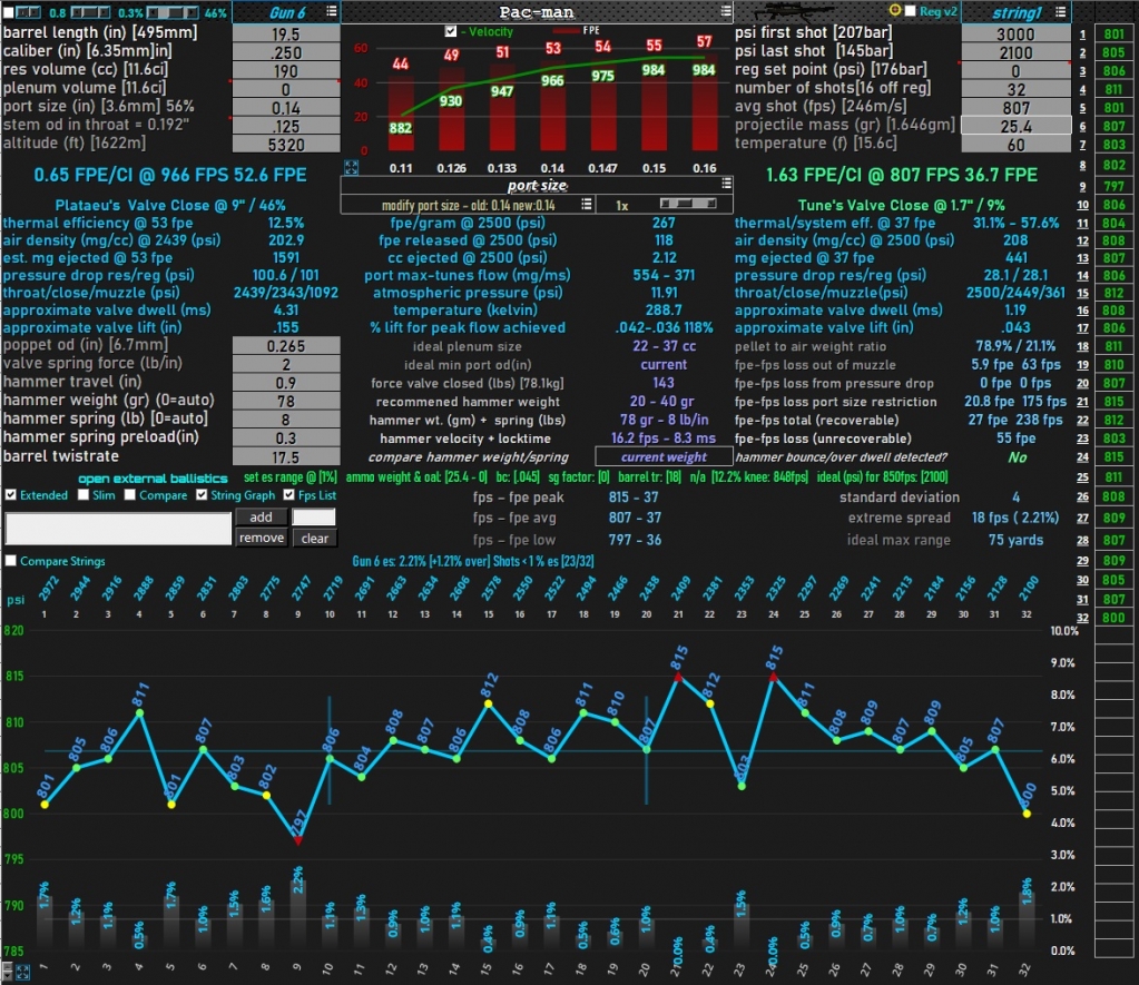

I am learning the ropes of my stock Marauder .25cal. I did two, thirty-two shot strings, which resulted in the following. My questions are:
Pellet: JSB Exact King .25cal, 25.4g
PSI: 3000 - 2100
PSI Per Shot: 25psi
Max. FPS: 815
Shot String 1: 25 shots within 2% of max FPS, 32 shots within 4% of max FPS.
Shot String 2: 31 shots within 2% of max FPS, 32 shots within 4% of max FPS.
- How is this performance for a stock Marauder? It seems consistent, however I am still learning.
- Am I right in my thinking about shot string percentage according to max FPS?
- What PSI should I be shooting between? How do I figure this out? Do I fill the rifle to 3000psi then shoot 9 shots and check my PSI, which would then be my starting point? Do the same with end point?
- Any other points or guidance welcome.
