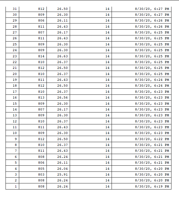

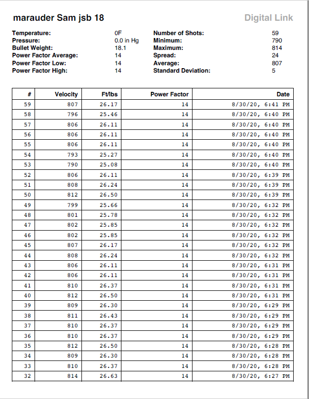

I adjusted the hammer spring on my Marauder Semiautomatic in order to shoot the JSB 18. I turned the power up until my velocity stopped increasing and then backed up slightly. The rifle still gets a ton of shots before falling off the reg.
I tested accuracy out to 22 meters with the JSB 18. The first 5 shot group is in one hole. Then shot 10 pretty very tight as well. This gun is so much fun to shoot! And it works perfectly, cycling without issue with diablo pellets over 250-300 shots [the fx hybrid didnt cycle so well fyi]

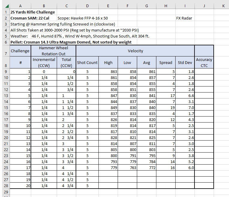

There has not been much update in this forum for 2 years so I thought I would share my experience and data with the Benjamin Semi-Automatic Marauder (SAM). I have multiple other high end air rifles but this is my only semi-automatic which has a unique fun factor so I have come back to it it to see what I can do with accuracy.
The Crosman 14.3 Ultramagnum Domed pellets have been touted as one of the best pellets for this rifle. I can confirm this from previous experienc and can also confirm that many other pellets such as the JSB 14.3 shoot poorly in this rifle (3" CTC at 25 yards). However, I have had good success with the H&N 18.21 Baracuda Hunter for accuracy at 25 yards but shoots at 775-800 with hammer spring fully in (max) and no change in factory regulator. Note that the H&N pellet, the pellet speeds immediately drops if I moved the hammer spring out counter clockwise to reduce the hammer spring tension.
Overall, I have had variable accuracy ... so I thought I would share my chart of velocities and resulting target accuracy as I used the Crosman 14.3 and went from max hammerspring to 4 full turns out moving 1/4 turn at a time. (You can find the max hammerspring by turning the hammerspring with a 1/4 " allen wrench clockwise until you feel a "click" in which case further turning does not advance the hammerspring (and per the Crosman manual does not damage the hammerspring). Note that the regulator is internal and I have not tried to adjust that component,.. I believe that most owners of this rifle will only adjust the hammerspring.
On the target results, please focus the grouping, To stay on each target, I did adjust the Point of impact with the scope between velocities but not within a velocity grouping of 5 shots. Challenge #4 and #14 seemed to be my best. Note that horizontal drifting could have been caused by some wind gusts but vertical should be true. I did shoot from a bench rest with a bipod in front and a sandbag in the back for stability.
Note that I did have a velocity increase on Challenge 20 as the magazine got stuck after challenge 19 and I had to degass the gun and regass the gun after clearing a jammed pellet and stuck magazine. That was the only issue I had in this test.
Hope this information is helpful to others...
