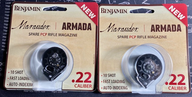

Well, I tried all the suggestions above except for drilling new holes in the mag and re-inserting the spring (too much trouble frankly). The bottom line is this, a combination of taping over the oval to try to re-create the hole in the SAM mags, plus loosening the clear cover screw does work - some of the time. Definitely more than using an unmodified mag, but definitely not 100%. I go from maybe 2-3 trouble free shots with the unmodified mags to 5-6 with the modifications above. Quite possibly adding the suggested spring modifications would get me up to 7-9 shots but its just not worth that much effort and time. The OEM mag that came with the gun cycles perfectly pretty much 100% of the time.

John, The packaging said NEW on it, but the magazines themselves are the original (old) style with the oval opening in the clear plastic cover. Ordering direct from Crosman.com, I thought I'd be getting the NEW style that is made to work with the Semi-Auto Marauder. I guess I was under the impression all the .22 magazines would be the same since the new SAM Mags are backward compatible. That was not the case. I now have 2 more .22 magazines, bring my total to between 10-12! I won't run out of magazines for my .22 Mrod, but was really hoping to have a couple spares for the SAM! Thanks for the response.
