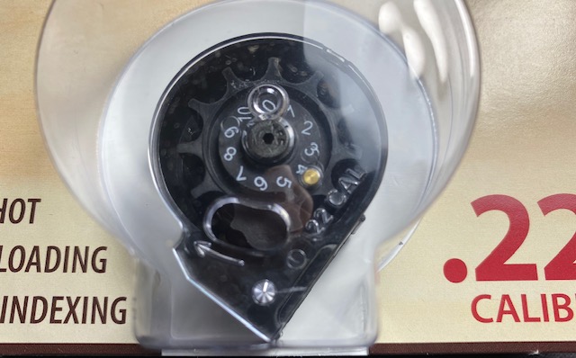

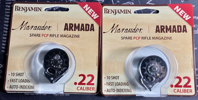

Hey John, I just received two .22 Marauder Magazines I ordered this past Sunday (Aug 30th) direct from Crosman when they came back in stock. The packaging is marked "NEW", but they contain the old style magazines with the larger oval opening in the clear cover. I was expecting a couple of the new style magazines that will work in the SAM. Is there going to be some sort of designation so we know we are ordering the correct magazines? I'm guessing these won't work with the SAM, so I'm not sure what I should do with them...
Thats just the original package and it was never updated to remove the new. The SAM mag will have its own sku and should be available next month.
