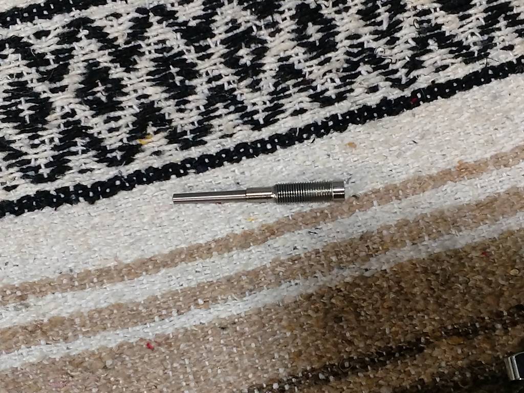

@FuzzyGrub I'll get you pictures of the valve and other components when I tear into it. I still need to figure out if it de-gasses the same as the standard Marauders and make or buy that tool.

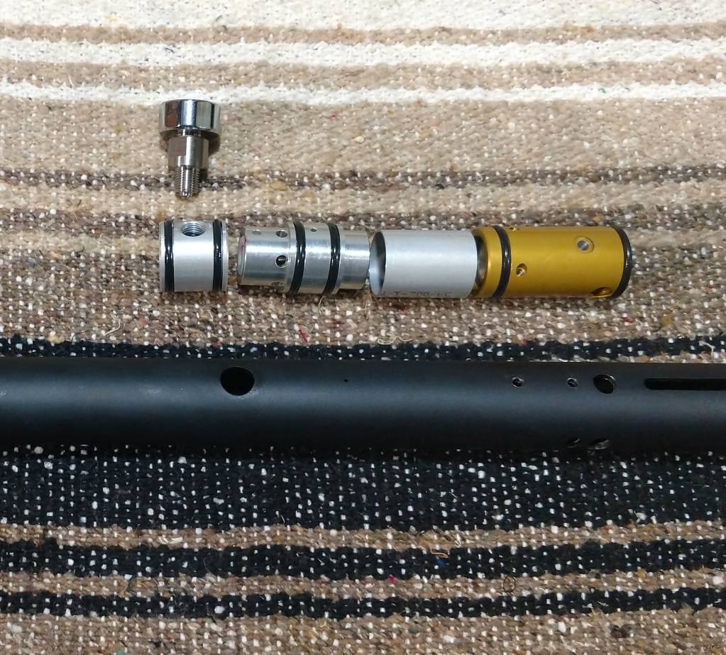

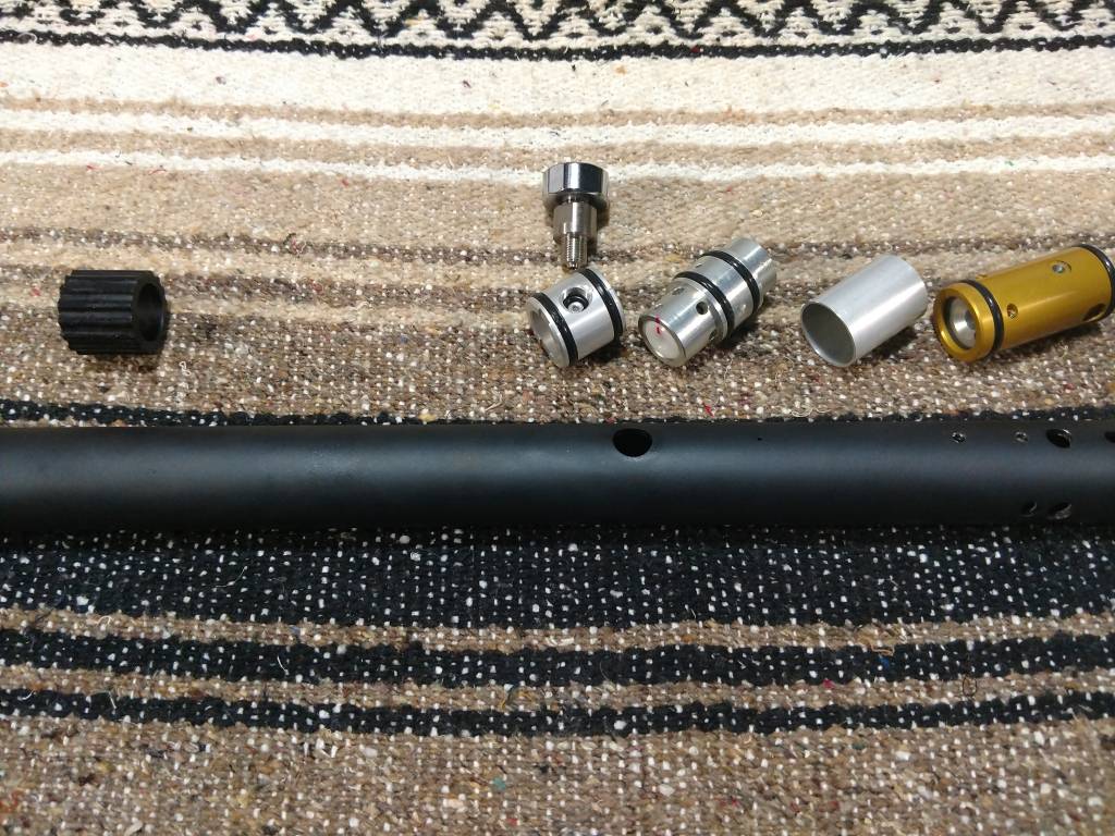

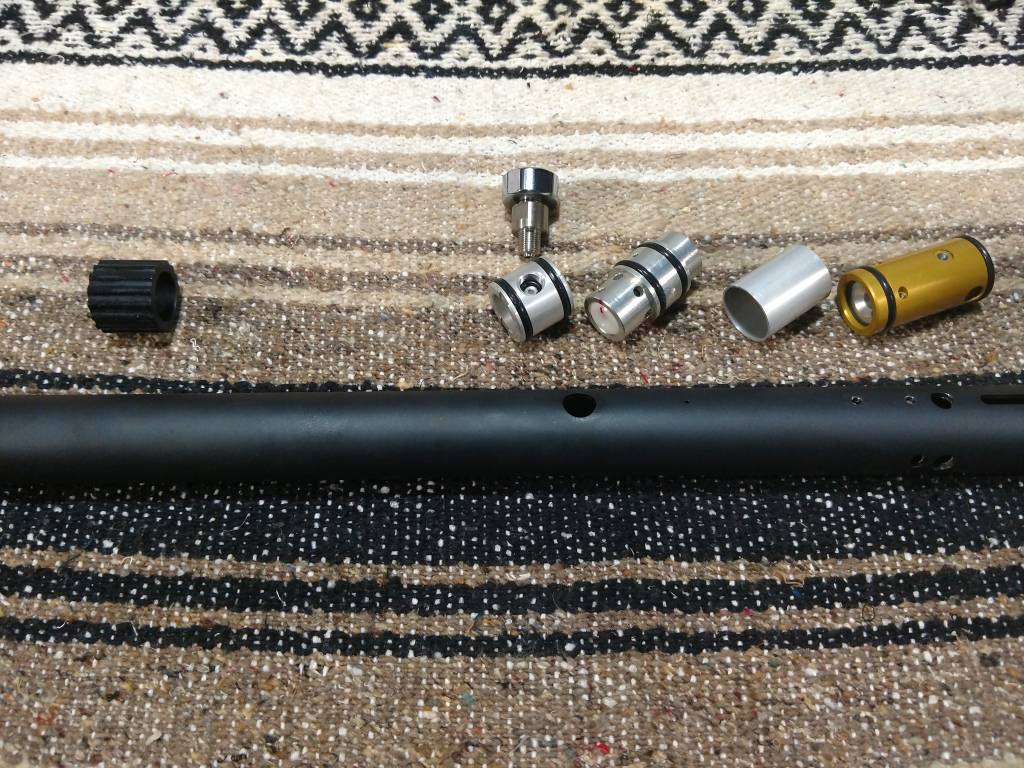

Here's a picture to check out of the SAM air tube internals... Complete with de-pinging rubber bushing, regulator, plenum spacer and valve assembly.

Any pictures or details of the valve disassembled? C clip style? etc

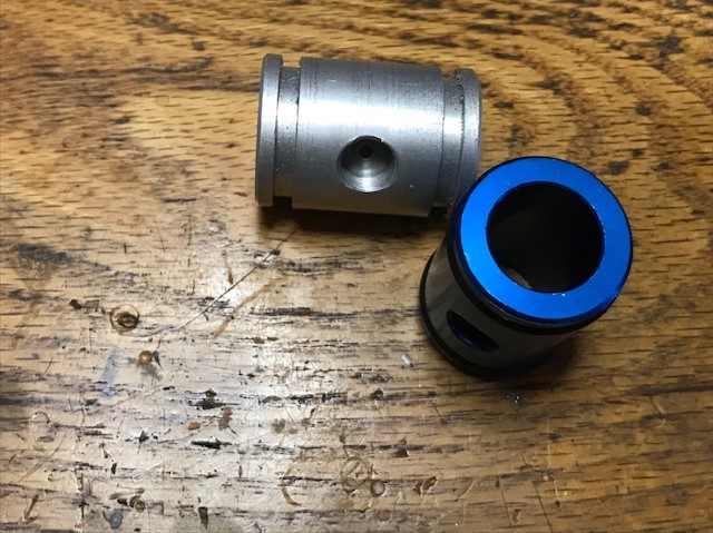

It does look like with the shorter valve that I would need to cut a plenum spacer for using a Huma reg w/gauge port, in a "standard" Mrod air tube.
Or, like what I've done in the Fortitude, create a bridge to get past the vent hole. The standard gauge block w/plug, and plenum spacer, and Huma should work.
Bothe would give a larger plenum and be able to drop reg point some.

On the valve body... It is a C-clip that holds the cap in place. Inside is a spring and poppet valve only. The two holes furthest left are threaded holes where the action/receiver block screws come down into the valve. The hole low and right, 1 of 3 around the body, lock the valve body in place within the tube.
To make more plenum space with stock components you would have to strategically machine metal off of the valve body and regulator, as well as cross-drill holes in the plenum spacer. But even then, because of how everything is located in there, very little room is left for gaining the extra space. If you can get more space with using the Huma regulator please let us know how you go about it.

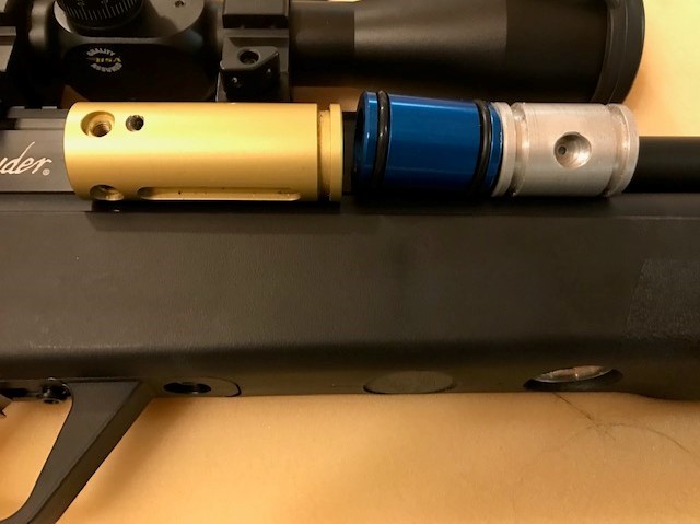

You wouldn't have to use a Huma, but using the OEM reg would require drilling a new vent hole. You would use the oem gauge block and the oem reg would be upstream of it.
I don't seem to have a Mrod Huma reg with gauge port hole not installed in a gun. If I had one out, I'd post for better clarity.
It would go: VALVE => SPACER => GAUGE BLOCK BRIDGE => HUMA
Note1: Spacer cut to length that would allow Huma gauge to align with air tube gauge hole.
Note2: Gauge block bridge would be a modified for plenum volume, oem gauge block or Hill with a BSPP plug that is "below deck".
