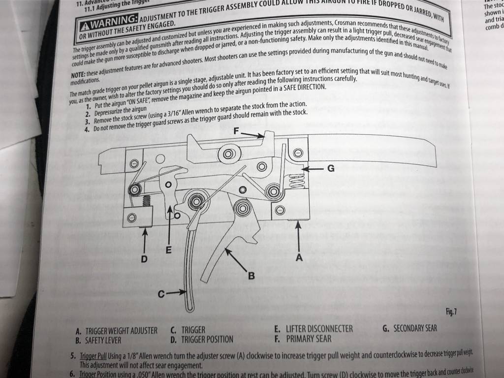

I haven't seen this rifle's manual online, so in case anyone was curious
goodoldbvc Member Nov 4, 2018 303 5 Southeast PA, United States Aug 26, 2020 Add bookmark #1 Aug 26, 2020 Add bookmark #1 I haven't seen this rifle's manual online, so in case anyone was curious
Motorhead Member Nov 1, 2018 7,532 1 10,805 California, United States Aug 26, 2020 Add bookmark #2 Aug 26, 2020 Add bookmark #2 See they still are utilizing the aka: "lawyer" spring. Architecture otherwise appears very similar in many aspects to the original trigger. Upvote 0
ChRiSiS Member May 6, 2020 1,365 714 CT, United States Aug 27, 2020 Add bookmark #3 Aug 27, 2020 Add bookmark #3 See they still are utilizing the aka: "lawyer" spring. Architecture otherwise appears very similar in many aspects to the original trigger. Click to expand... I have to say it feels completely different than the original trigger! Upvote 0
