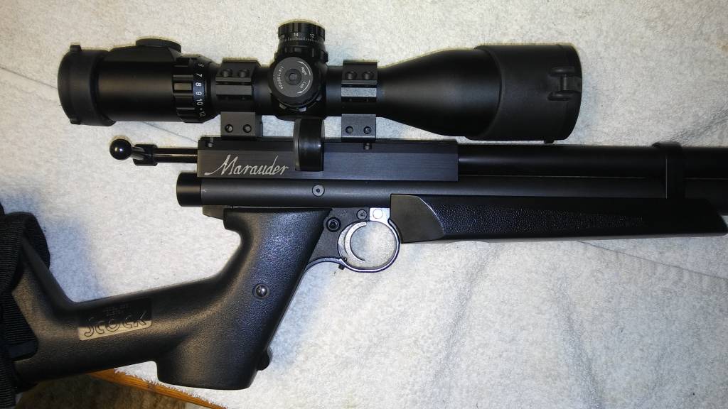

I have a 3x12-44 utg compact scope with the medium rings it came with. Tons of clearance for the objective, only about a 1/16" ccleaance on the magazine.

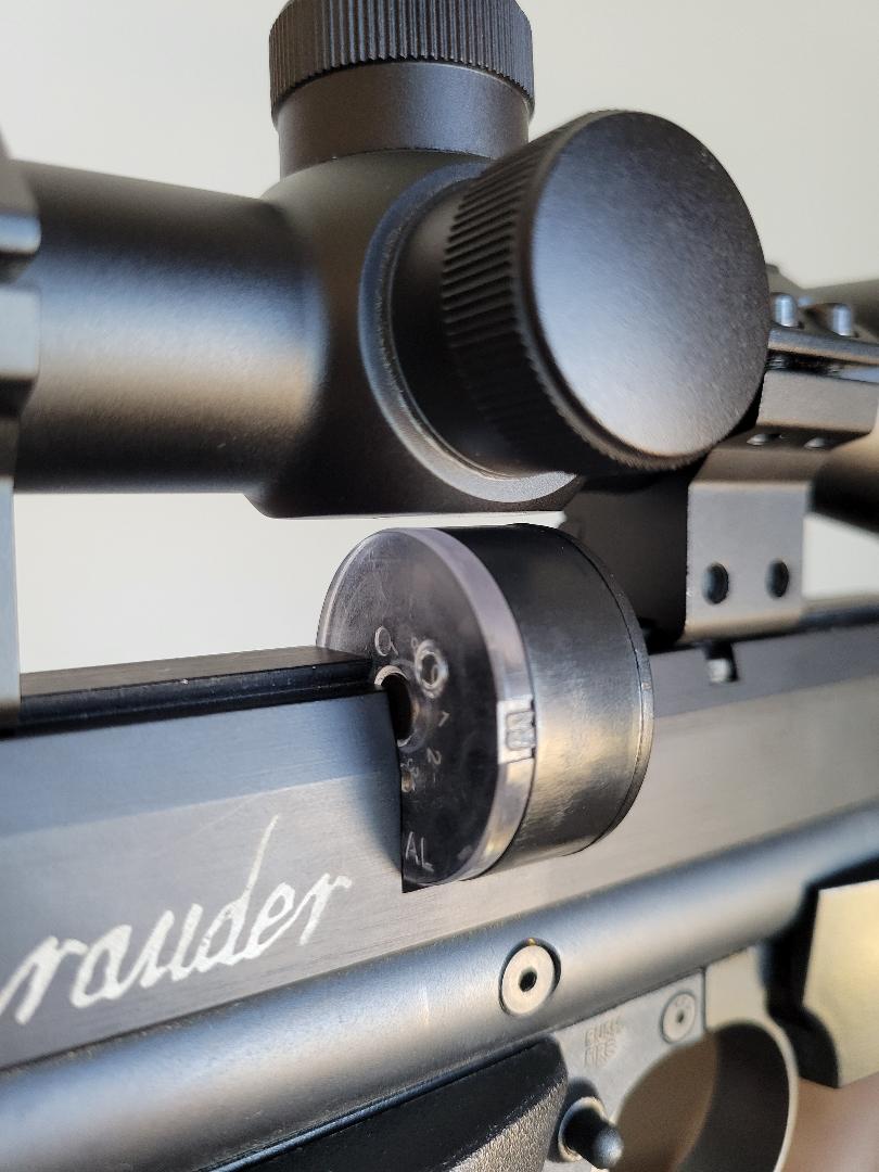

This is a Hawke Vantage 2-7x32. I mounted with the turret housing over the magazine as a worst case scenario. If the magazine fell under the tube there would be even more room, obviously.
I measure the saddle height of these rings at 15mm.
I have low rings from other companies that sit higher and medium rings that sit lower, so I would recommend going by saddle height.
If you're using the supplied plastic carbine stock you won't need to worry about the scope sitting too low with any ring that clears the magazine. These stocks sit very low.
The only way I could see needing taller rings is possibly with the folding stock option but I've never tried that.
Not sure if the Hawkes you're considering have bulkier turret housings or not.

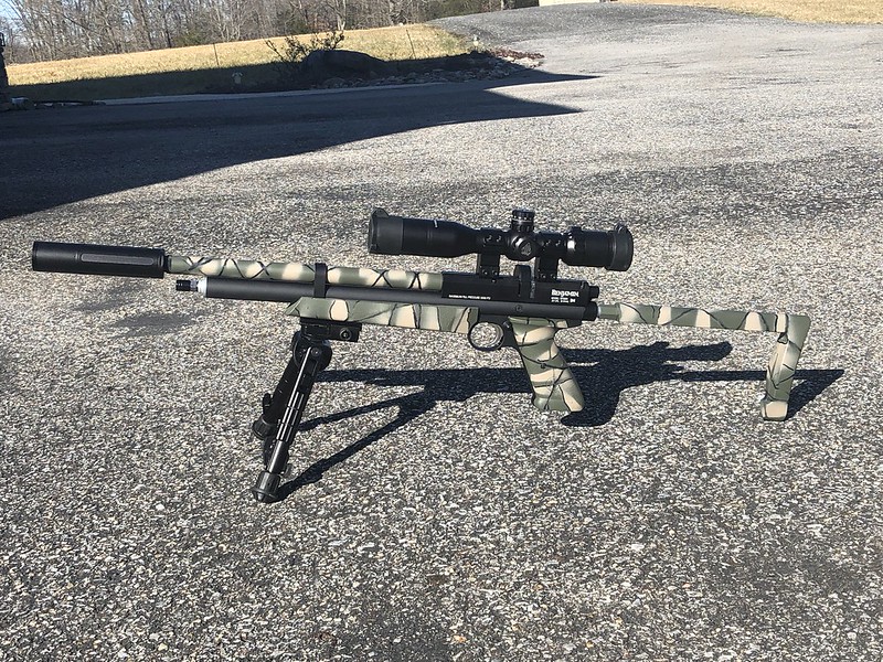

I don't have a Hawke mounted, but I used the high mounts when mounting my BB 3-12x32, and with high mounts, as you can see from the photo, there's a lot of room for the objective and magazine clearance. But, because the BB is such a compact scope, it's tough to get a good cheek weld with the standard skeleton stock and medium mounts without issues with the magazine. So, I modified my stock and now the cheek weld is perfect, but when I used medium mounts the scope turret housing didn't clear the magazine. I think the hawke is a better choice and you should be able to use medium mounts.
