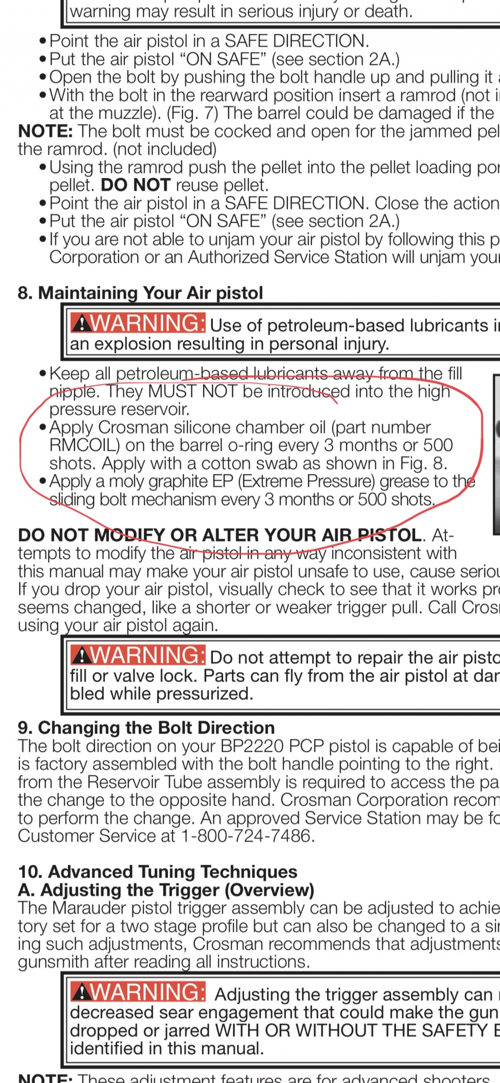

I got a Prod in January as well and the magazines where also very tight and difficult to insert and take out. The manual recommends lubing the barrel o-ring with chamber oil. After I did that the magazines slipped in and out without issue. If you haven’t tried that you might give it a go first.
