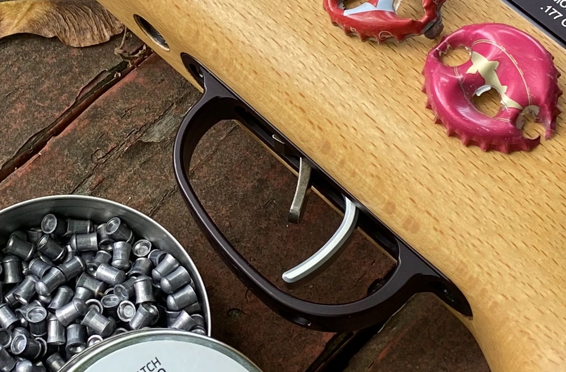

The RAW trigger blade is also a nice upgrade over the stock item. I had to drill the pivot out just slightly to fit it over the pin, but it is otherwise a drop in replacement for my Gen 1 Marauder trigger.
Reactions: Yardstick
I have two guns set up with the RAW trigger blade, and agree that it is an improvement over stock. If you want the ultimate in upgrades by swapping out the one part, you could use the Rowan Engineering RAW blade for even better results. I have one of these on my purpose built bench rest Bottle-Rod and it is fantastic. I also have their trigger on my Daystate Air Ranger and am thrilled with it there too: https://www.rowanengineering.com/products24.htm#theobenadjtrigger
Do note that neither of these are true "drop in" mods - the RAW trigger pin that it mounts on is a tad smaller than the Marauder's pin, so you will need to drill it out to get it to fit, but this is easy to do even with a battery powered hand drill. Also note that all of my Marauder's are Gen I, but the trigger blades are the same between Gen I and II . . . .
Reactions: rcarlisle
I have a couple of Rowans, IIRC you can order them with the correct pin size so that they are indeed drop-in.
Airgun revisions also sells "competition trigger blades", which I believe are current gen challenger triggers, I have one of those in another gun..... actually I prefer this one over the Rowan if you do not need the fore and aft adjustment.
