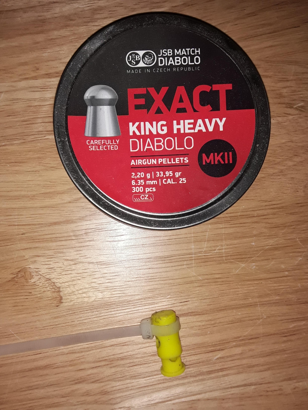

I was going to order that tool from Archer, but then I just kept looking around the house for anything that could be used.
This came off of a old backpack or pair of shoes, I forget exactly, zip tied to depth, works like a charm.
