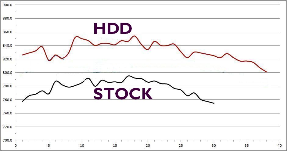

This graph shows that even though the Marauder with the HDD was tuned for a higher velocity (60-70 F/S faster) than the unmodified stock gun, the HDD modified gun gave 50% more shots compared to the stock Marauder.
This means the the shot count was 150% vs. stock, and the power was about 109% for a total in increase of over 160% in efficiency. If it's using that much more efficiency with the air, the sound goes down accordingly. Therefore: More Shots, More Power, More Quiet!
