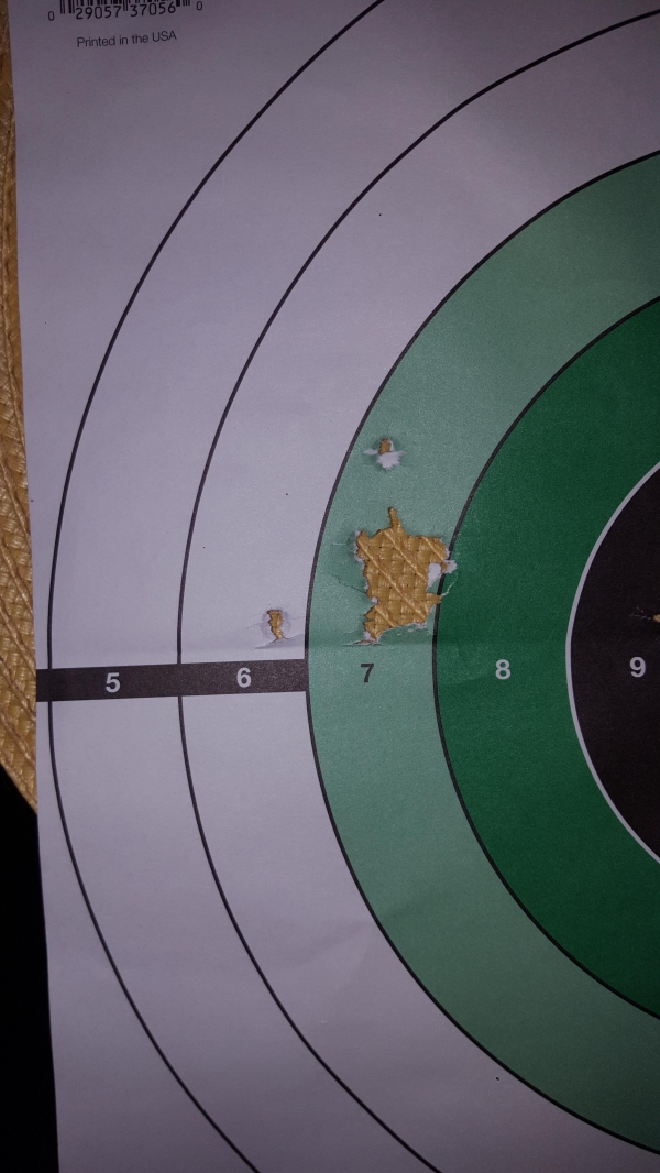

I shot an 8 shot group again today to make sure all my settings were right for the season and damn is this thing wicked ! My group was a ragged hole about the size of a nickel at 50 yards with the jsb pellets. 2 flyers but the skirts were a little messed up I just put them in anyways. The other 6 stacked on top of each other! I was shooting 3inch disc spinner targets at 90 yards with just plain on H&N Baracuda pellets 7/8 times! That is simply amazing!! A sub 500$ pcp that can hang with some 1000$ guns. My next will definitely be a TDR so I can bring it on my motorcycle when I buy it but wow. If anyone is thinking of buying a new gun or starting out I would recommend the .25 gen 2 marauder all day long if you want to hunt. Nothing will get away this year !! Grouping posted below...
(50 Yard group site in grouping)
I was shooting semi rested so no gun vice and this gun is out of box just cleaned the barrel that's it no mods. I will surely mod it because I'd like to get 20 accurate shots per fill right now I'm only getting 16, and I know that is mainly due to extreme changes in velocity but I watched several videos that show you how to tune it and one very informal one from airgun web tv so I'm going to try it after this season but for now this thing is going to devistate squirrels, rabbits, and doves this year! Thanks for the input as well guys that's why I love this forum so much and the airgun community. (No powder snobs) . As always Happy hunting !

Very nice results on that MROD .25. As a devoted MROD fan, I would say out of the box the top 3 MUST do's on a MROD out of the box is:
