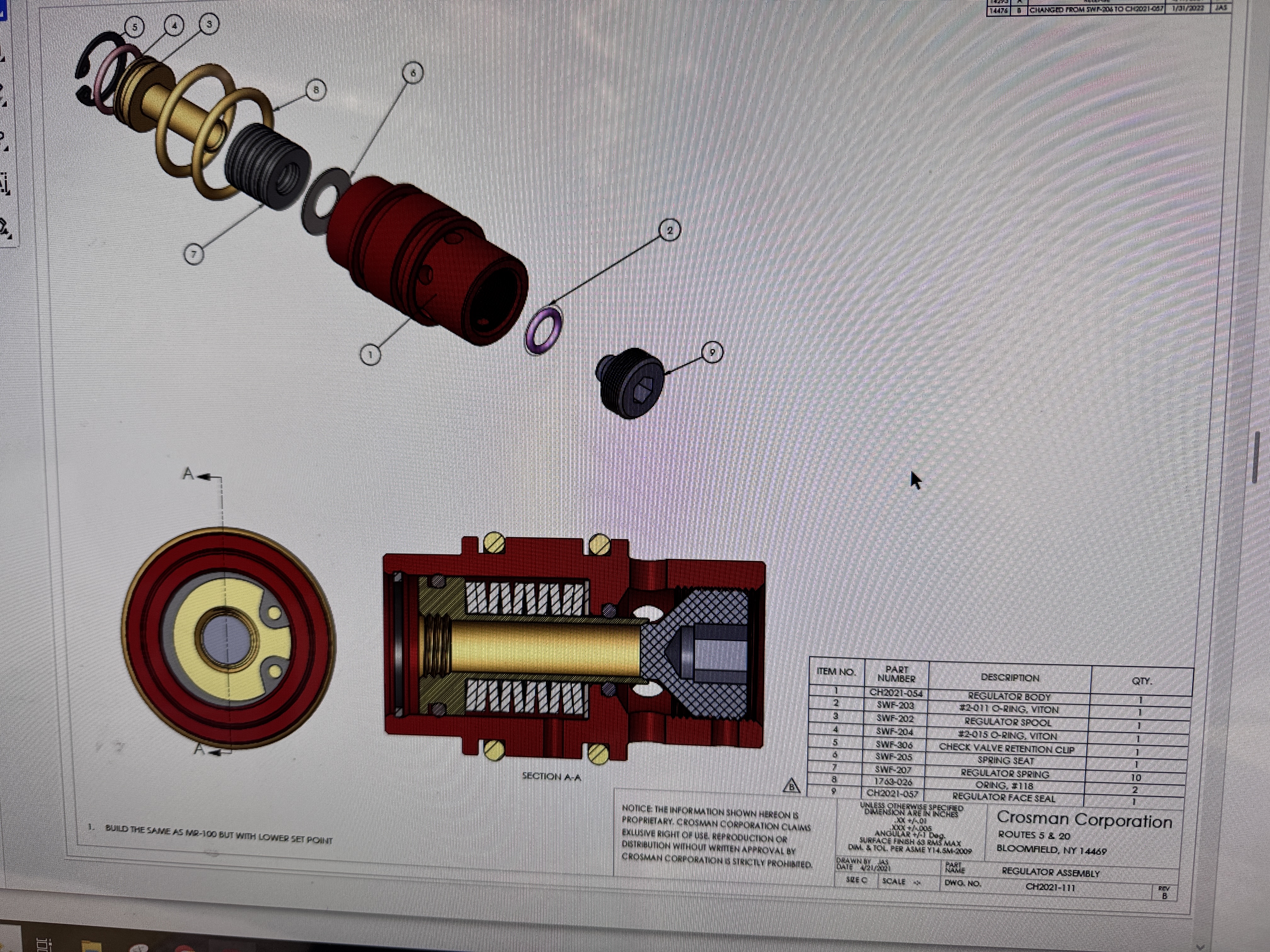

You can fill to 3400 without issues. Just use the gauge on the pump or bottle.
I need to specify that we are only talking about the 2021 Challenger and not earlier Challengers models without regs.
The Benjamin Regulators are the most robust in the market today. They can keep up to the semi auto action without needing a ton of Plenum. The belville springs are the largest in any Reg manufactured so 3400 is cake.
The only thing I would recommend is not keeping the Stock output set at 500psi. I personally don’t like a major variable in pressure from high side to low side on one tube.

You are the man! I knew I read that somewhere. I just recently got my hands on the second AR Challenger HFT, (I foolishly sold the first one, and still regret it) and was just reading up on them when I saw that mentioned somewhere. It's not like I need a great increase of shot count, just like to know the limits I'm working with. I fully understand this is only for regulated rifles.
I hate to sound like a fanboy, but you sure know how to build an airgun! These things are some of the most fun guns I've shot in a long time. Accuracy with Benji 10.5 single die pellets is nothing short of amazing. I love the thing.
What’s the load on the 3 screws holding the valve in? I wouldn’t push it past 3000 psi , regulated or not.
Well, we are dealing with a one inch ID or a little bit more. Those three screws are holding 1000 pounds each.
There was a test of the (after market) aluminum air tubes. I think it failed around 9600 psi. The aluminum tube wall sheared, not the screws. There is a good safety margin here with both the steel tube and those three screws. Less so with the aluminum tube. Steel does not really fatigue if not taken beyond elastic limits. Aluminum fatigues with every cycle and will be directly impacted by fill pressures.

Is that the same regulator used in the Marauder F&T? I have had a couple of them leak at the #2 o-ring.
Yes and no. Same reg but different outputs.
That’s why I list both separately on the website or the third option being set at a custom output pressure.
I’ve replaced some under Warranty mostly due to them being compromised when installed from new. Other then that the ring could come forward a little if the high side gets depressurized faster then normal. Like something going wrong with the foster fitting or something at one point.
