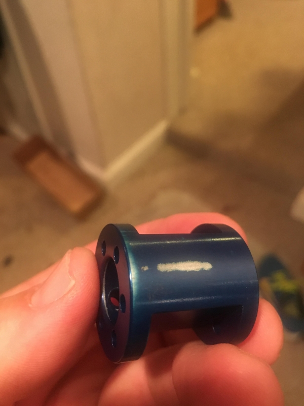

Very close inspection of the hammer showed wear on the edge where torsional binding might occur and where the hammer slides over the sear. Didnt look like much, (less than 1/1000) but maybe enough to provide just enough wiggle for binding up (Aluminum vs Steel)
