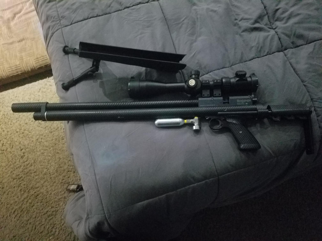

I personally have gone above and beyond with my marauder, no regrets as its a tinkerers gun and thats what I enjoy doing, tinkering. I added more plenum volume externally on mine as most in tube regulators have insufficient volume for high power. Reg volume before 20~ cc, reg volume after 53 cc.

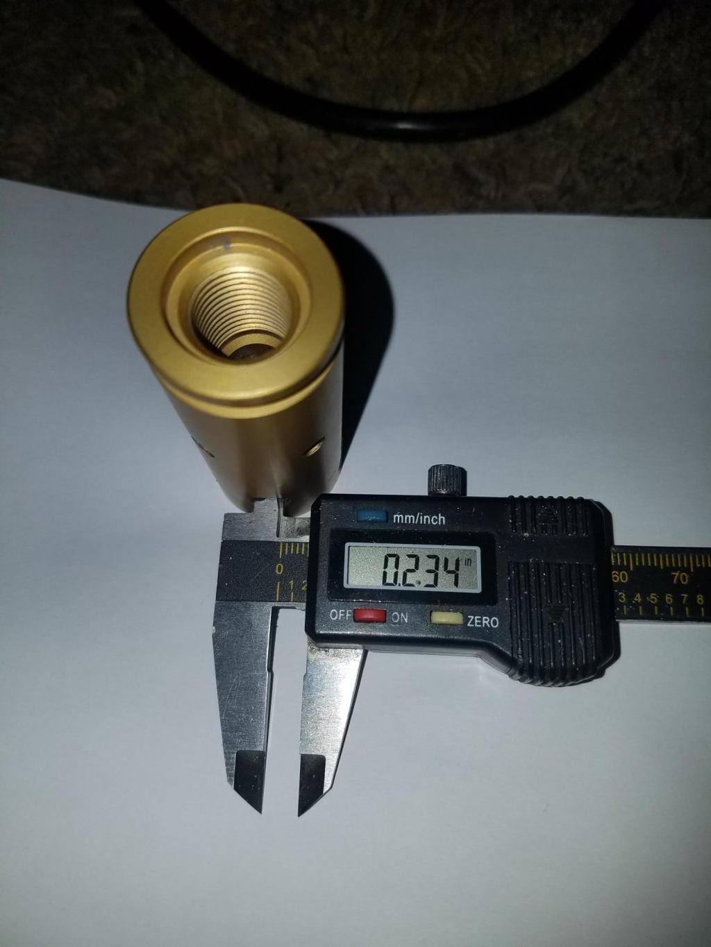

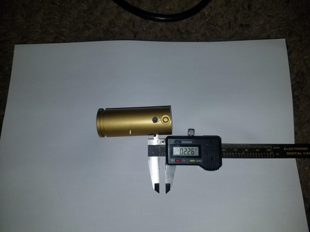

And...the max you can take the stock valve safely (imo)..
.234 + .226 / 2 = .23" porting. This was achieved going at a roughly negative 15 degrees towards the rear of the valve to avoid drilling into the valve seat, and safely dremeling the port obligingly until desired results were achieved. The other inhibitor is the barrel ports recessed OD limiting your transfer port od and subsequent porting going through it. Even if you could drill the valve larger than .23", you would have to recess a new transfer port hole into the barrel and valve larger than the current one. The above is extremely hard to achieve and I do not advise attempting it without being willing to ruin a valve or possibly barrel when porting this large in a marauder.
