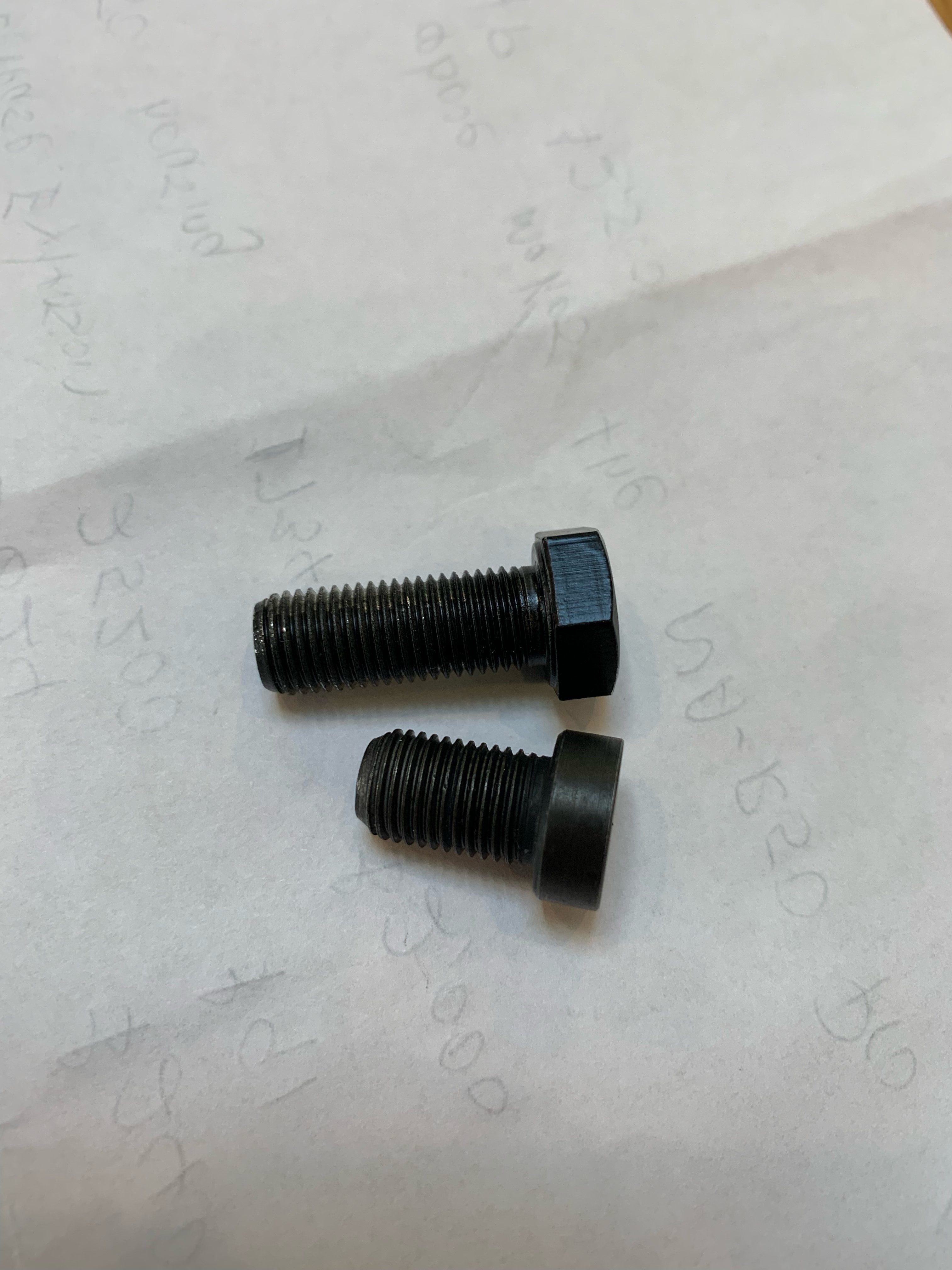

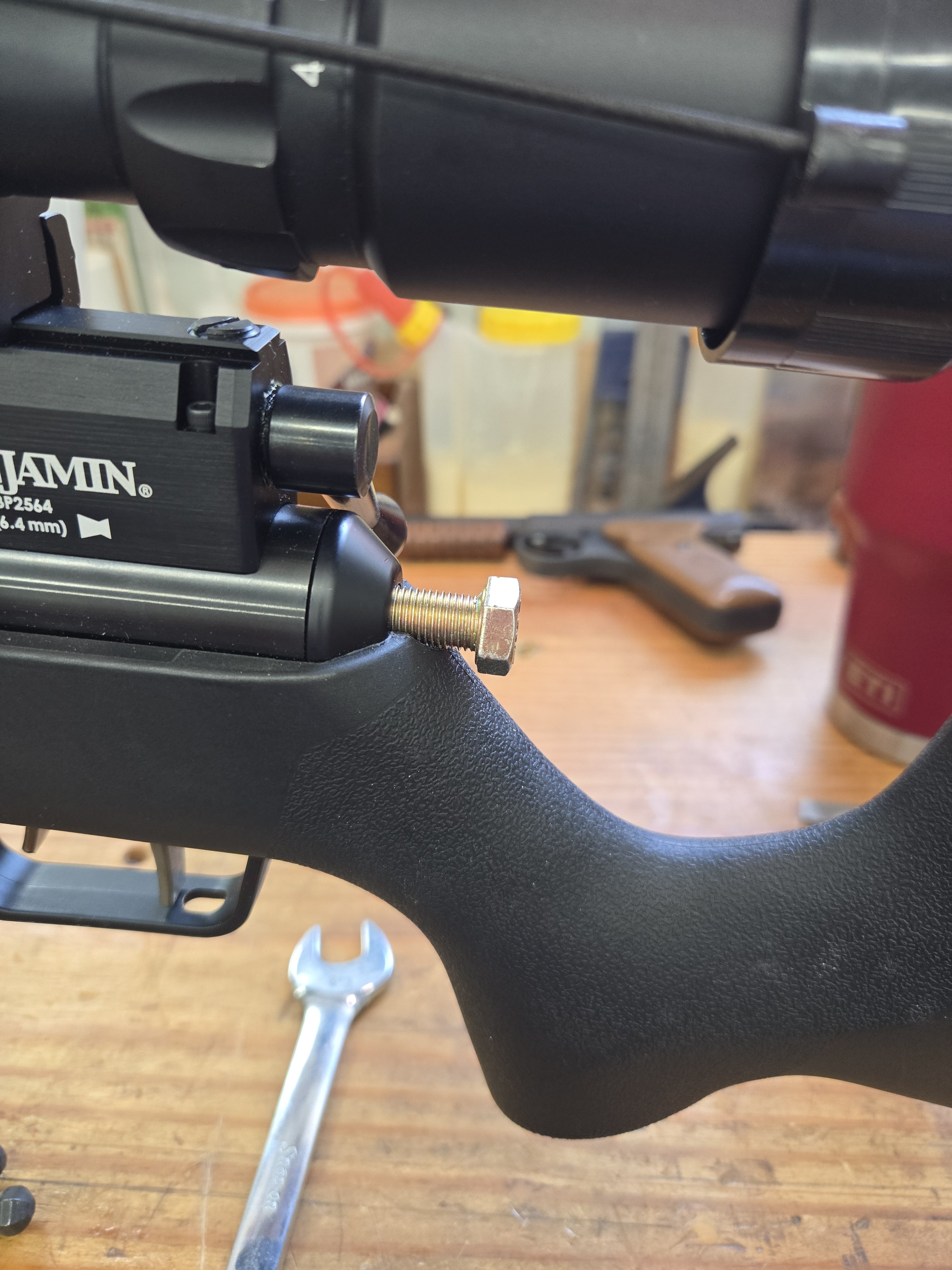

What I have found is that using a thumb rest, either the one from AGR or go to a hardware store and buy a bolt and paint it black, makes cocking very easy and as easy as a side lever on my SL M-Rod. These two M-Rod .25 rifles have the AGR thumb rest. It is a machine piece and does take blue. I also have done similar with stainless steel bolt.
The way it works is that you place your thumb on the rest and grasp the bolt inward as close to centerline as possible and then squeeze your hand like squeezing a rubber ball. Now, I have large hands and worked as a mechanic some so they are pretty strong. A small child or woman might not have the grasp or reach but I figure most folks would have no issue there.

Bolt size and thread? I often use my thumb on the back of the cap...but I can see that a little extra length would be mo bettah.
It is 5/8-18 thread. The additional length is what makes the hand squeeze work. Maybe somebody with small hands might be okay resting on the end cap though possibly uncomfortable.
