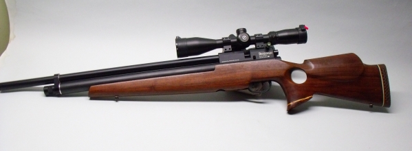

A picture would help-from your description it sounds like the shroud almost touches the top of the barrel band? The shroud on my .22 Gen 1 was close to the bottom of the barrel band. I eventually removed the O-ring in the barrel band and added an aluminum ring to make the shroud center in the barrel band-you can just see it in the pic. This seems to have stabilized the POI from fill to fill. I also lubed the o-ring on the thimble at the end of the barrel inside the shroud with silicone grease. It is recommended on the Gen 1 Marauders to tighten the shroud completely then back off a quarter turn.

i will put up a picture or two on the close proximity of the barrel/shroud.
so if i understand the shroud is not to be tightened against the mount shroud, one quarter turn off will allow the barrel to float and center itself better in the barrel band.
perfik, i will make the adjustment tonight and see where it sits.
using Premier hollow point 14.3 gr and it is very accurate out of the box.
chrono running at 865/870 fps.
does the fact you have an aluminum ring centering make any noise difference eg. ringing off the shroud, just curious.
