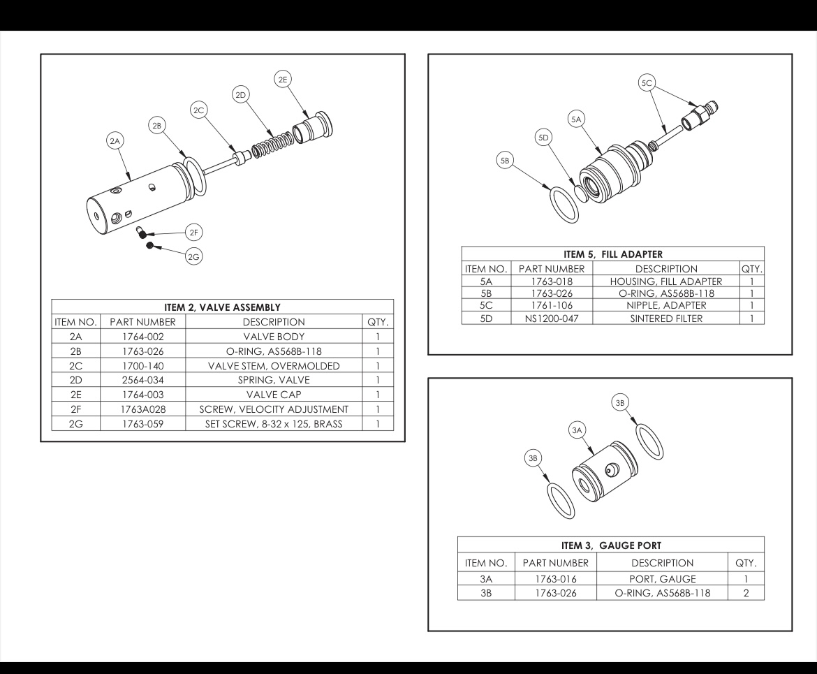

Just strip gun and use new -118 o-rings. There are 4 of them plus a -009 under the gauge fitting.

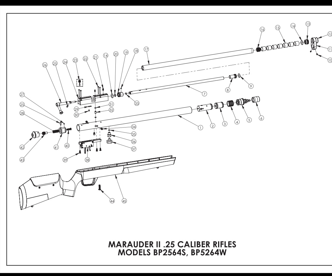

As a new SynRod owner (a local auction buy) I read all these posts with great interest. With respect to the OP, Does anyone have an exploded bueprint where to find all of the replaceable o-rings? How do you do a "balloon test".

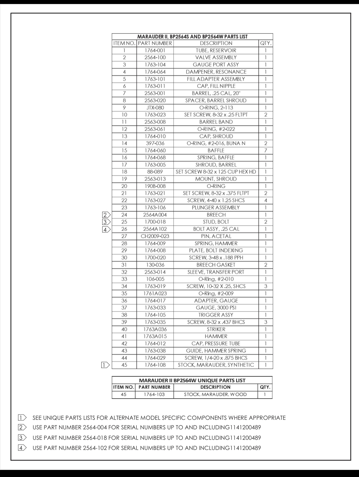

The owners manual which can be downloaded online from the Crosman site has schematics. Replacement o-rings can be purchased online. I bought mine from an Ebay seller name "Captain O-ring". The balloon test is accomplished by pulling a balloon over the end that you suspect a leak from and taping around the end so no air escapes. A leak will inflate the balloon.
