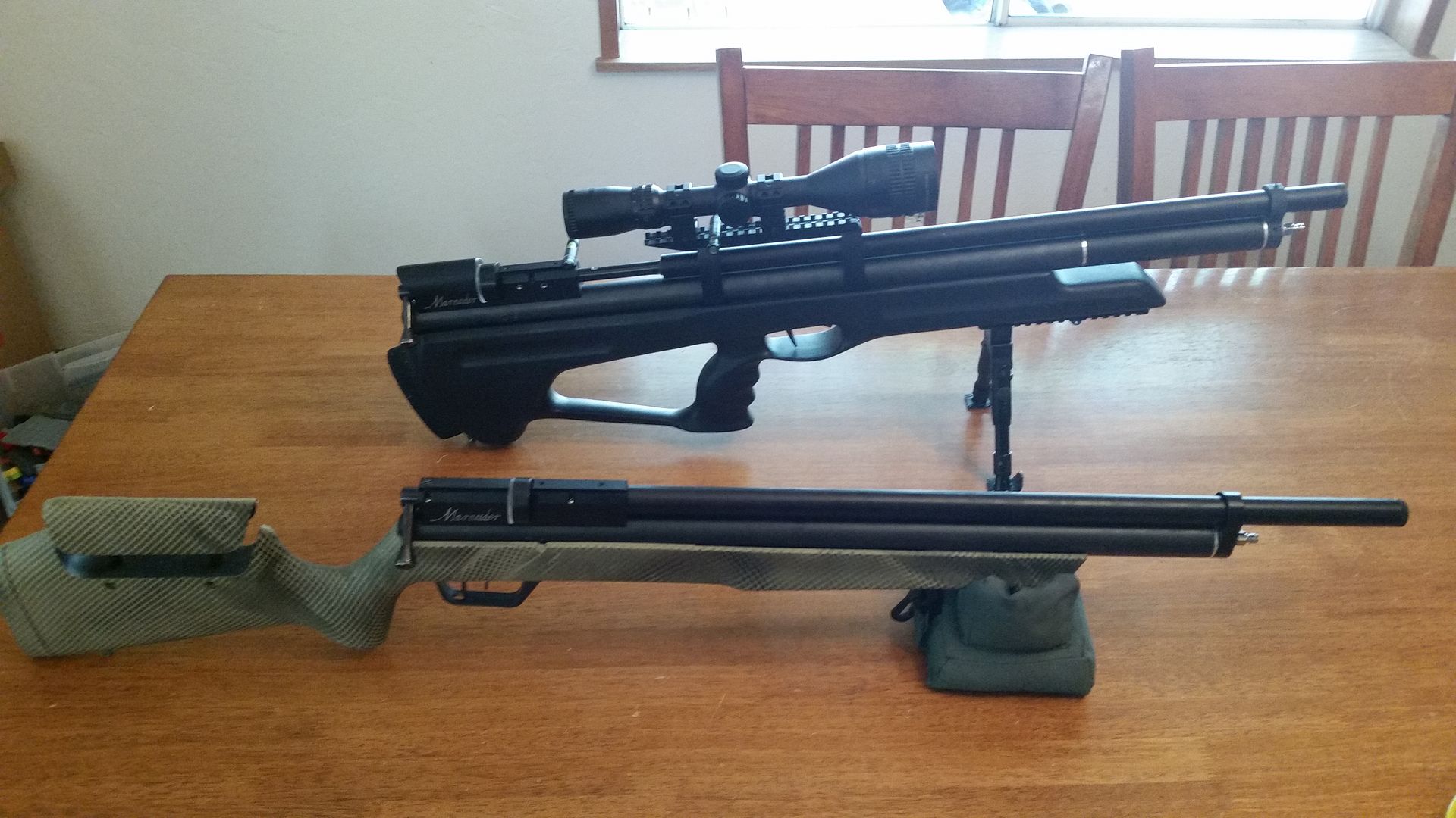

Only complaint I have applies to 95% of pcp air rifles, its weight. Almost all pcp's are 7-8 lbs, 9-11lbs scoped. Wheres an aftermarket aluminum air tube replacement for our stockers!? Probably shave 2 lbs!

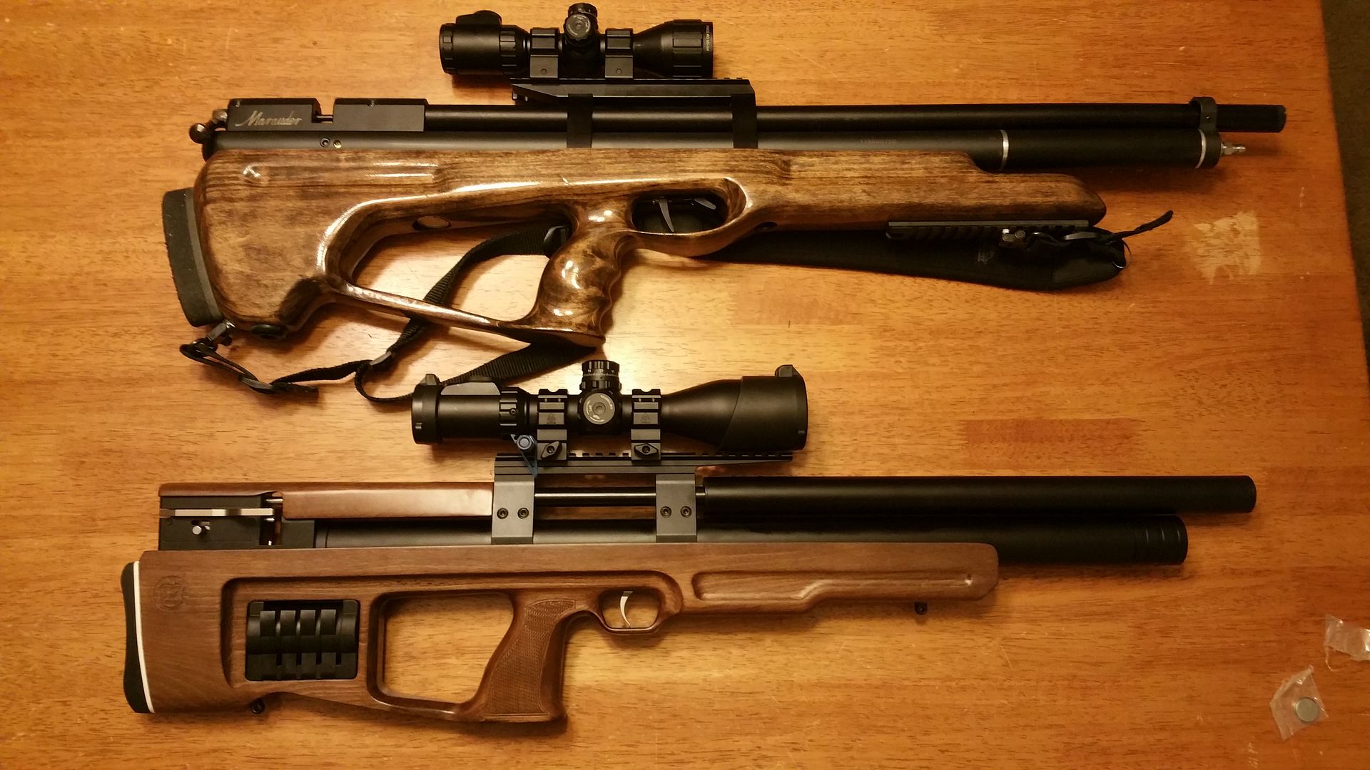

Mrod with refinished MDRL stock next to the Kalibrgun Cricket
Great job on refinishing that stock, I may just have to go that route, something about that wood finish.
