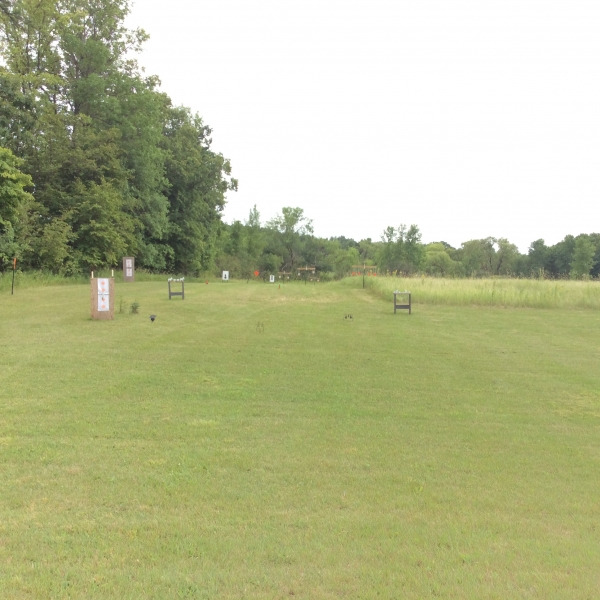

These are what my son shoots at with the .22 Marauder, the gongs at 75 and 109 yards are a challenge for him but everything under 60 yards he can hit. So is the 22 a good shooter....yes it is..
