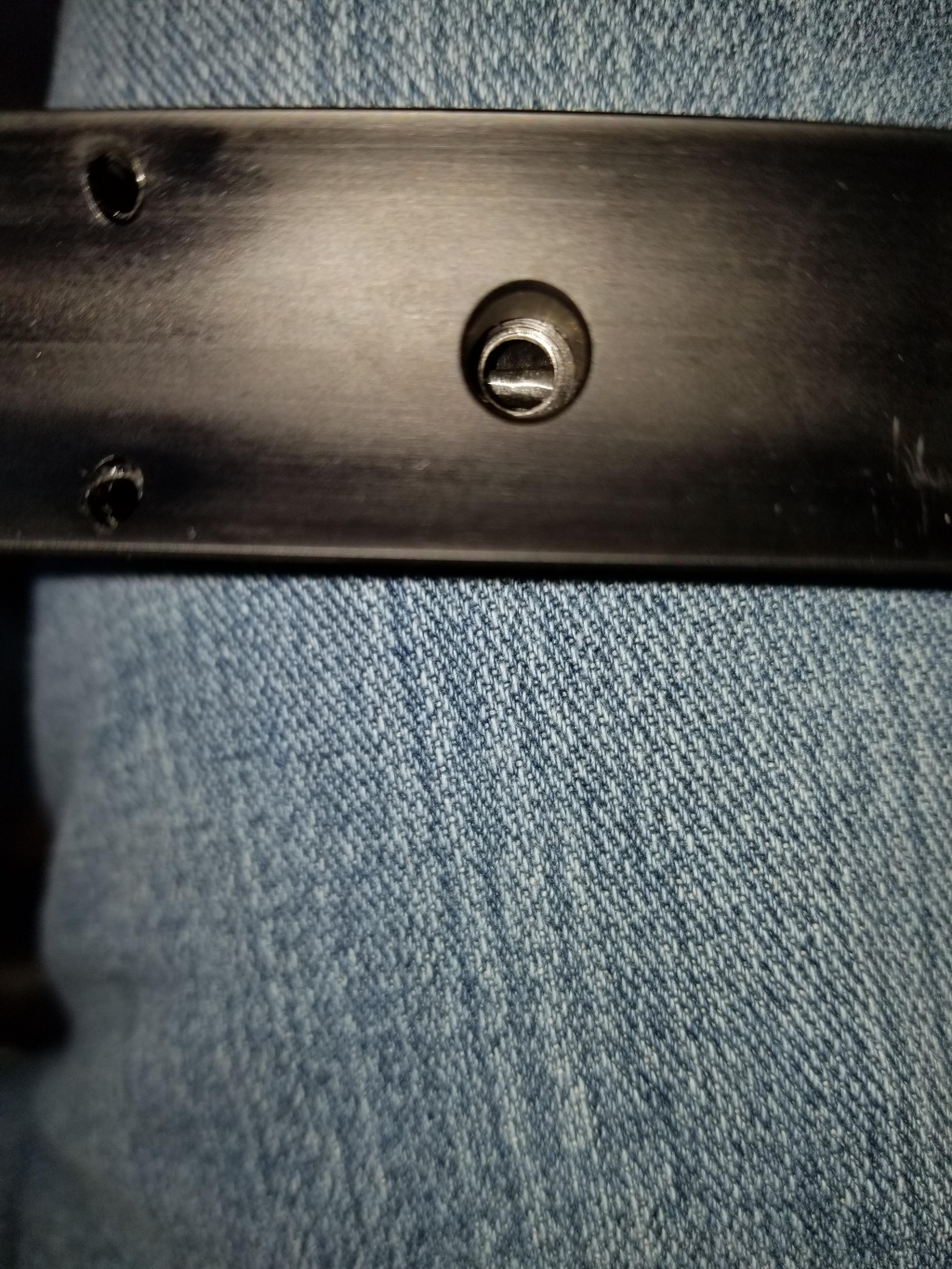

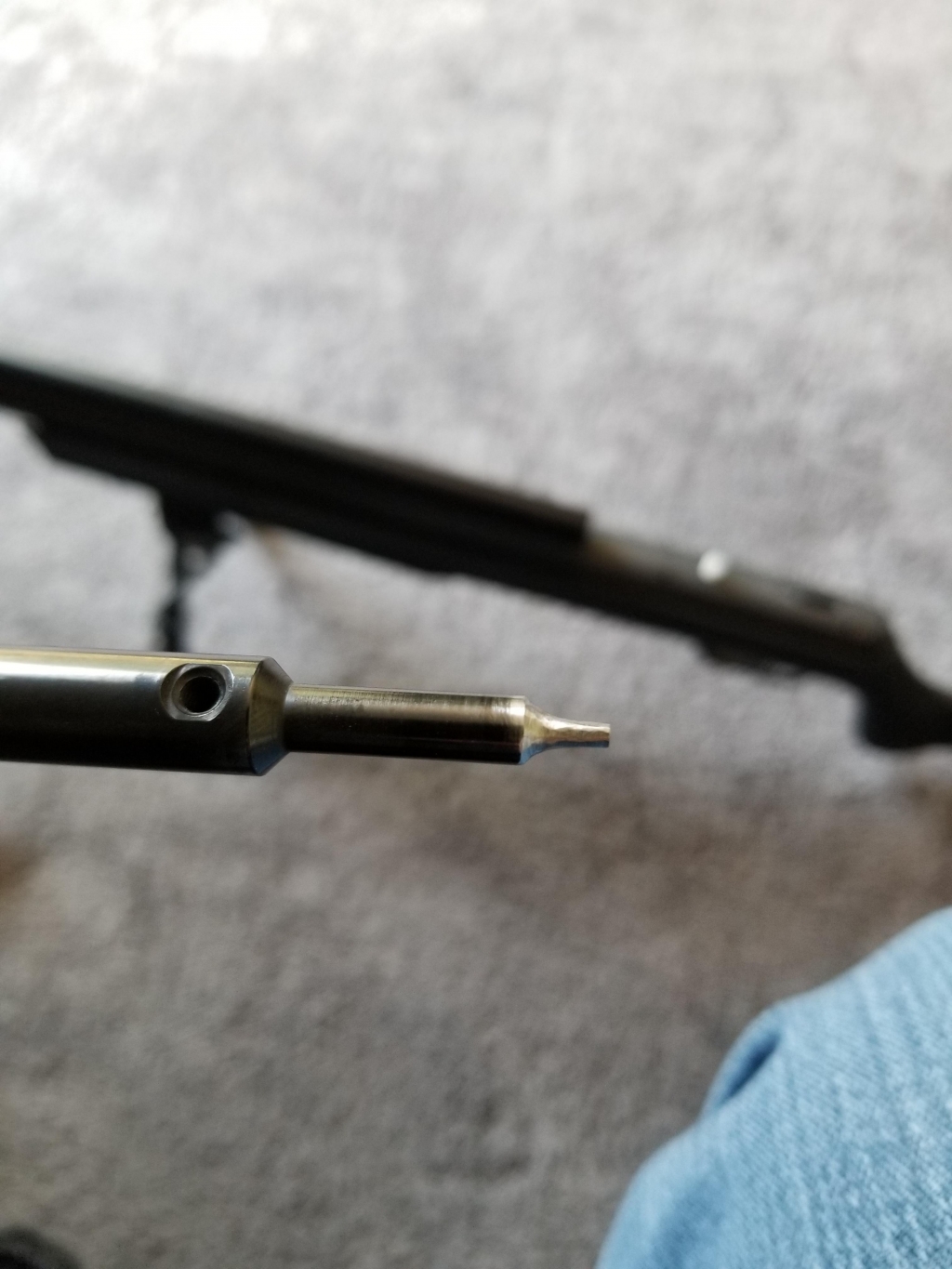

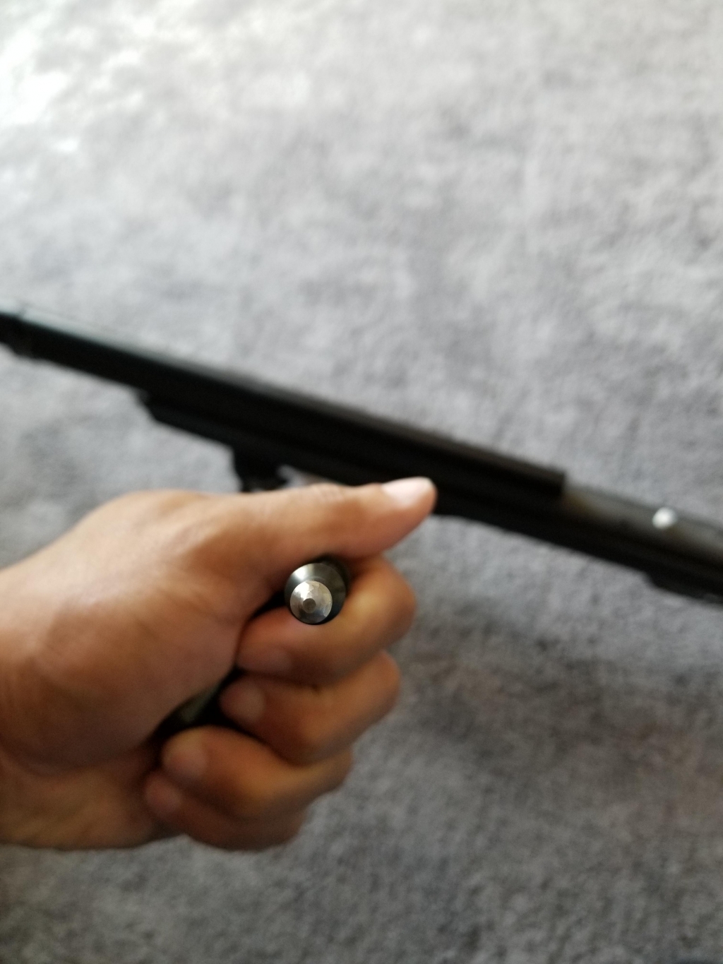

I have completed the Probe mod, I will test a bit later. Here are some pics i am sorry that i did not take some pics before.

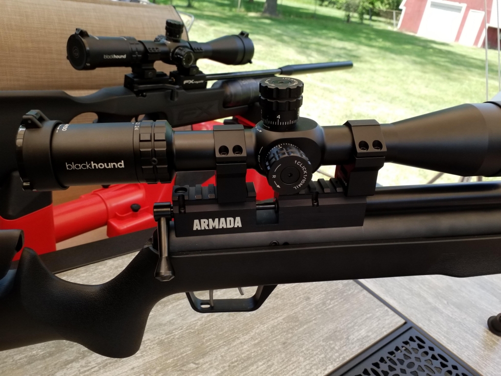

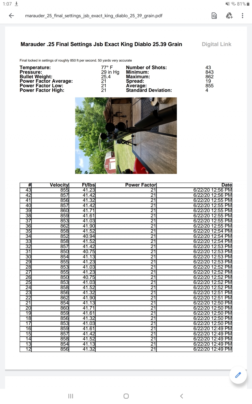

Completed my build of the .25 Benjamin Marauder with full Hill internals, and the bolt probe mod tuned to 850 ft per second accurately shooting jsb exact King Diablo 25.39 grain pellets at 50 to 100 yards. Added an Armada breach and a Blackhound Optics 6-24X50 scope and the hill moderator. Getting 44 accurate shots before drop off.
View attachment 1592846038_452799515ef0e6d6cb8c41.82473117.pdf
Rick, when I had the 40/40 tune going, your shot string along with all the performance mods done is exactly how my 25 cal performed. Exactly. You have to give credit to Hill and his products. He did all the R&D, went they all the air and pellets, in designing his parts. When he told me years ago all I’d have to do is turn the hammer spring adjust Kent for less or more power and that’s all there was to do, he wasn’t kidding.
