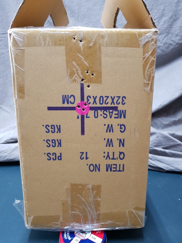

I have a Marauder as well. Hollows are definitely the least accurate I've shot. I have a couple tins and use them when I'm just burning through pellets to settle parts down or such. Premier Domes are OK, but at longer ranges, the JSB 18 grains seem to work really well. Each gun is different, so try different pellets, but this is a good start. With no modifications from the factory, shooting the factory tune, I could do about 1,5 inch groups at 75 yards with the JSB's. Never could stretch to 100 yards and get smaller than 6 inch groups though. Something happened in that last 25 yards, but at 75, it is accurate. Only tried it a couple of times, so tuning might have helped.
