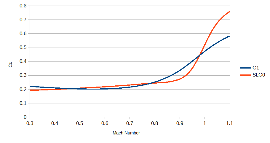

Thank you for this! Do you have any idea how it compares, BC wise, to G1? Like, is there a ballpark I could start at to verify the dope?
Below is a comparison of G1 and SLG0. You can see that between Mach 0.5 and Mach 0.8 the values are very similar, so should give much the same BC at those speeds (roughly 550-880 ft/sec). At higher speeds, using G1 will tend to give a rising BC, SLG0 should not do that.
There may be a bug in the feature in Strelok (can't clone standard drag functions), but you can get around it. Go to the drag function selection screen, long press one of the Sierra or Berger functions, and choose Clone. Then long press the clone and Edit with the table data for SLG0.
Well I went and actually tried this... Problem is I don't see a way in the UI to add more rows to the table :/ Sigh... probably need to email the developer.
Sounds like maybe starting out with a slightly lower BC for SLG0 then. Is this drag law appropriate for round nose slugs like the Altaros design, or is it better to stick with G1? Or even RA4?

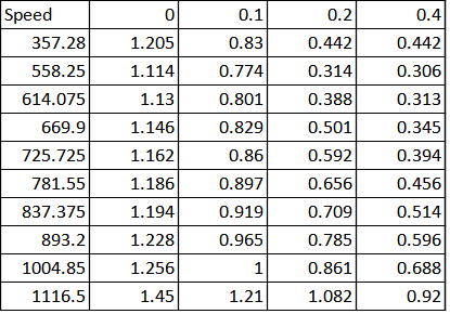

Matthias
The reference drag laws do not represent the drag coefficient values for the projectiles, they represent the shape of the projectiles drag laws. The idea is the true drag coefficients of each projectile are the same as the reference drag law multiplied by the form factor.
The original method for BC values of airgun projectiles used a constant reference drag coefficient value. The actual Cd value used was low, which resulted in low BC values. With the introduction of better reference drag laws, such as the GA drag law for domed pellets, the drag coefficients of the reference law had to be much lower than the actual projectile drag coefficient in order that the commonly used BC values that existed at the time could still be used, otherwise complete sets of new BC values would be needed. When I derived the GA2 and WC0 drag laws, George Conway had to similarly adapt them so that the old BC values could be used, or would at least work reasonably well with the old values. As I have often said before, it is the shape of the reference drag law which is important, not its value, as that will be corrected by the form factor.
The actual estimated values for wadcutters are shown below. The values from 0 to 0.4 at the top of the table represent different amounts of rounding off at the edges of the wadcutter face. The speeds are in ft/sec, they were worked from ICAO standard atmosphere at sea level, Mach numbers.
SLG0 and the other drag laws at the bottom of your table are much closer to the actual drag coefficient values of the shapes they represent. SLG0 still has some modification to it to give an average value for slugs with different meplat sizes.
As for purpose drag laws, they are pushed out as the "latest" development in small arms ballistics. Large calibre shells and the artillery weapons have been using purpose drag laws for at least 60 years, as the BC methods were simply not accurate enough for indirect fire. I remember trying to persuade a UK small arms ammunition manufacturer to use purpose drag laws 40 years ago. Maybe pellets will go the same way, but I am not sure the makers will have the expertise necessary to produce them. It is not straight forward, even with a proper tracking Doppler radar. It can be done, but you need an estimated drag law to start with, which can then be calibrated by using radars or even velocity measurements at different ranges. There is no easy way of calculating the estimated drag law, and no readily available software to do it for you. For slugs, you are somewhat better off, though taking account of the meplat is not that easy.
Hope that explains the apparent anomalies with the reference drag law values.
