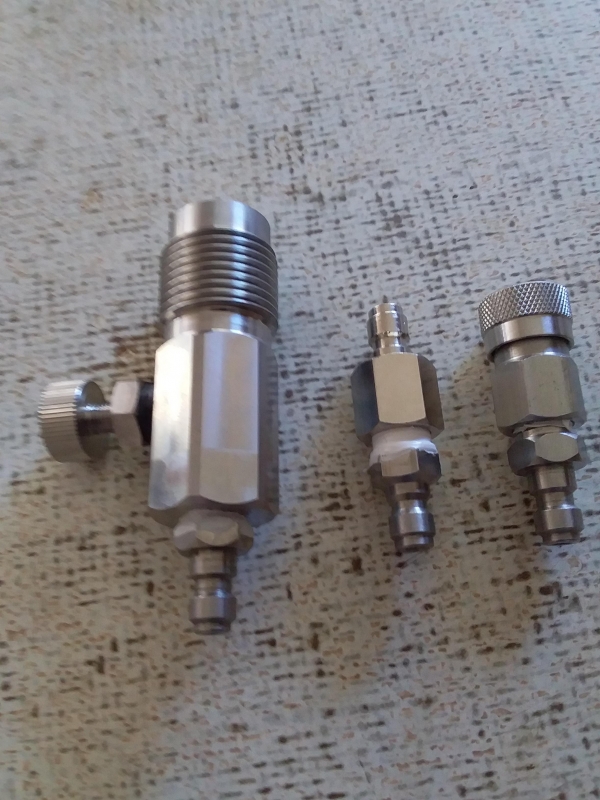

Yes, that is the type that I use. This is how they can be configured. The one in the middle can be used in either direction as an inline male to male connector. The left one is for a DIN 300 tank valve.the one on the right is a male to female and can only be used in one direction. About $24 USD for the lot.

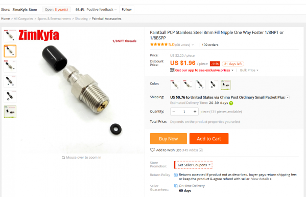

Eagle beak, thanks for replying with assurance on these fittings. The one shown from that Zymkyfa is the one I ordered, but got thru Amazon in 1/8” NPT. I do have a question for you though in your pic with the 3 setups. That check valve built into the fittting allows air to flow from the QD end towards the threaded end, correct? That’s how I understand it, so say one of these are threaded into my din fitting for say topping off a tank with my compressor, and right at 4,000 psi the compressors fill whip explodes. My tank should not empty out cause the pressure would push on the inner check valve, which is going against the airflow path I described earlier. You with me so far?
so, in your pic, the middle and the one on the right. The air flow on the right fitting goes from the male QD end towards the female QD end, so yes, I agree that can only go one way. But on the middle set up, you say it can be used in either direction?
I think for clarification, you meant it can be used in either direction, depending on its use, AT THE MOMENT. One still need to pay attention that the air flow will move towards the male QD that has the female threads. Am I making sense? The QD that has the male threads houses the check valve.
i apologize for complicating things. Jus wanted clarification, boss

No need to apologize. You have the right assumptions, the reason that the inline male to male can be used in both directions is by turning it around, it works the other way. You are right about having the stop valve as close as possible to the cylinder will avoid losing any air in the event of a burst or bad Oring down stream. The pressurized filter may still cause the hose to whip a bit in the case of a failed fitting but usually when that happens, it is the fault of the user using underrated or non compatible fittings or just failing to couple them properly. Those Zimkyfa fittings are well-made stainless and strong. I have had no trouble with them and the valves are very basic and function perfectly. They also cost next to nothing. If you were to buy the same thing from Joe Bandito, I guess you would pay more than 10 times what I paid. Before you buy elbows and other odd fittings, make sure that they are rated for the pressure that you are making. Always check that the direction the valve flows and that you have a bleeder, upstream, before pressurizing or you might find that you can't depressurize or uncouple anything without dismantling something.
There is also a need by some, like myself, to use a male quick connect where the air flow is out not in. When I configured by Bauer compressor, I machined an output connector block that connects the pressure control switch, a pressure gauge, the inlet line from the final compressor stage and a male Foster fitting that can quick connect to the same whip used on my gun fill bottles. This allows me to fill the large bottles that I use to fill guns. However, the check valve in the Foster fitting must be removed first. This is easily done by using a pin punch from the quick connect side and a few light taps of a hammer. This does no damage to the check valve if you wish to reuse the fitting for its original purpose.
