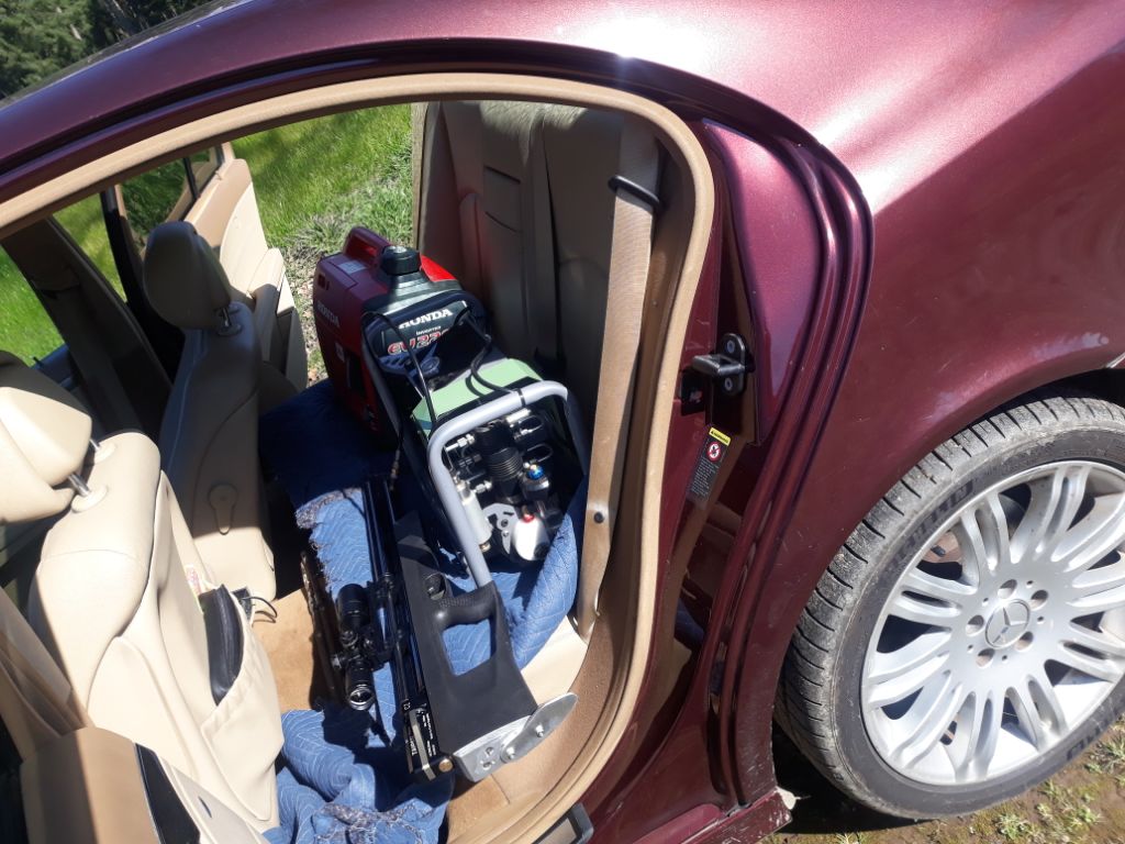

Bring a generator and the Yong Heng. I use the Honda EU 2200i to power a Hill EC 3000 compressor out in the field chasing ground squirrel. Maybe skip the tank altogether?

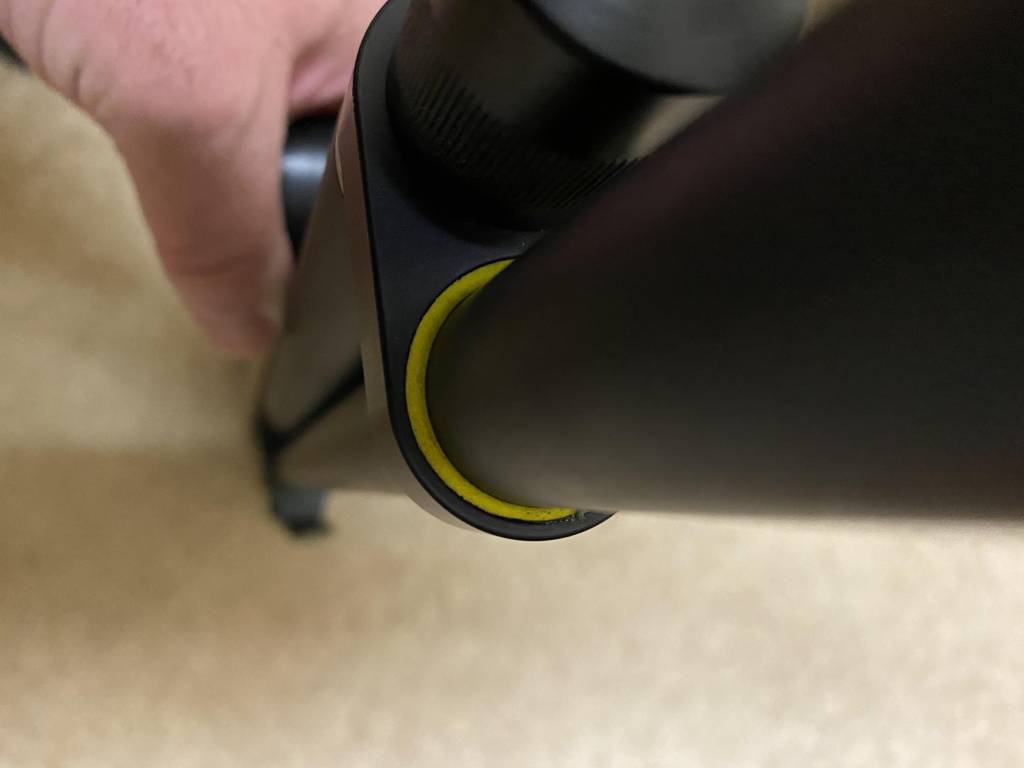

In fact..... Something he brought up, which interests me greatly is an upgraded barrel band for the Synrod. I have extensive background in powder guns from my military career..... so I understand full well that you can sink a ton of modifications/money into a given platform, but unless that platform is inherently accurate, you're only going to improve it so much. That being said, after research, it seems to me that an upgraded barrel band would indeed be a significant "bang for the buck" for a Synrod. Thoughts? I've also been looking around, and seen how wildly the prices seem to vary on this item, for seemingly little to no difference. Some I've found listed for as little as $20 + shipping..... and others as high as $89.95 + shipping. Am I correct in assuming that in most cases the extreme higher end have to do with the name recognition/popularity of the brand?
Barrel bands... Ed I haven't owned a Marauder and don't know how the barrel band is on them or if it has one, but I've had enough pcp's over the last 23 years to find out the hard way that when a barrel band touches a barrel it can cause POI shifts with temperature which has been my absolute #1 frustration with airguns. On some airguns the barrel band doesn't touch the barrel so it's a moot point.
So for especially precision and accuracy in airgun matches I try my best to get rifles with "free floating barrels". Some airguns with barrel bands and shrouds I'm not overly concerned with retaining a perfect zero and can adjust the scope back to zero when plinking, so I'm not so concerned about their slight shifts from day to day, but on other airguns that I depend on for steadfast reliability this is a different matter.

I asked him about the barrel bands, and asked if the aftermarket ones being offered do anything in maintaining the POI if/when the barrel is leaned against something or gets bumped. At first he seems a bit confused, and said he did put much stock in them, and basically said.... don't bump the barre or lean it against anything. :) That might be great if your a target shooter only..... but I can't help but think that in a hunting scenario, when a gun is always moving and hitting/tapping bushes, brush, limbs, etc. that IF those "upgraded" barrel bands might just be worth a go.

I don’t know that I’d spend the money on an “upgraded” barrel band. You can line the inside of the barrel band with hobby foam to keep it from rattling around. This has been a recommendation from Motorhead in the past so it comes from a trusted source.
I like that idea. I saw somewhere online/forums that other recommended a #30 O-ring, or multiples.... looked online and Home Depot stocks those, for about $3 for 10.
The more I think about my intended scenarios for the Marauder, which is going to be mostly hunting, I definitely want first shot accuracy/dependability, which makes me thing that those who say not to worry about it.... you can take a couple of shots to ensure the POI is accurate, are likely target shooters, and those who encourage the mod are like mind with me.... wanting to ensure the POI isn't affected if the barrel/gun get bumped a bit. This barrel/band thing is just another example of something I would not have knows, had it not been for these forums! MANY THANKS!!
