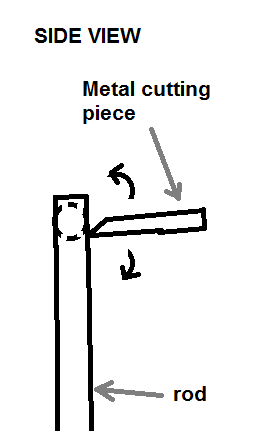

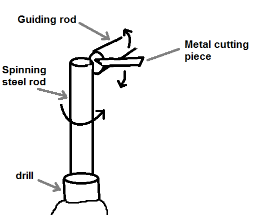

One technique I devise is by cold grinding a spinning steel rod with a metal cutting piece such as a metal cutting disc. The technique works by getting a steel rod of the same diameter or close to the diameter you want your steel balls to be, then mounting the steel rod on an electric drill and getting the drill to spin. Then positioning a 'guiding' rod close to and perpendicular to the spinning rod as shown in the pictures below, then pressing the cutting piece against this guiding rod while moving the cutter up and down. The cutter then grinds the spinning rod in a circular motion, shaping it into a sphere, similar to how they mold clay pots on a spinning table.
The cutter is finally moved deep into the rod below the guide and a piece of sphere is cut from the rod and drops off as a neat steel ball.

After working in the machining industry for many years, I can tell you that this is a near impossibility. Even with 100% accurate alignment, the material will "climb" the cutter as it gets thin and provide you with terrible results.
Hit YouTube and look up vids on making ball bearings. It's done with grinding plates and not a "lathe" type operation...
If you want to cut the spheres out . Use a metal lathe with a parting tool with a radius ground on it. You will need a left and right hand tool to make a complete sphere.
It is possible to grind a spinning rod into a sphere but the leading edge of grinding wheel will wear fast and will constantly need dressed.
