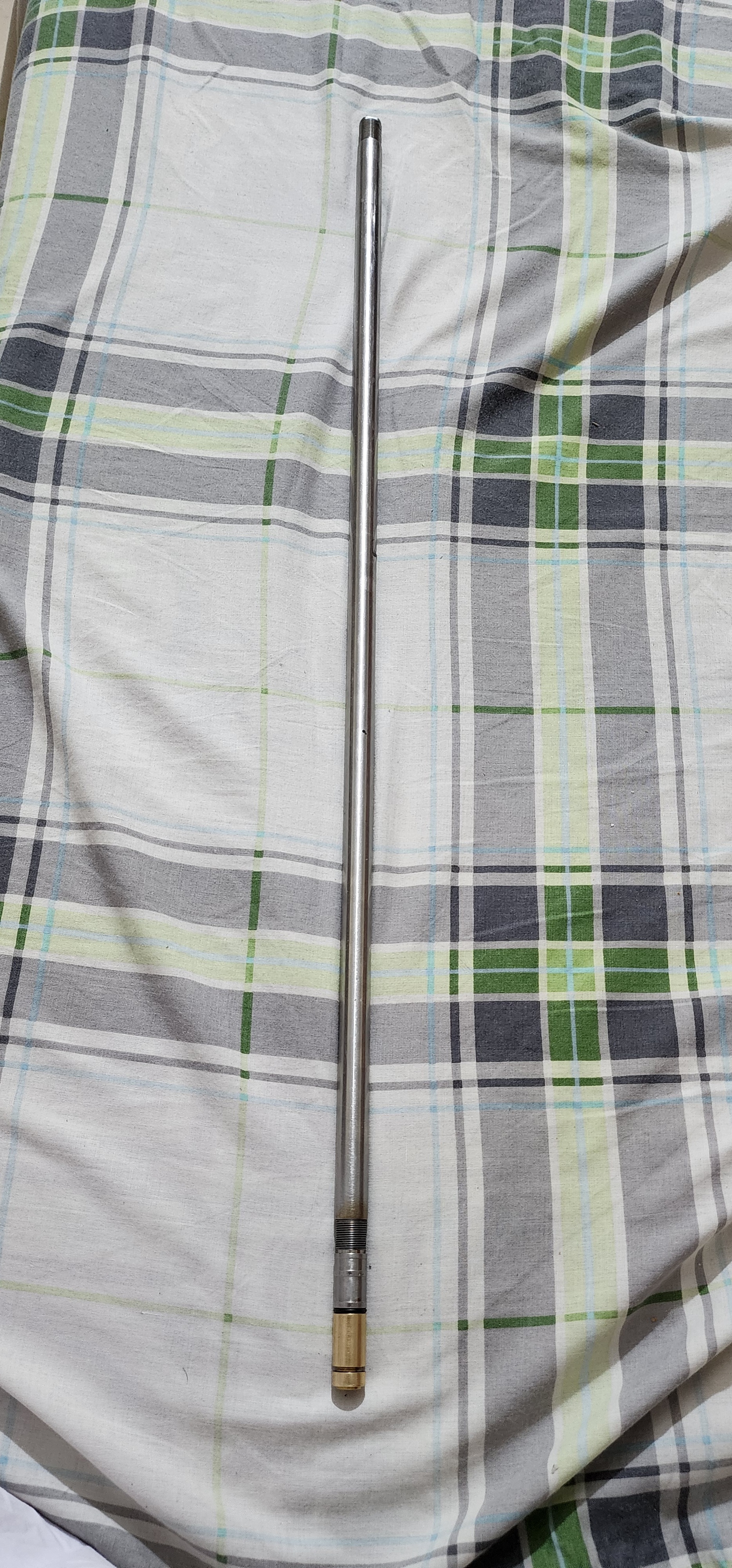

A friend was facing issues of POI shift with his Impact.

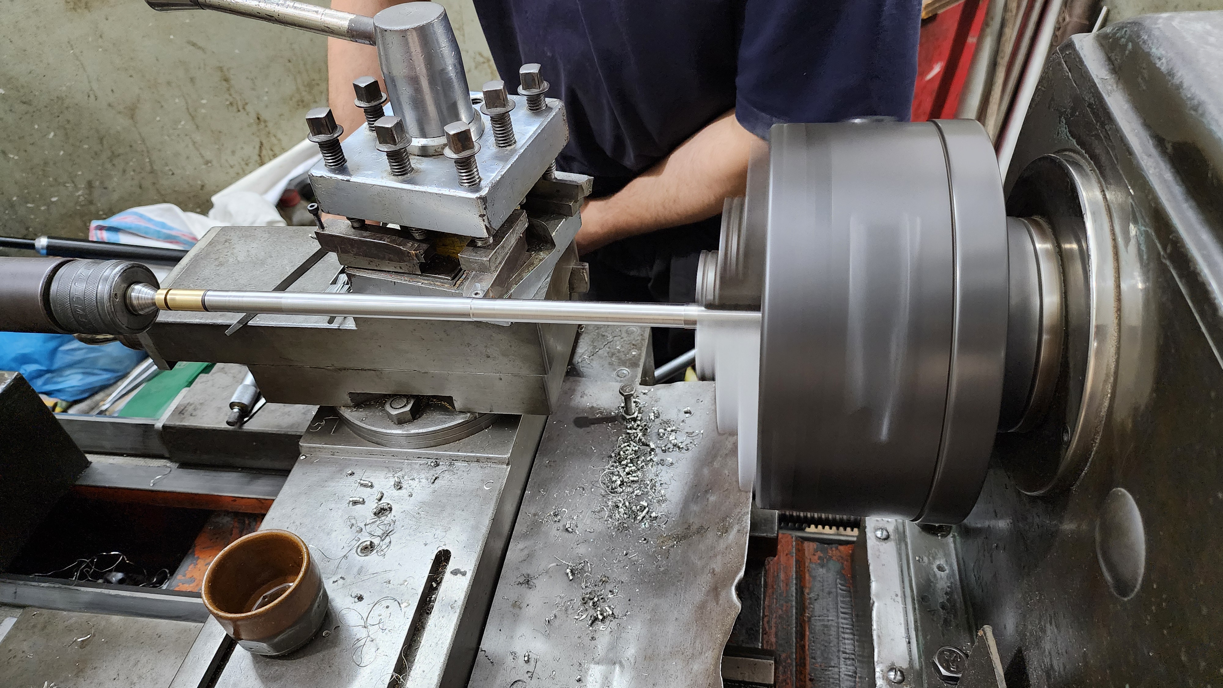

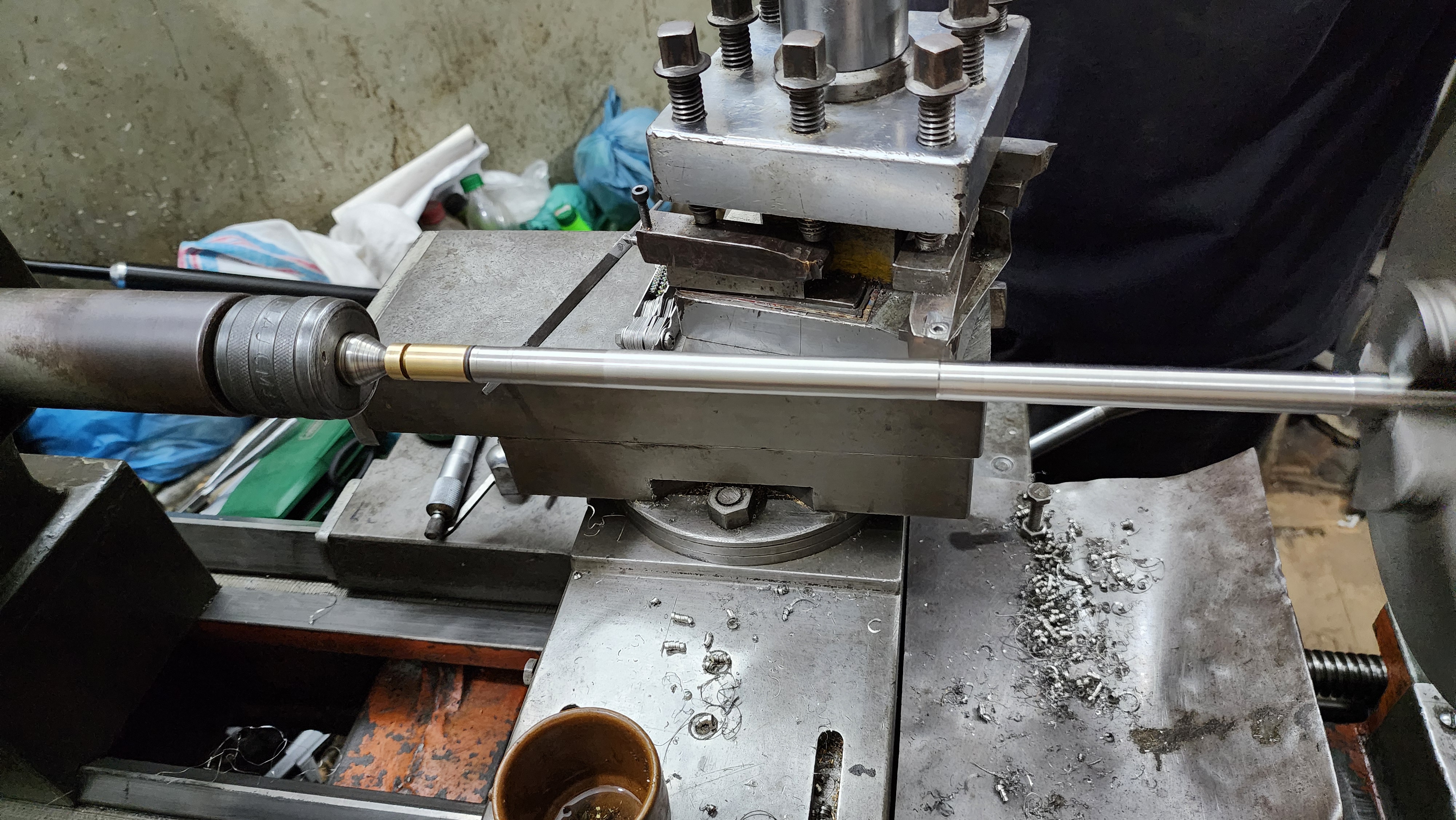

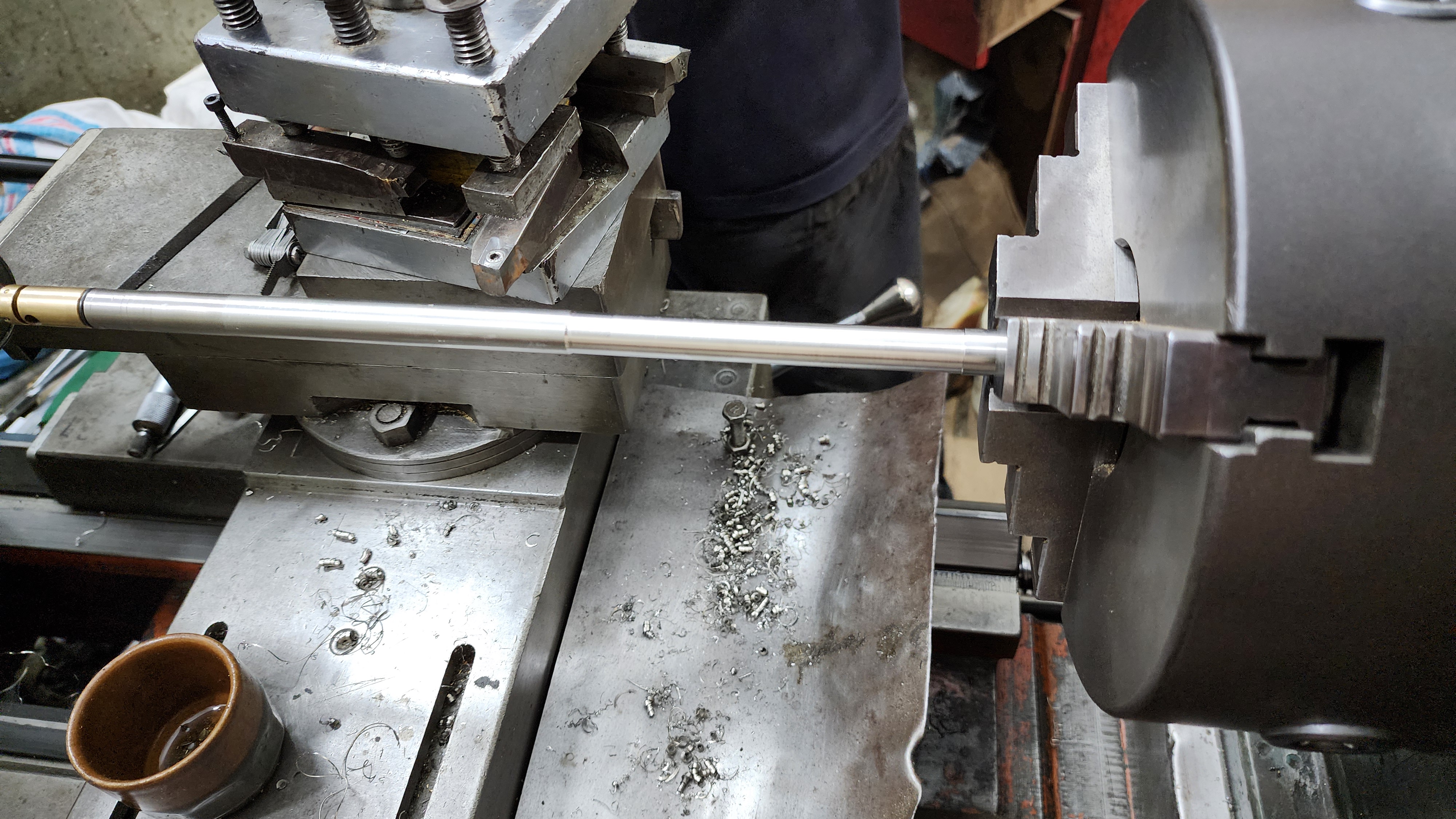

Just like my own Impact I started the procedure of making a solid barrel out of FX original liner.
Following are some pics of the process that started from making the outer surface of liner a bit rough then wrapping thread around the liner, then applying a very hard and sturdy glue on the liner wrapped with thread. The threads gap filled with the hard glue.
After getting it hardened, sanded the surface of the hardened glue to the extent that it could enter the barrel housing that I have made out of high grade stainless steel.
The process is at this stage at this time.
The next step would be applying epoxy between the prepared liner and the stainless steel housing.
The last step would be to bring the Impact as close to free floating system as possible.
