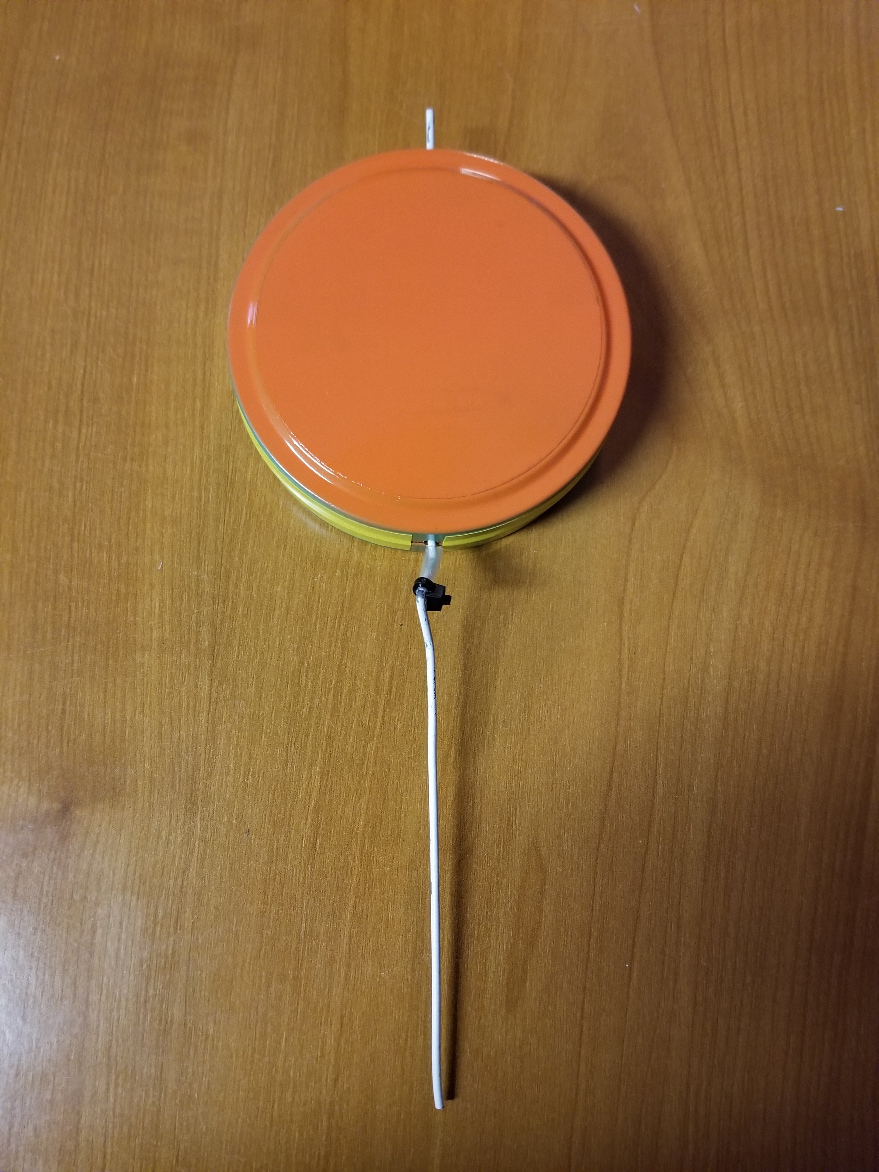

Here is what the finished target looks like:

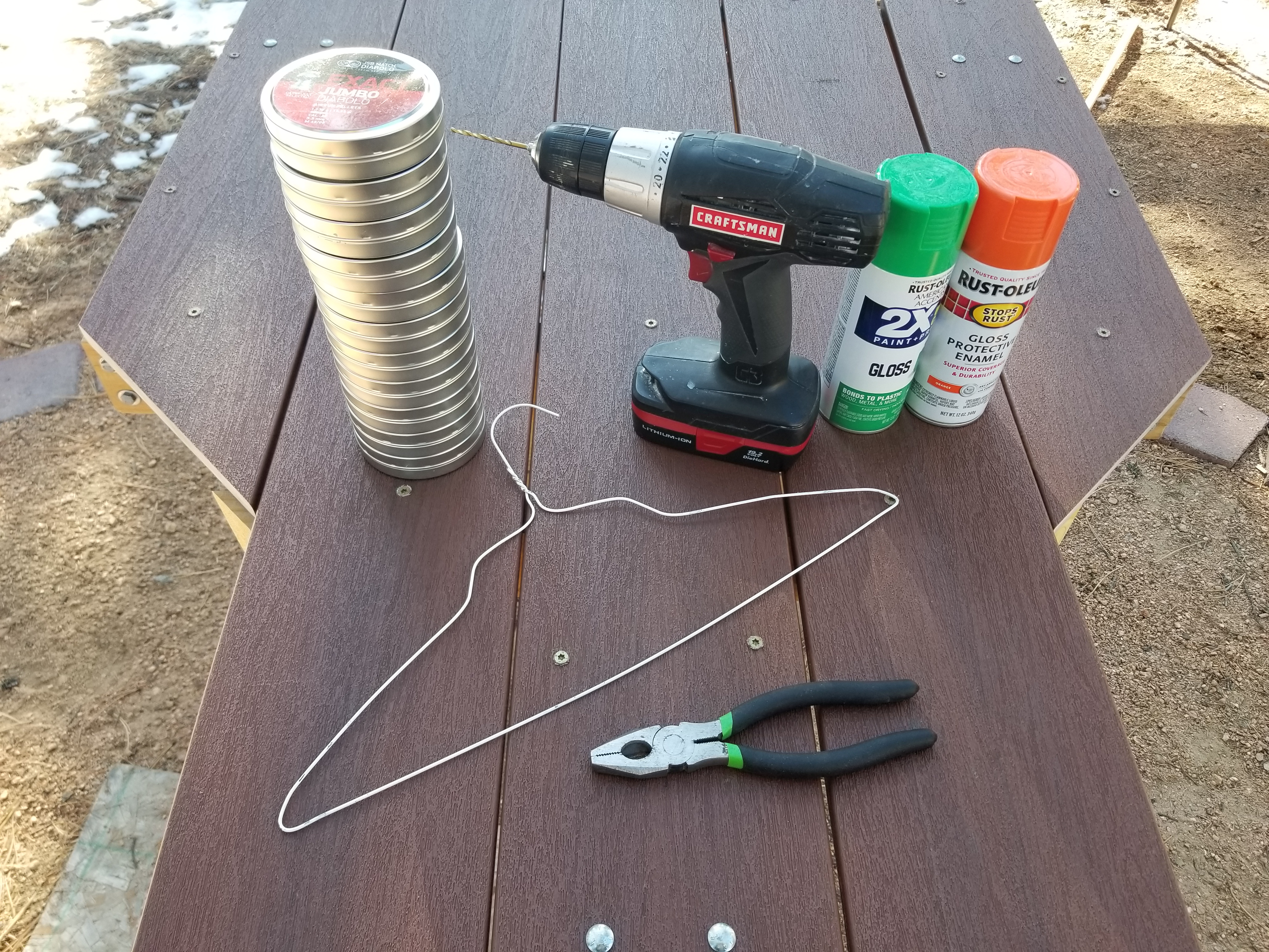

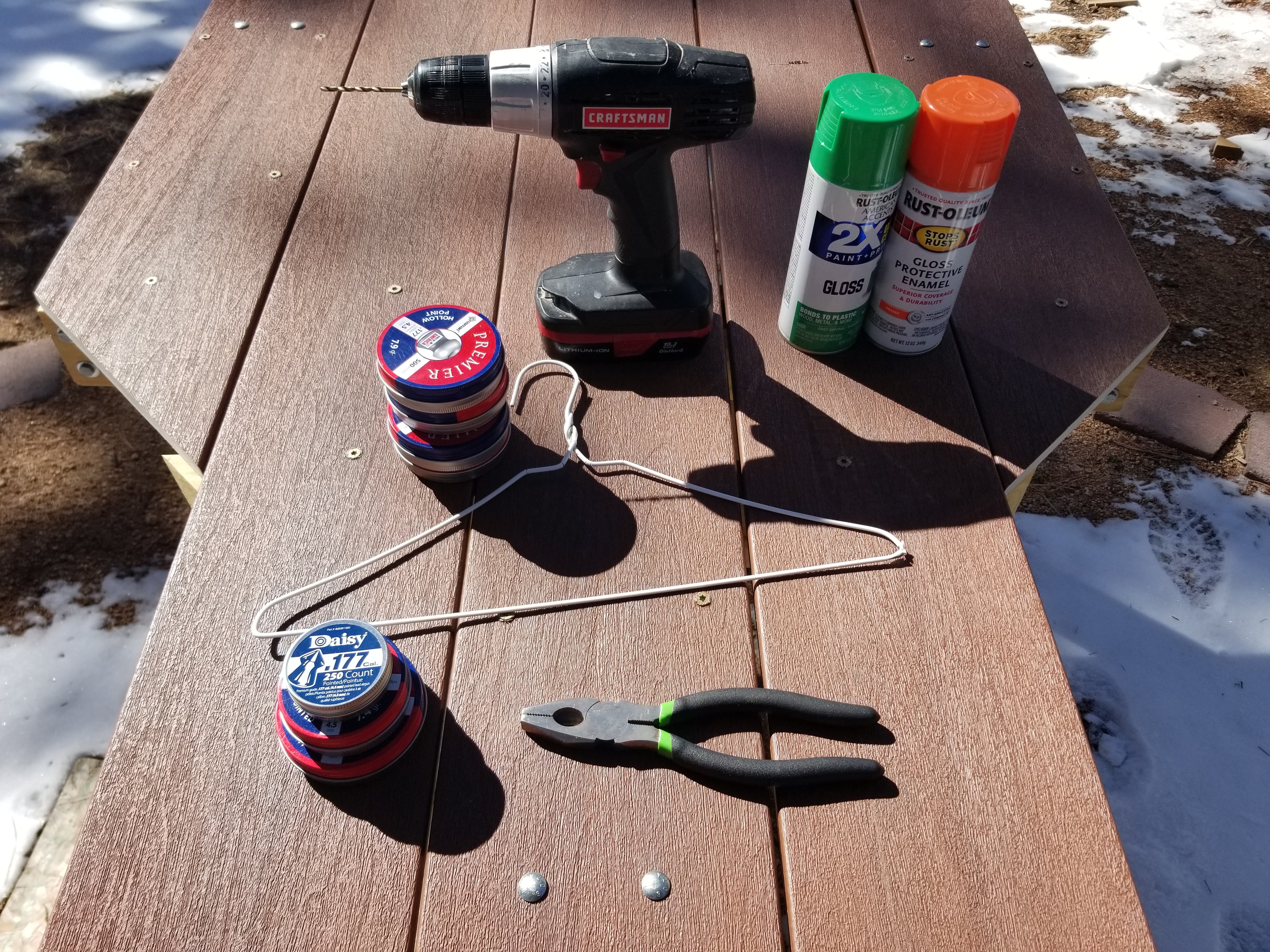

To do this, you will need some supplies that you should have laying around:
  • Empty Pellet Tin(s)
  • Wire Coat Hanger
  • Plastic Straw
  • Small Tie-Wraps
  • Spray Paint
You'll need a few basic tools:
  • Drill with bits
  • Pliers with wire cutters
  • Razor Knife
  • Scissors
Basic Supplies:

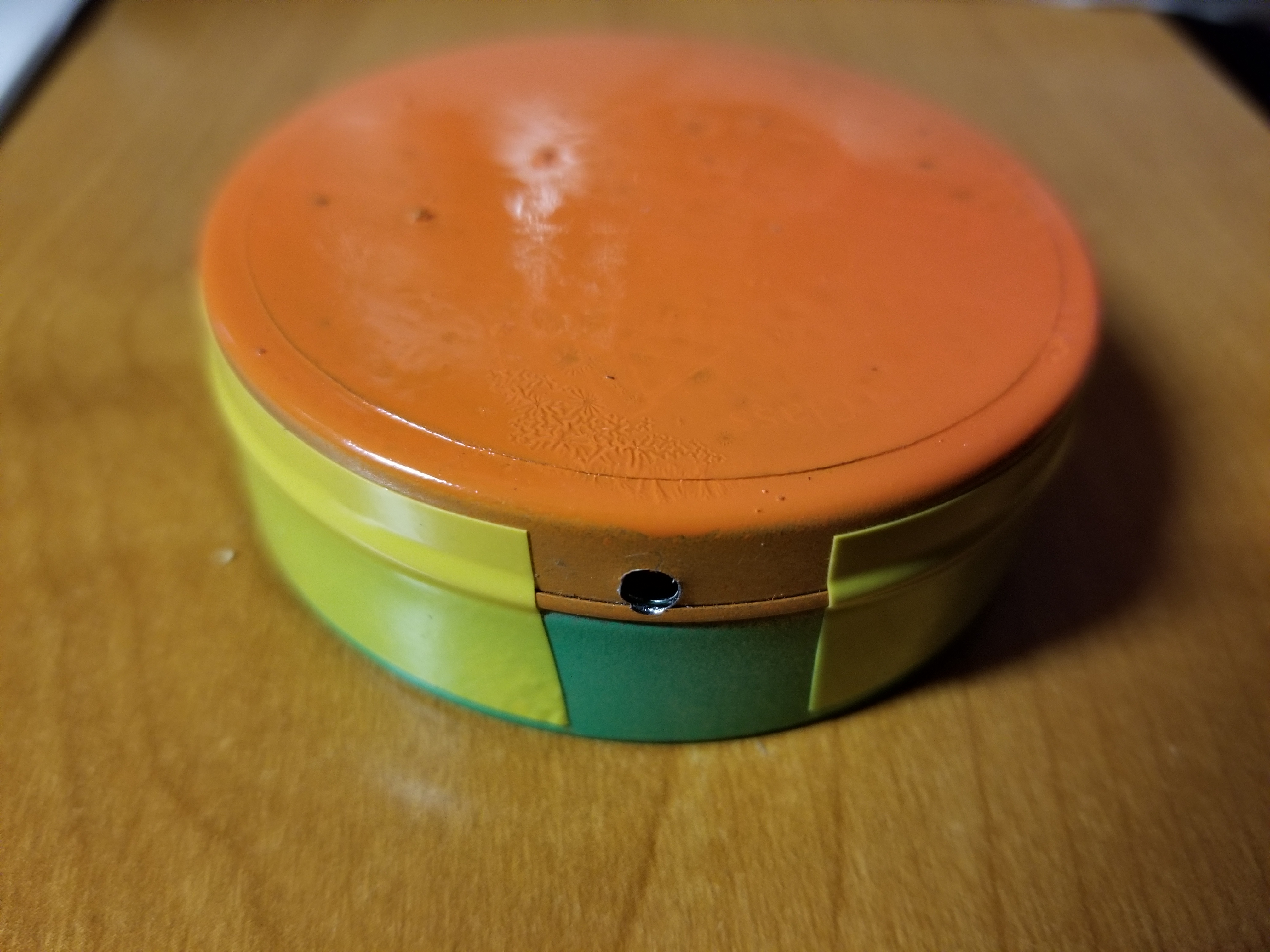

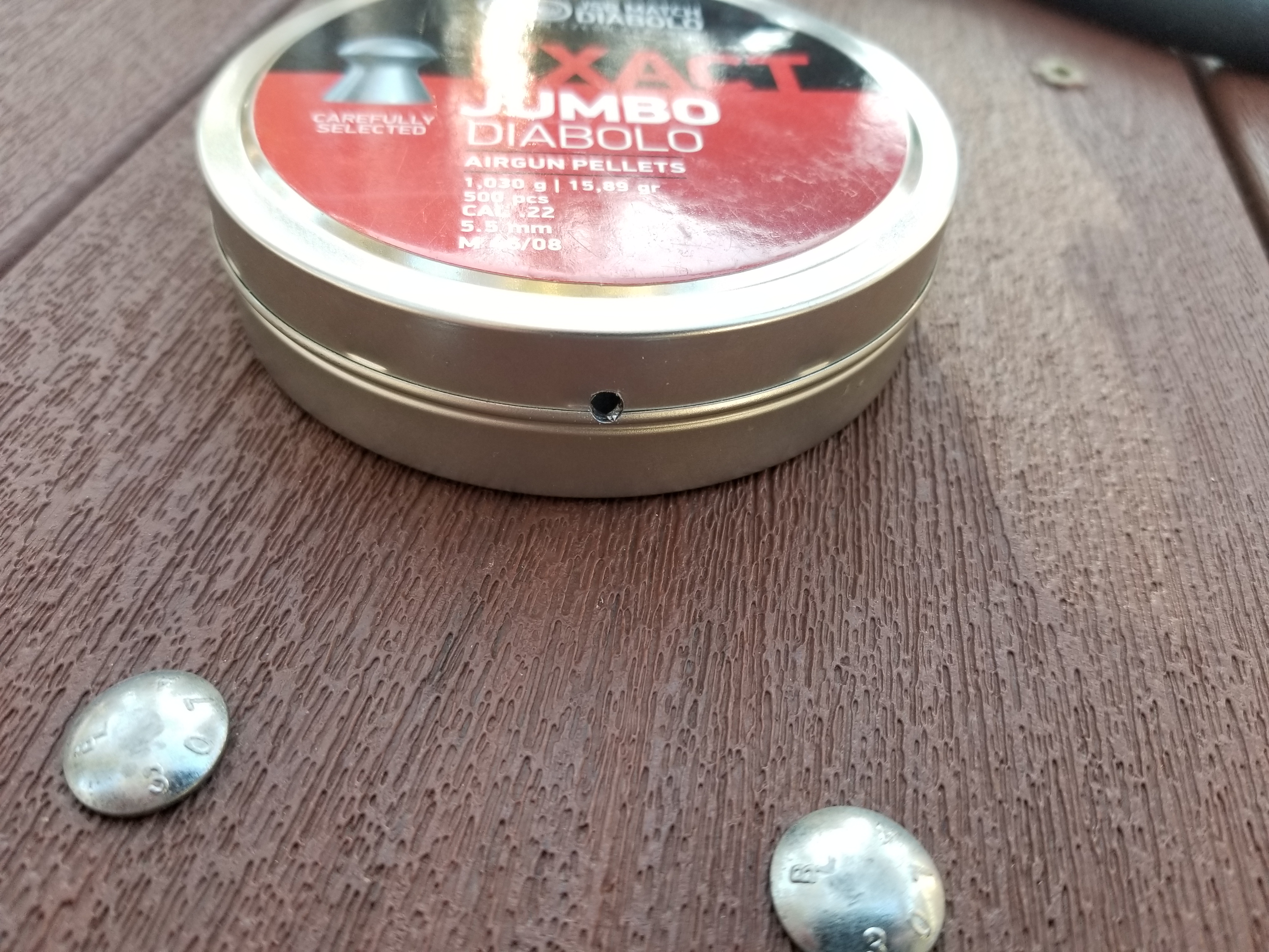

You drill holes just bigger than the diameter of the coat hanger at opposite ends of the pellet tin. Note that there are "crimp" marks on the JSB and FX tins that are exactly symmetrical, so you can use those as a guide as where to drill the holes to make sure that you are symmetrical. Here is a hole drilled in that crimp mark:

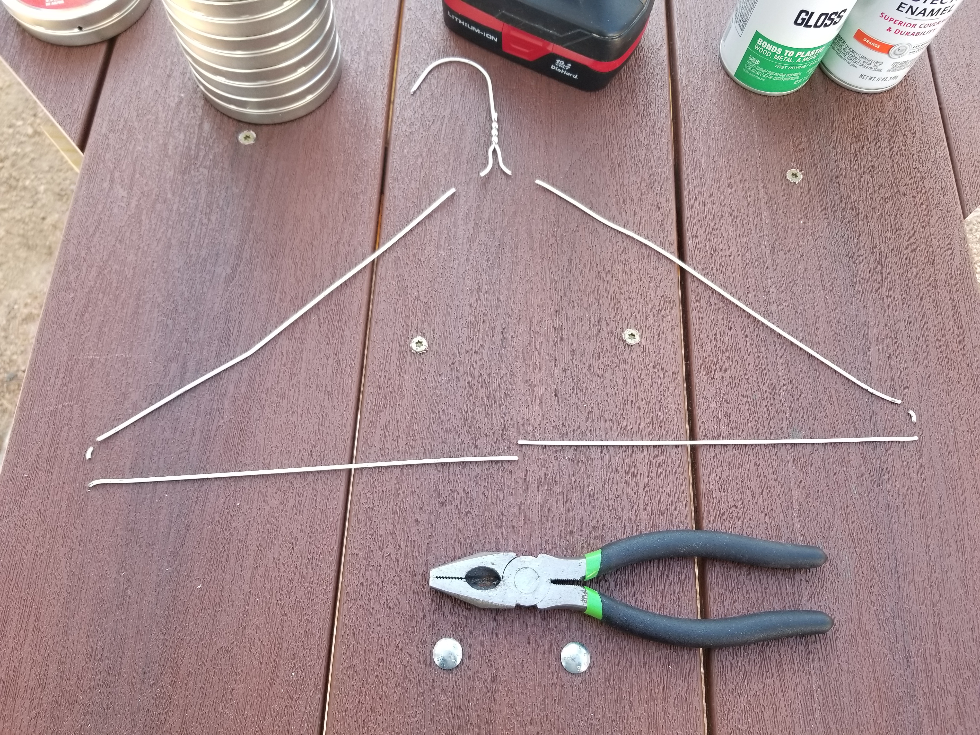

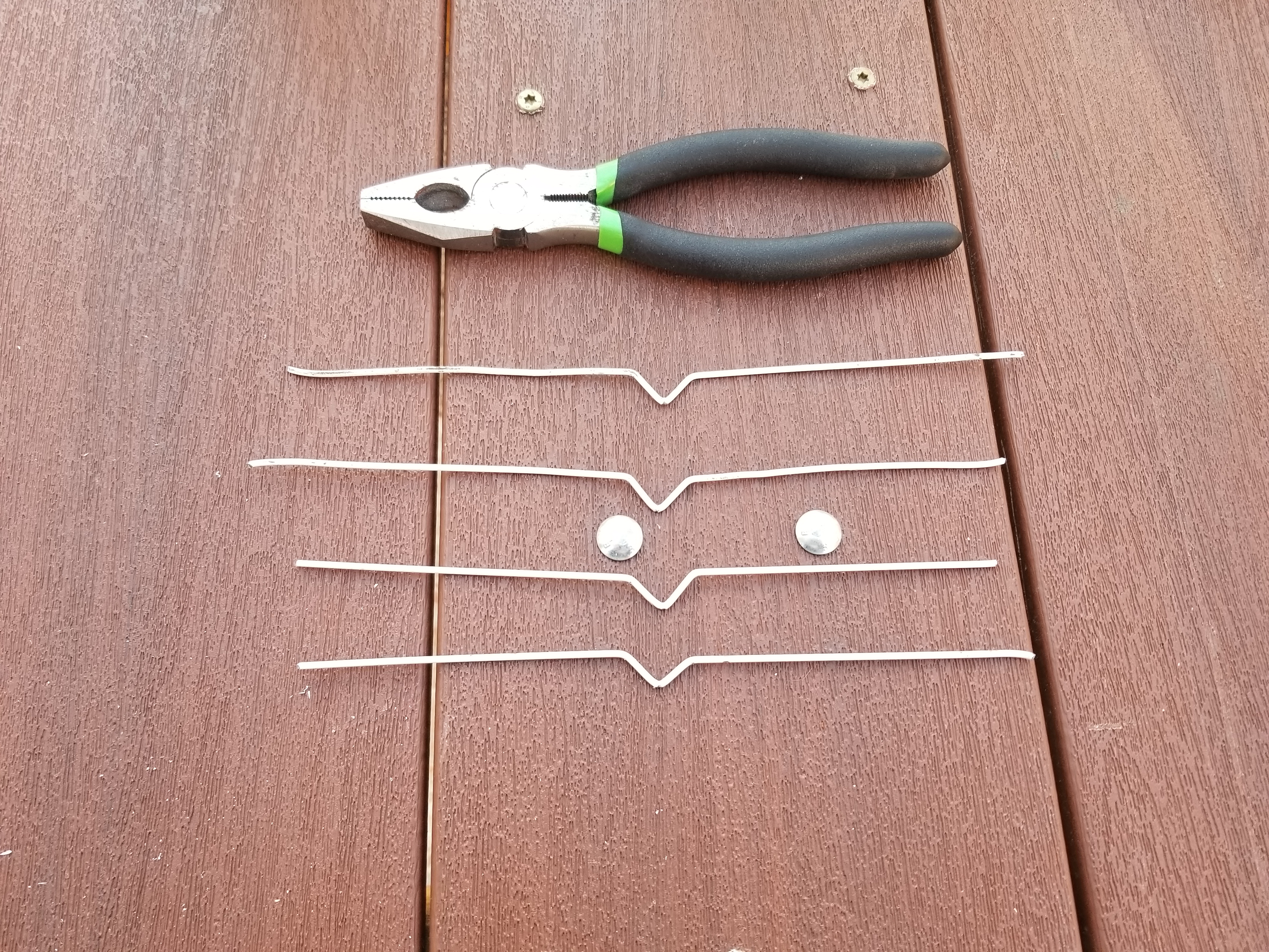

Cut the coat hanger into four pieces as shown:
Use the pliers and put two 45degree bends and one 90 degree bend in the center of each of the straight pieces of coat hanger as shown:

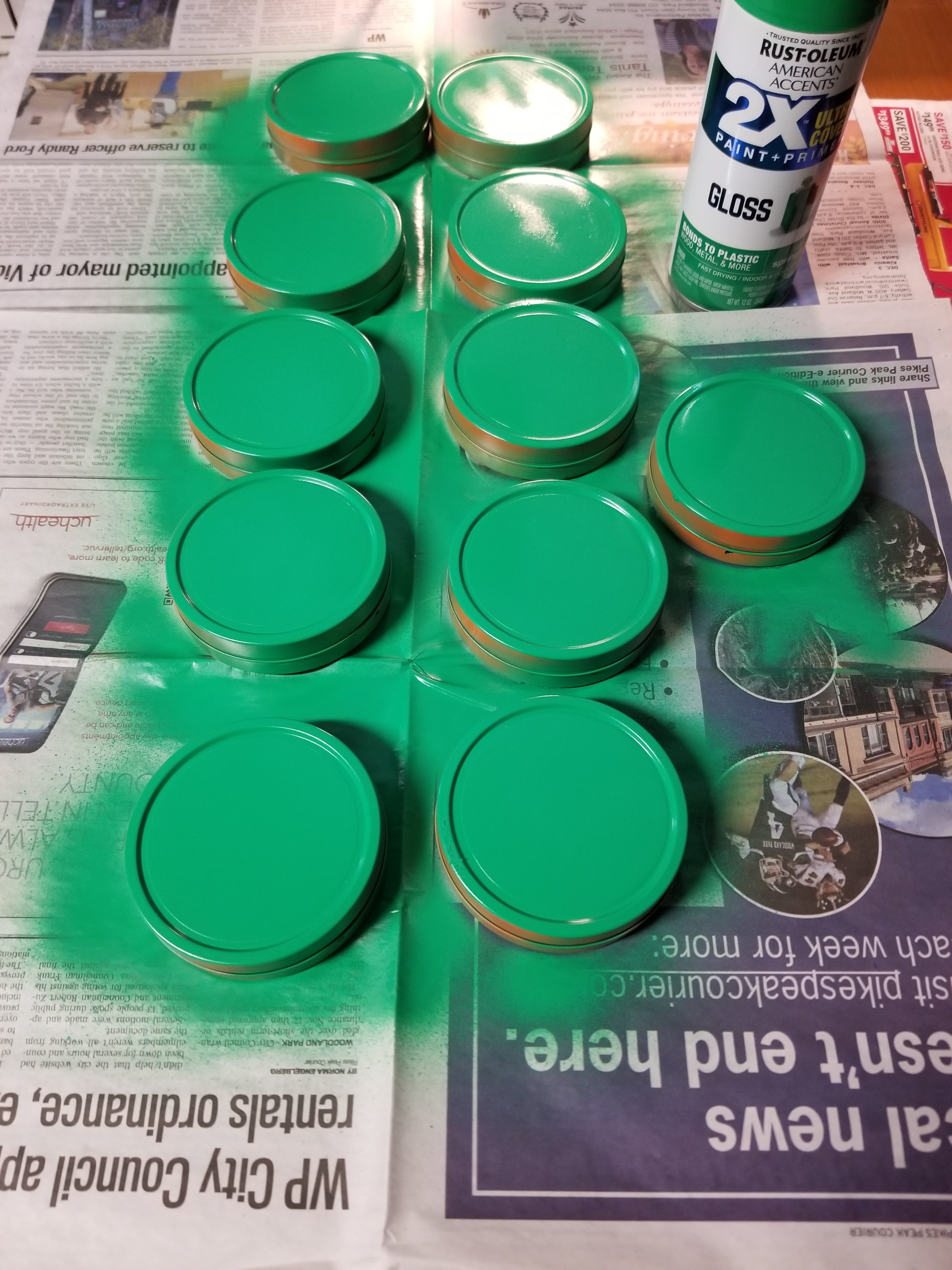

I painted the front and back of the tins a different color so that they will look cool when spinning:

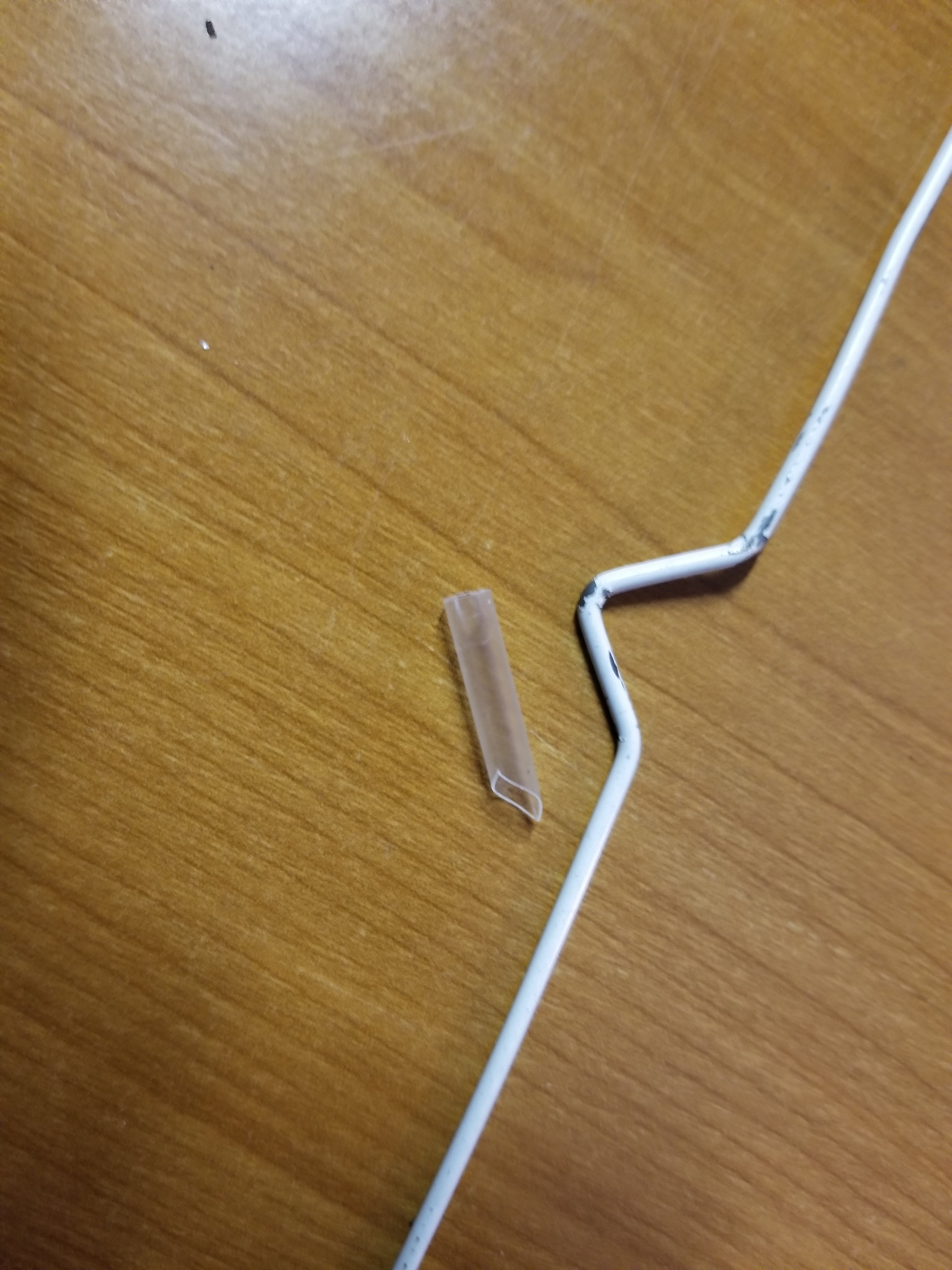

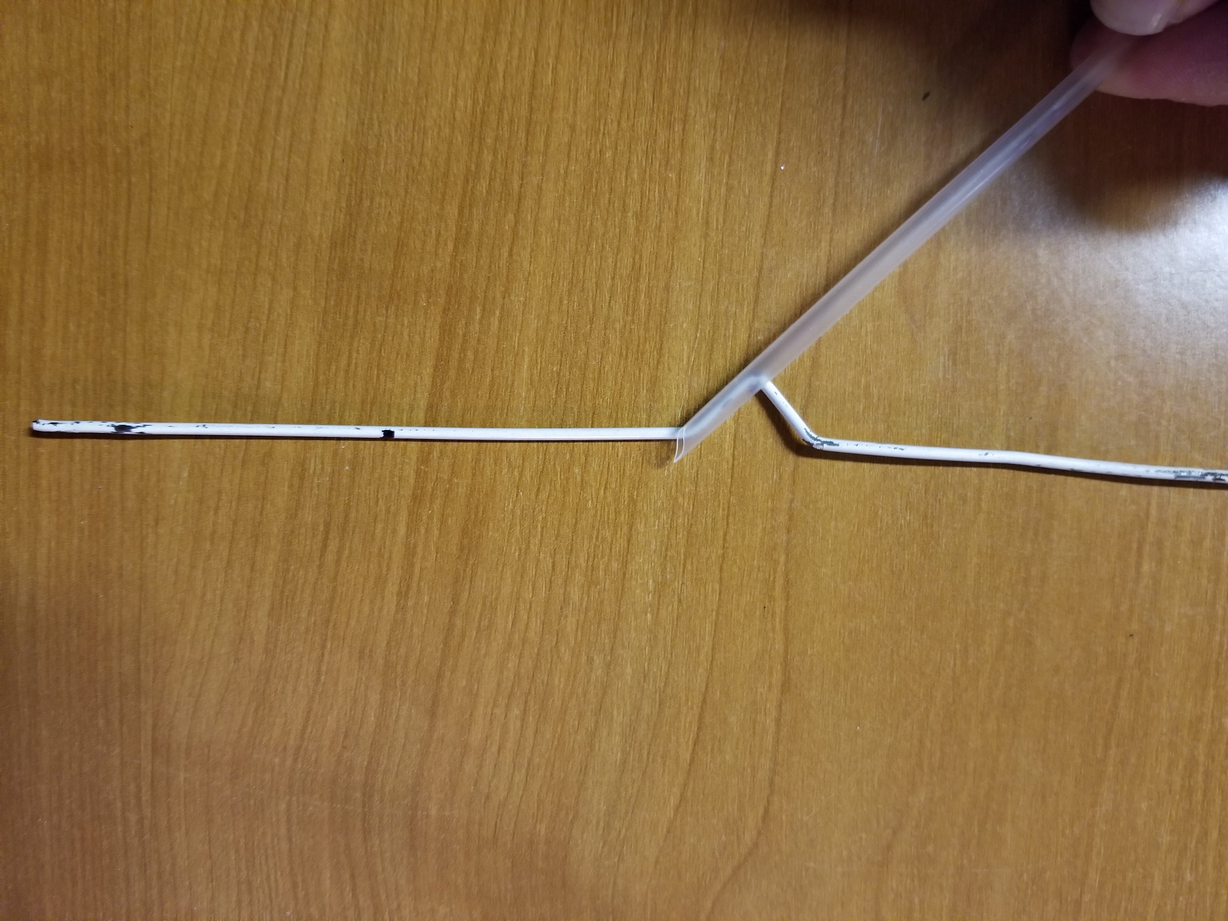

If the pellet tin just spins in the hole by itself, it will get stuck, so I used a straw as a spacer to keep it above the bend in the wire. This also gives it a place to get "stuck" on the lip so that it will (hopefully) rotate to the same spot. I used a small straw from a juice box, but a regular straw should work too:
Measure it so that the angle is facing up, and it will just stick barely above the bend in the wire as shown:
Cut it to length:

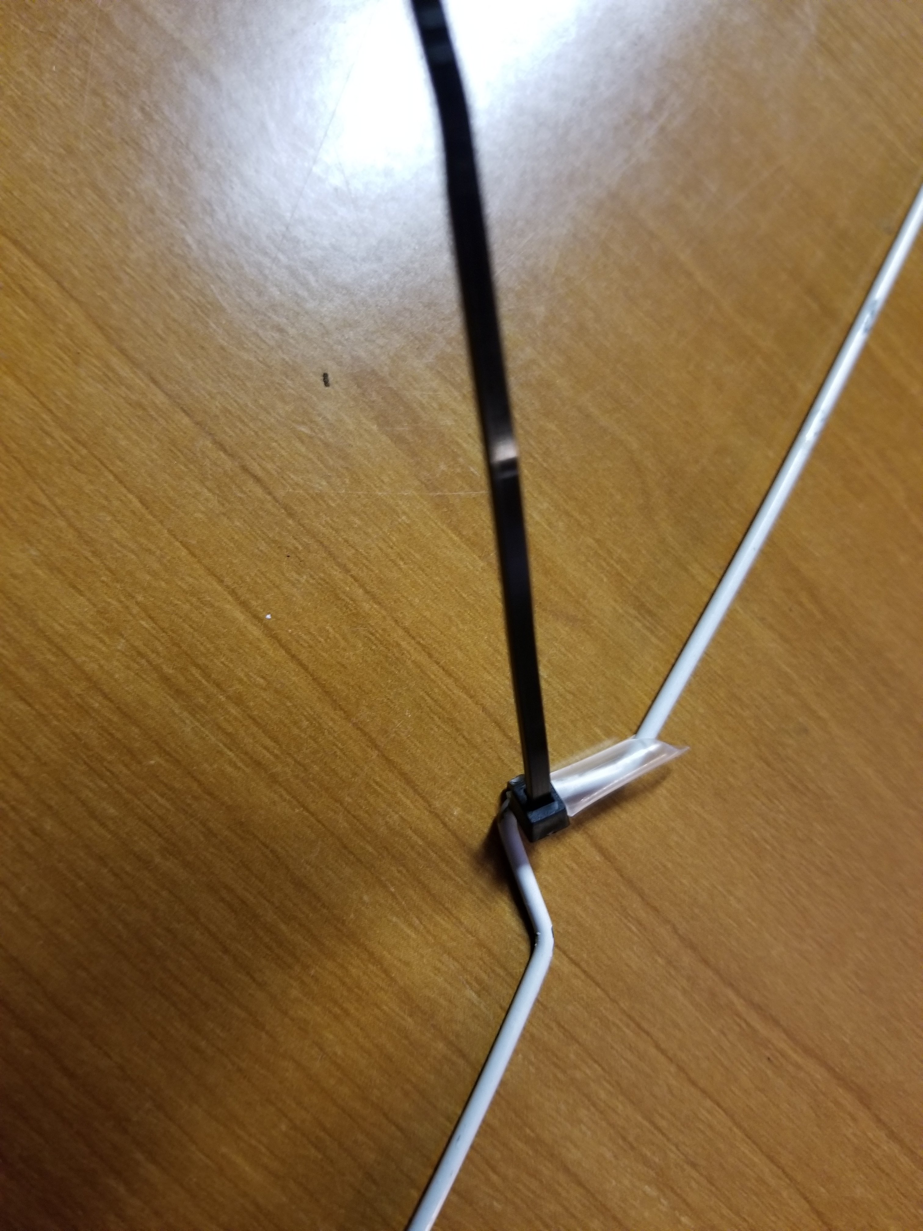

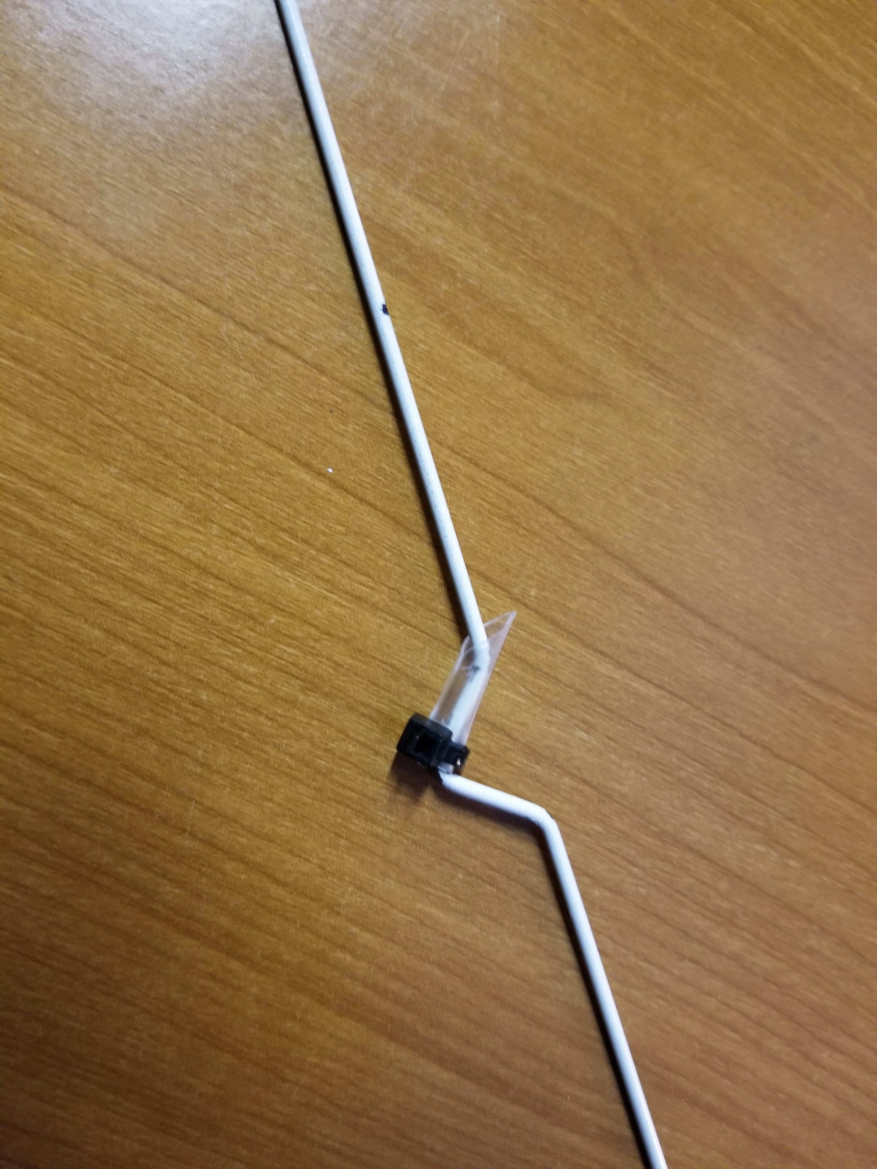

Take your razor knife and put a small (~1/8") slit on the short side of the 90 degree end of the straw as shown (This will give the tie-wrap a place to overlap the straw):
Wrap the tie-wrap around the end closest to the 90 degree angle to hold it in place:
To make it "brighter" I added some Yellow electrical tape on the outside, avoiding the drilled holes as not to "hang up" the spinning action:
The top of this post shows the target at this point once you insert the painted tin onto the wire hanger.

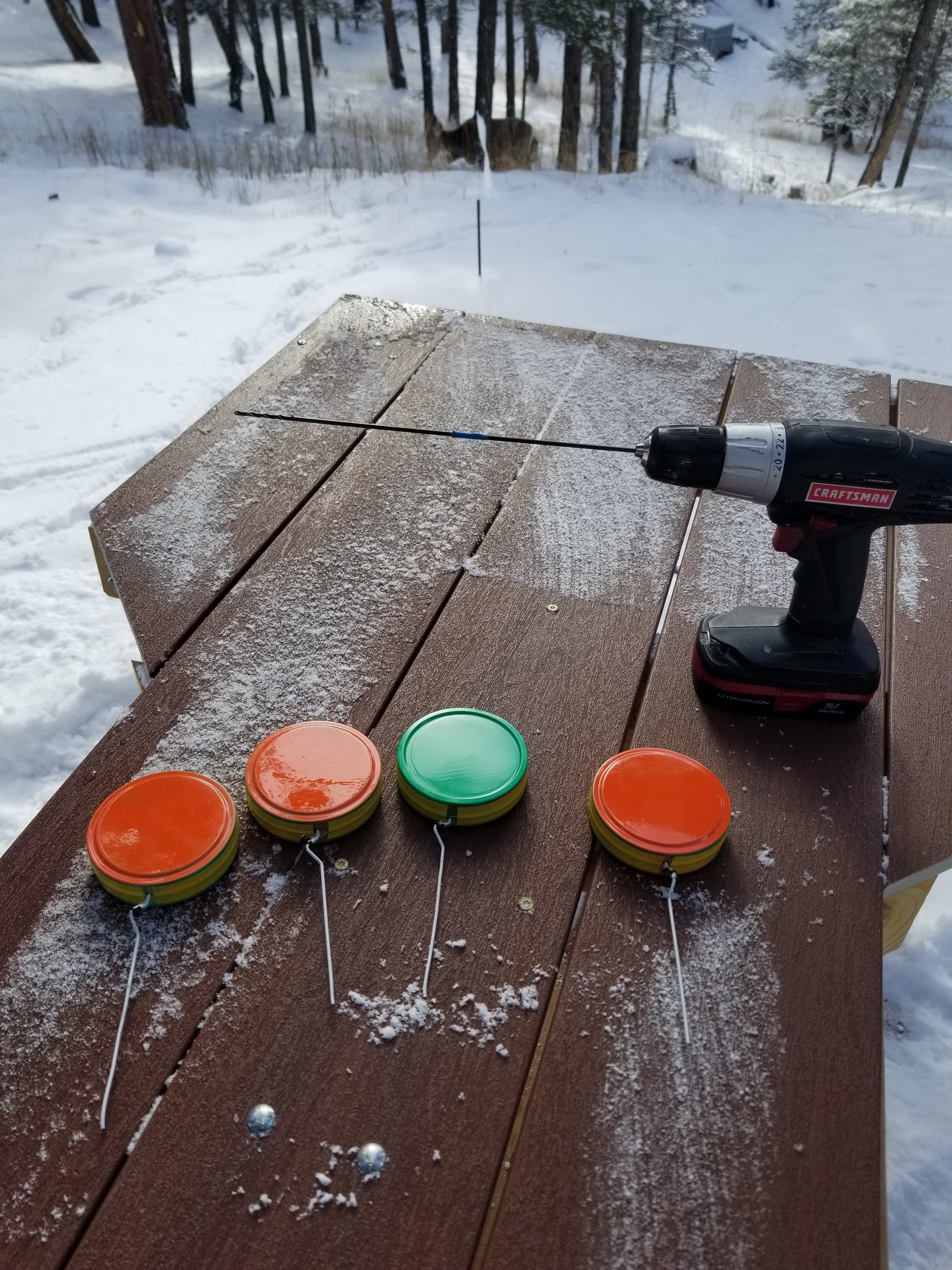

How take a drill with a big bit out

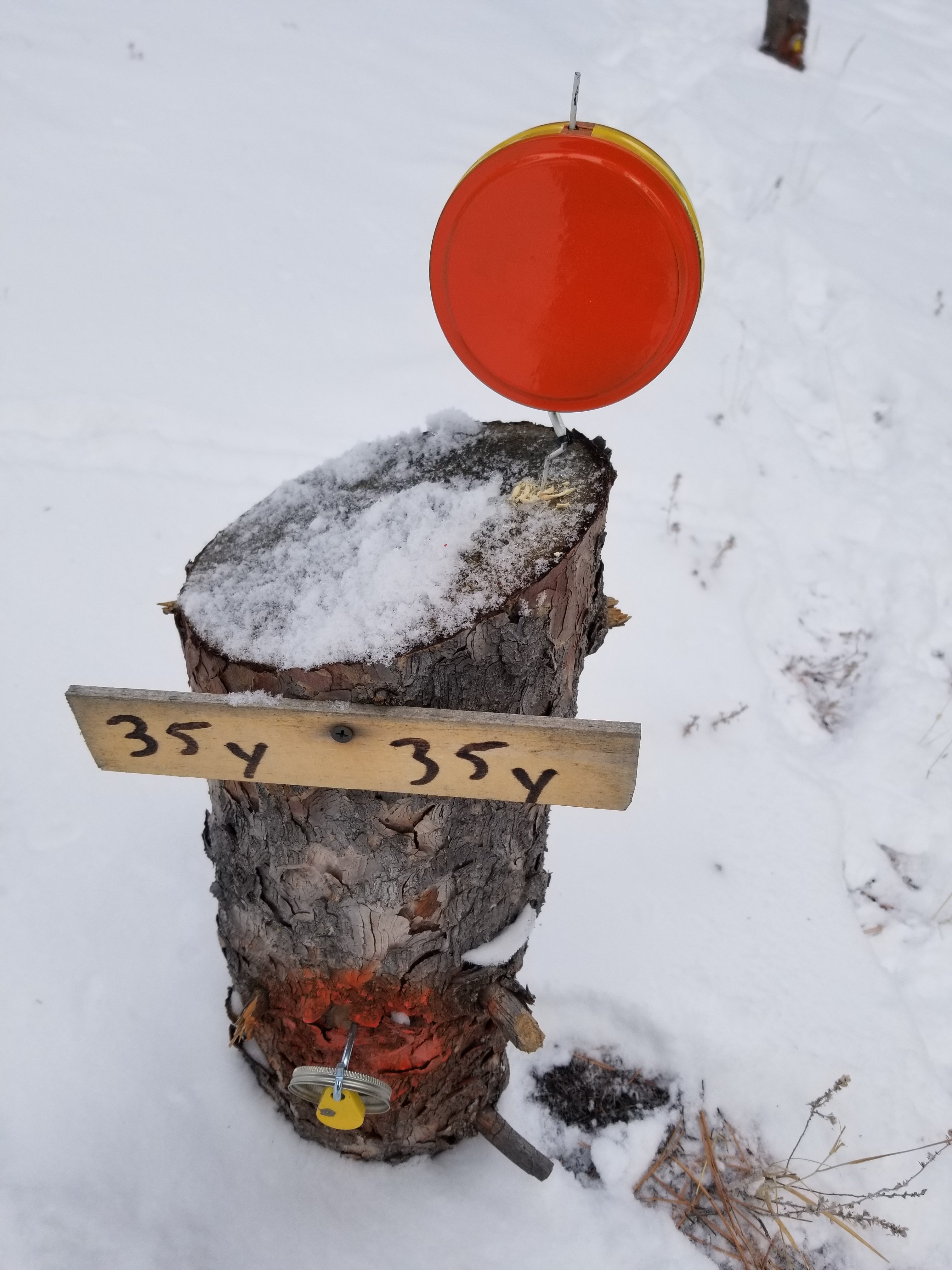

Now drill some holes in scrap wood and insert the target, making sure that nothing will be in the way as it spins:
Finally, here is a video of me demonstrating the targets in the freezing cold:

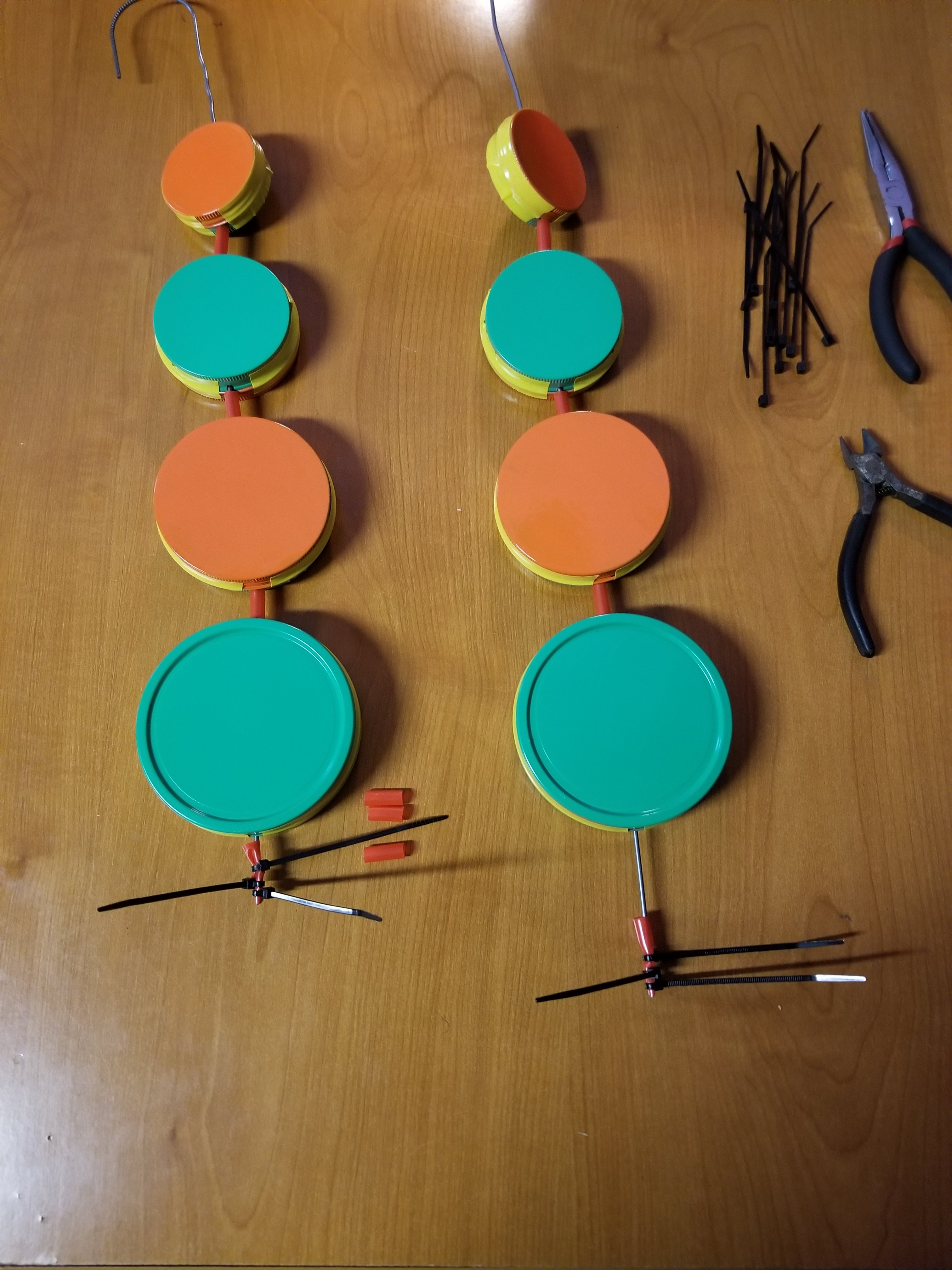

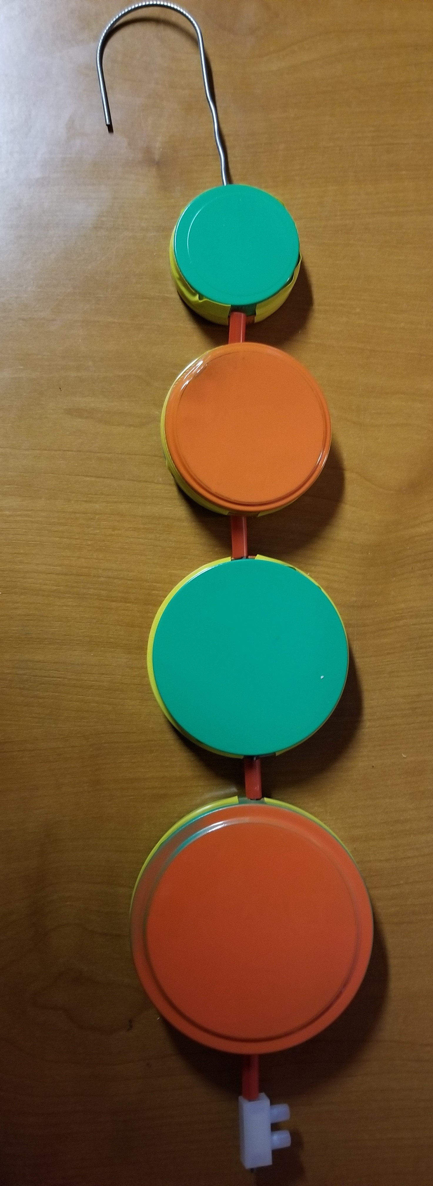

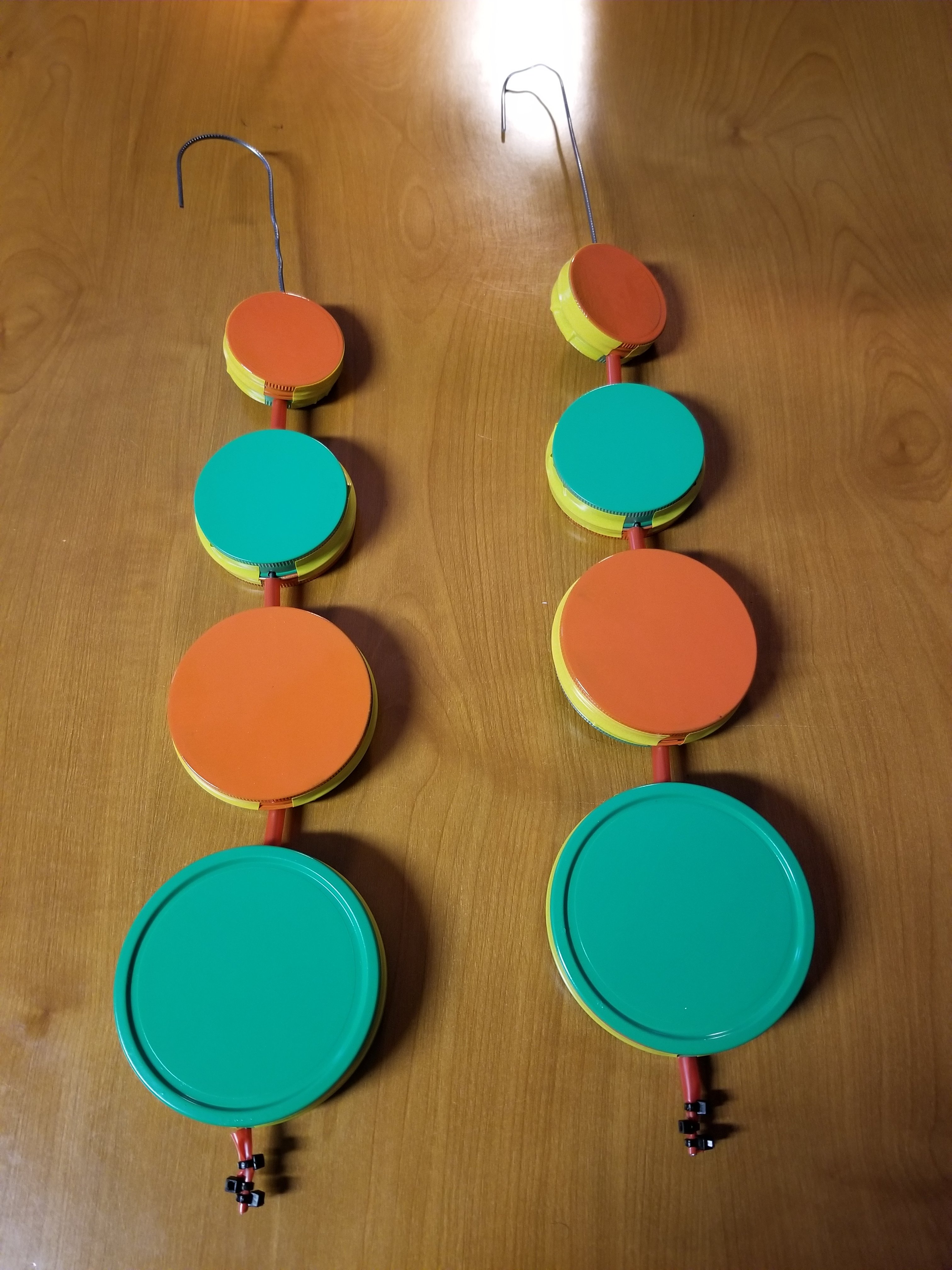

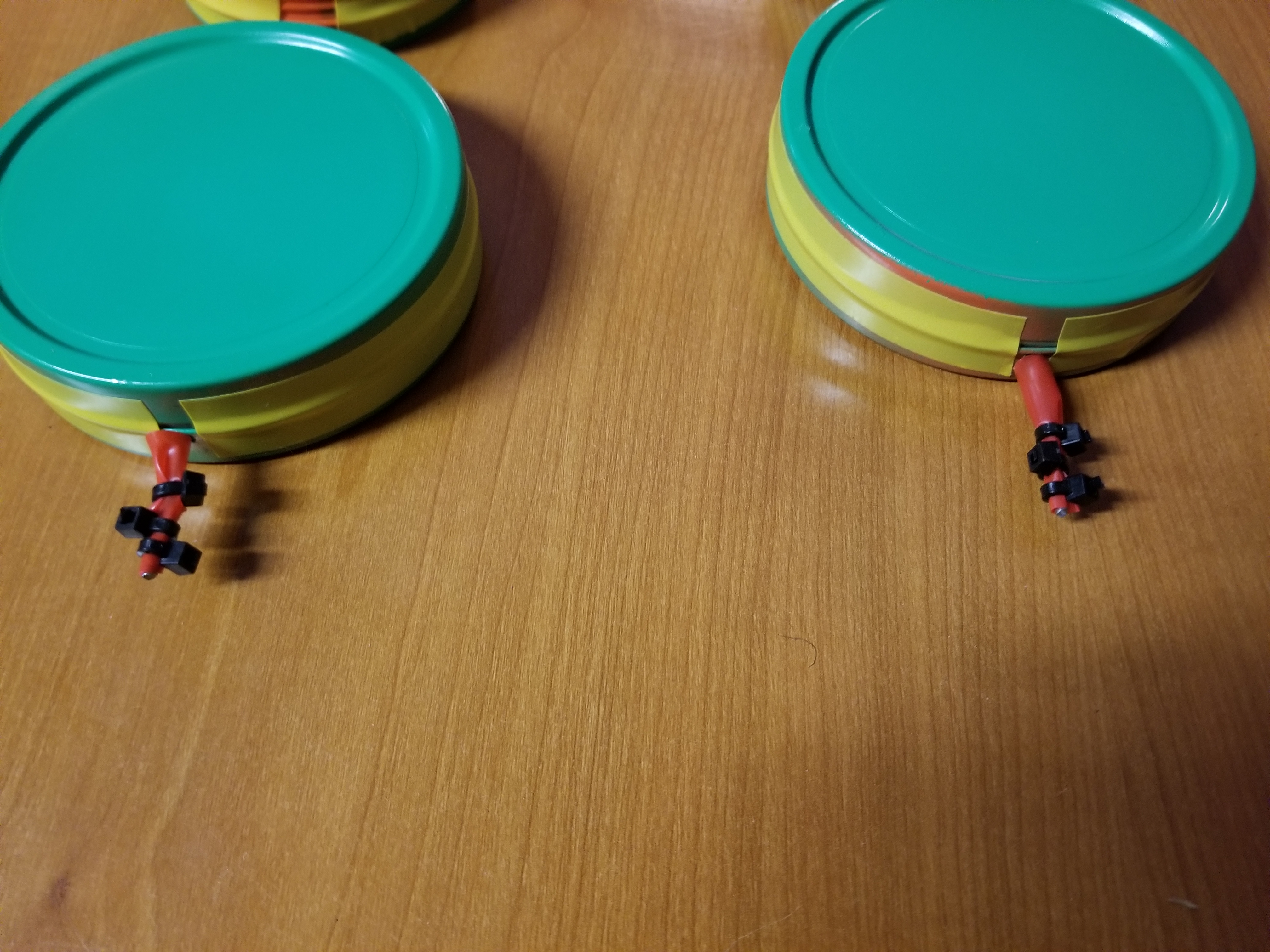

Theory, I modified the design of the spinners so that they will be hanging. Here is how the finished product looks now:

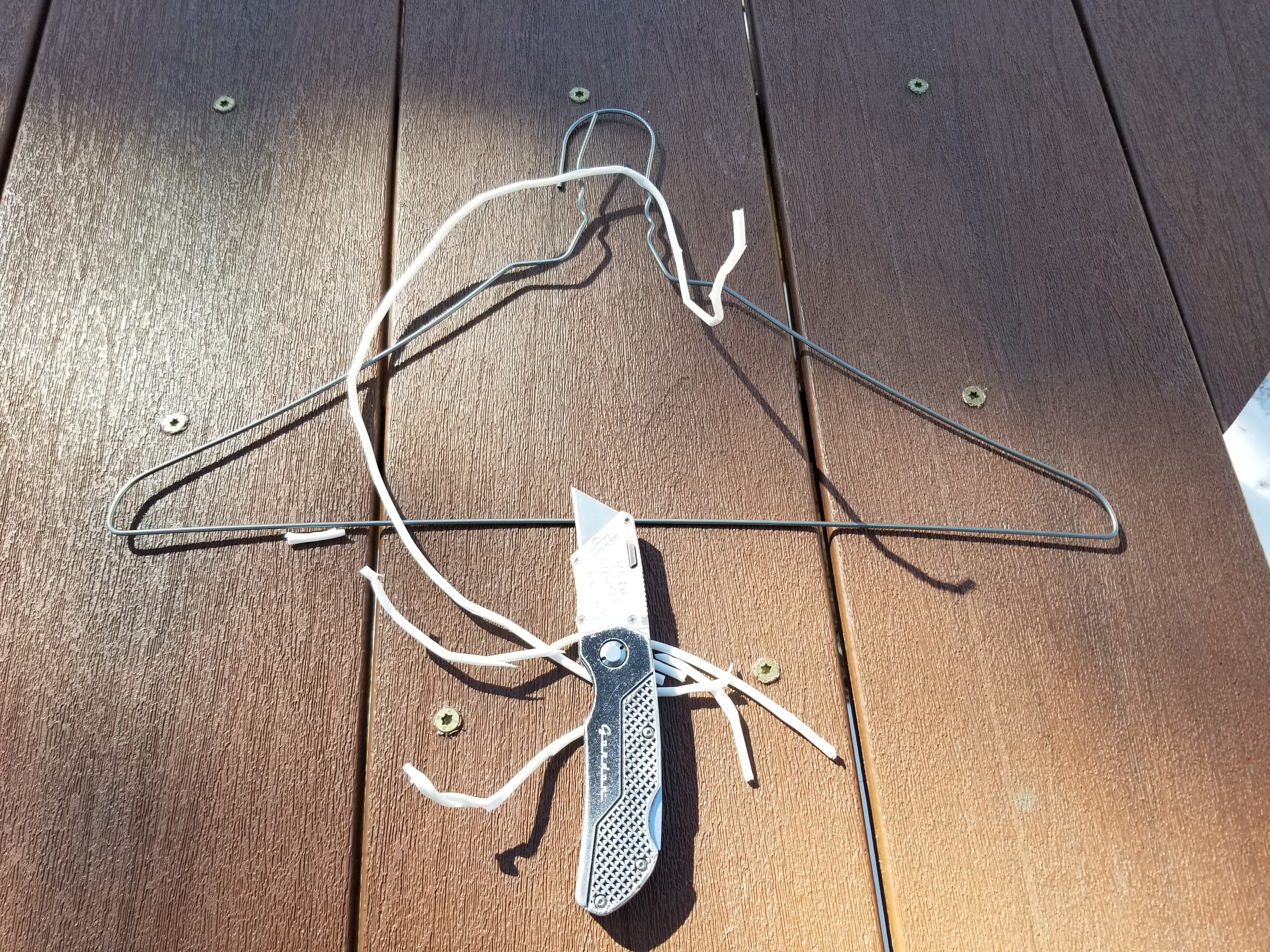

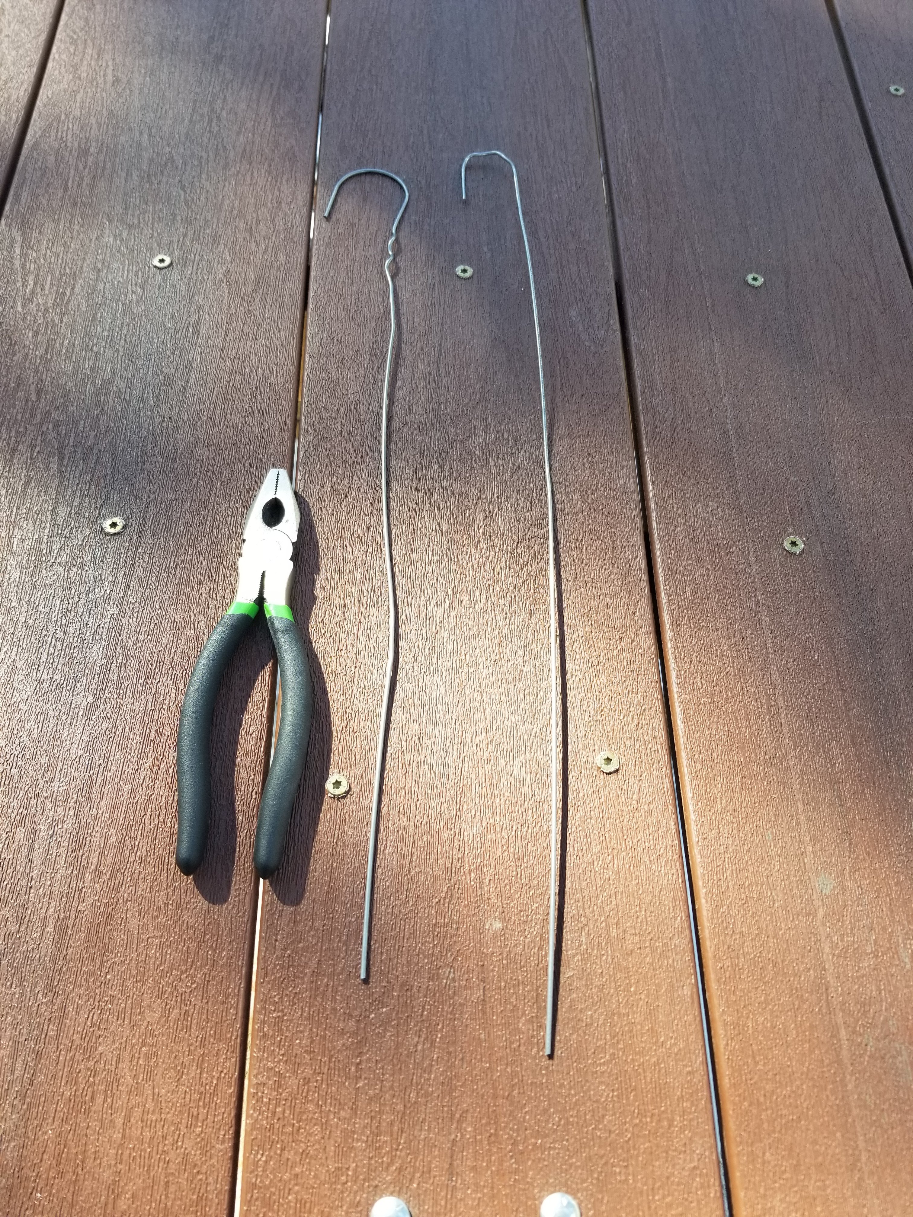

To start us off on this revision, here are the fundamental tools:
Note that this coat-hanger is more like the "modern" coat-hangers that you may encounter in that they have a plastic coating around the wire that sucks. It break and cracks all over the place and is generally "ugly", so I had to use a razor knife to get it all off of there. Here is a look at the carnage:
Finally I cut the coat hanger basically in half and put a hook at the other end:

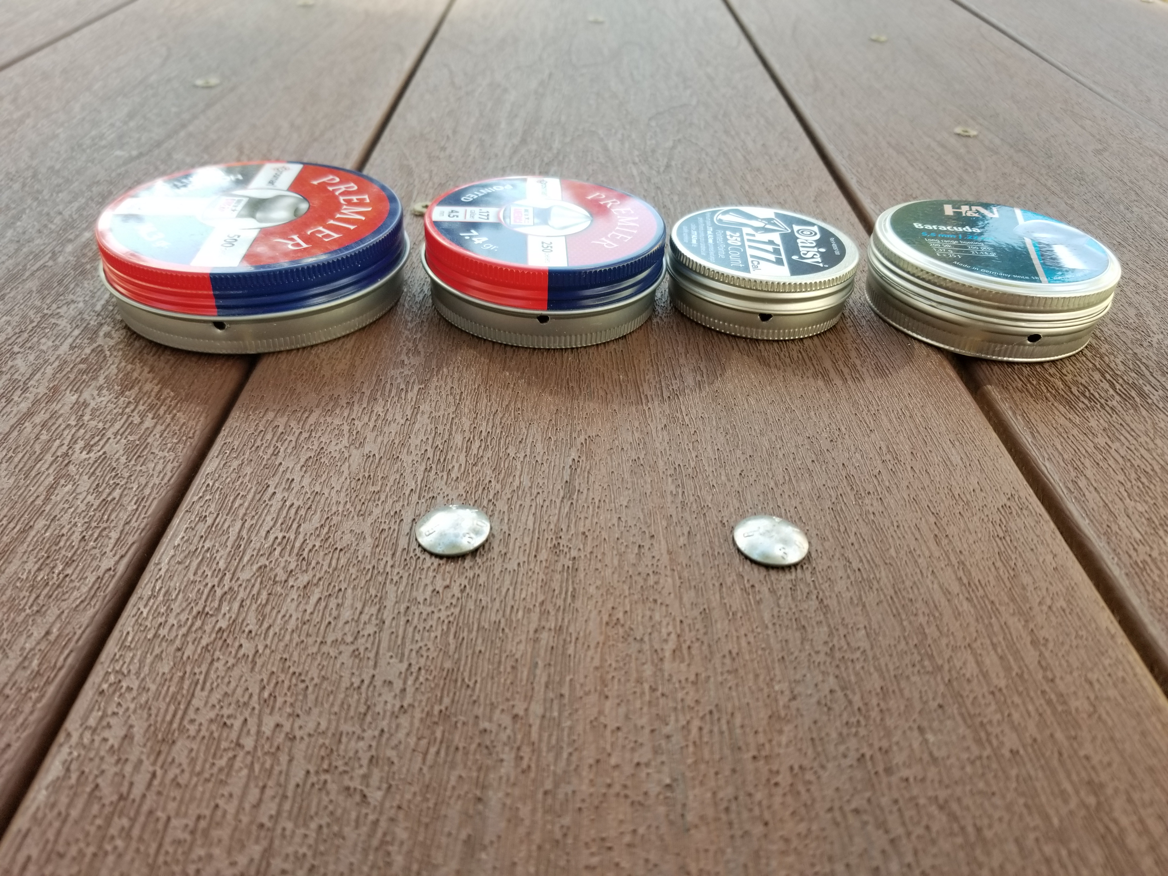

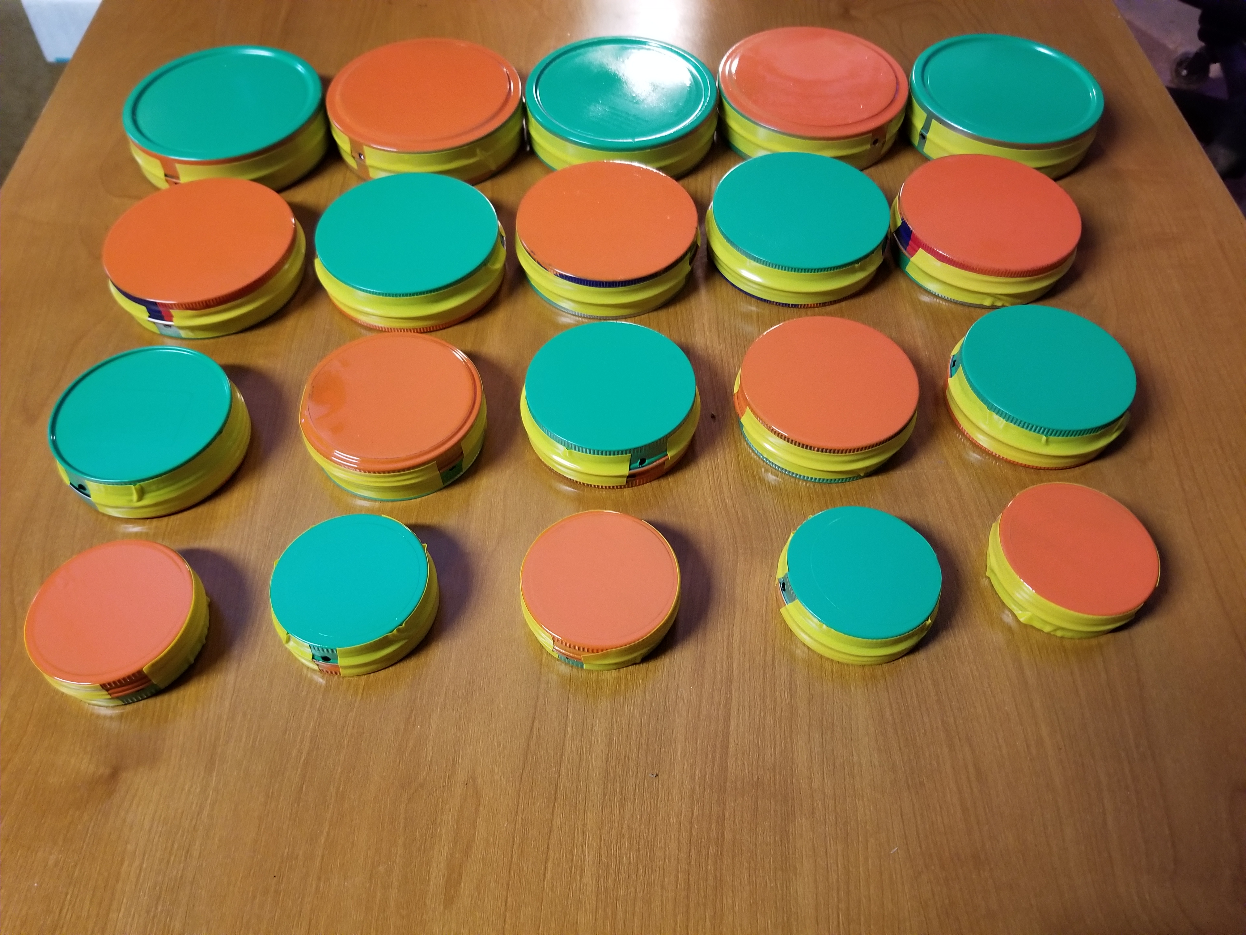

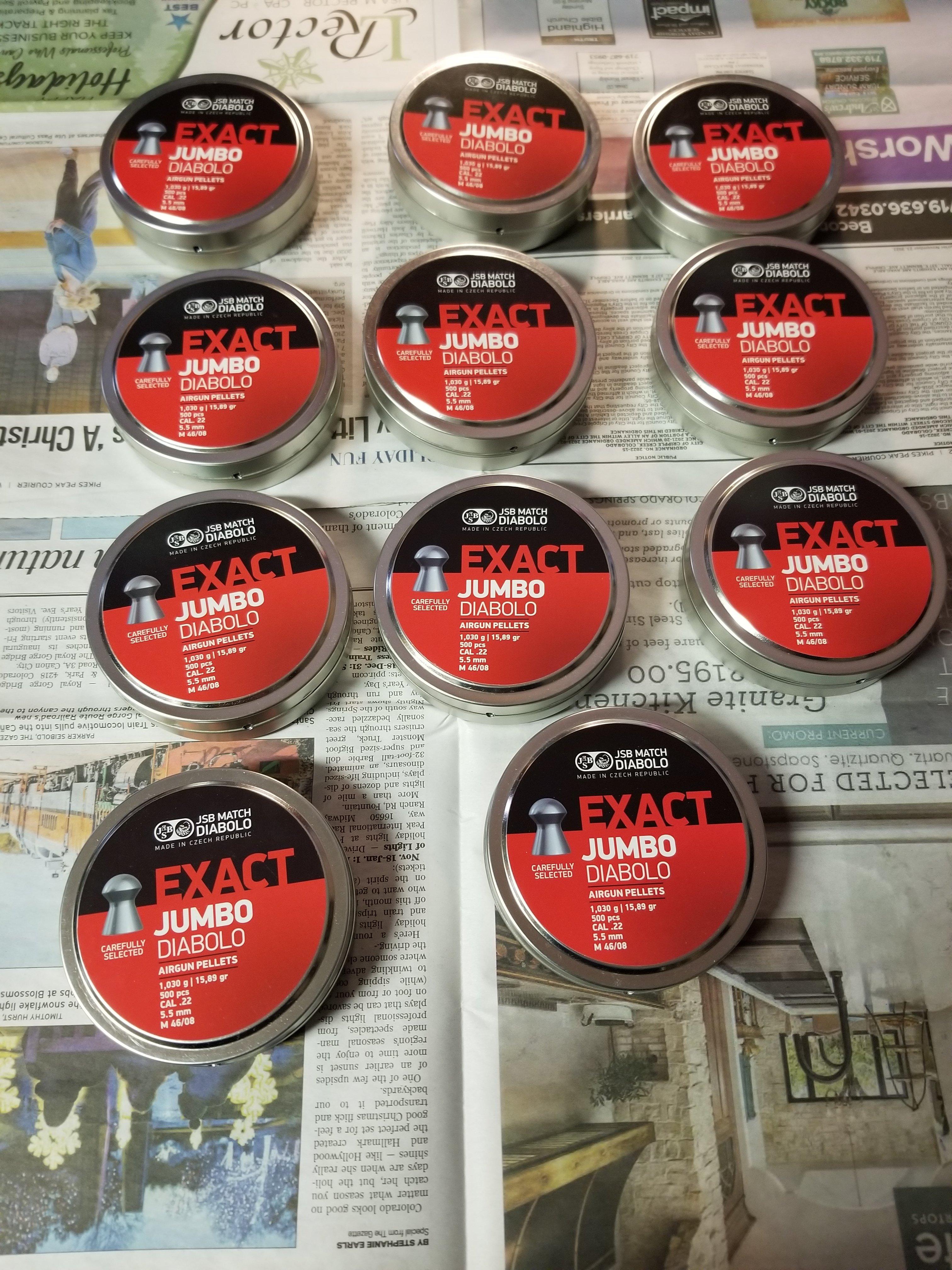

For reference, The Crosman tins have a Red/Blue color-band that marks the exact diameter of the tin. The Daisy tins have a white line across the middle to give you some reference. The H&N don't give you a clue what-so-ever, so good luck getting those exactly centered unless you want to go through a good bit of trouble.

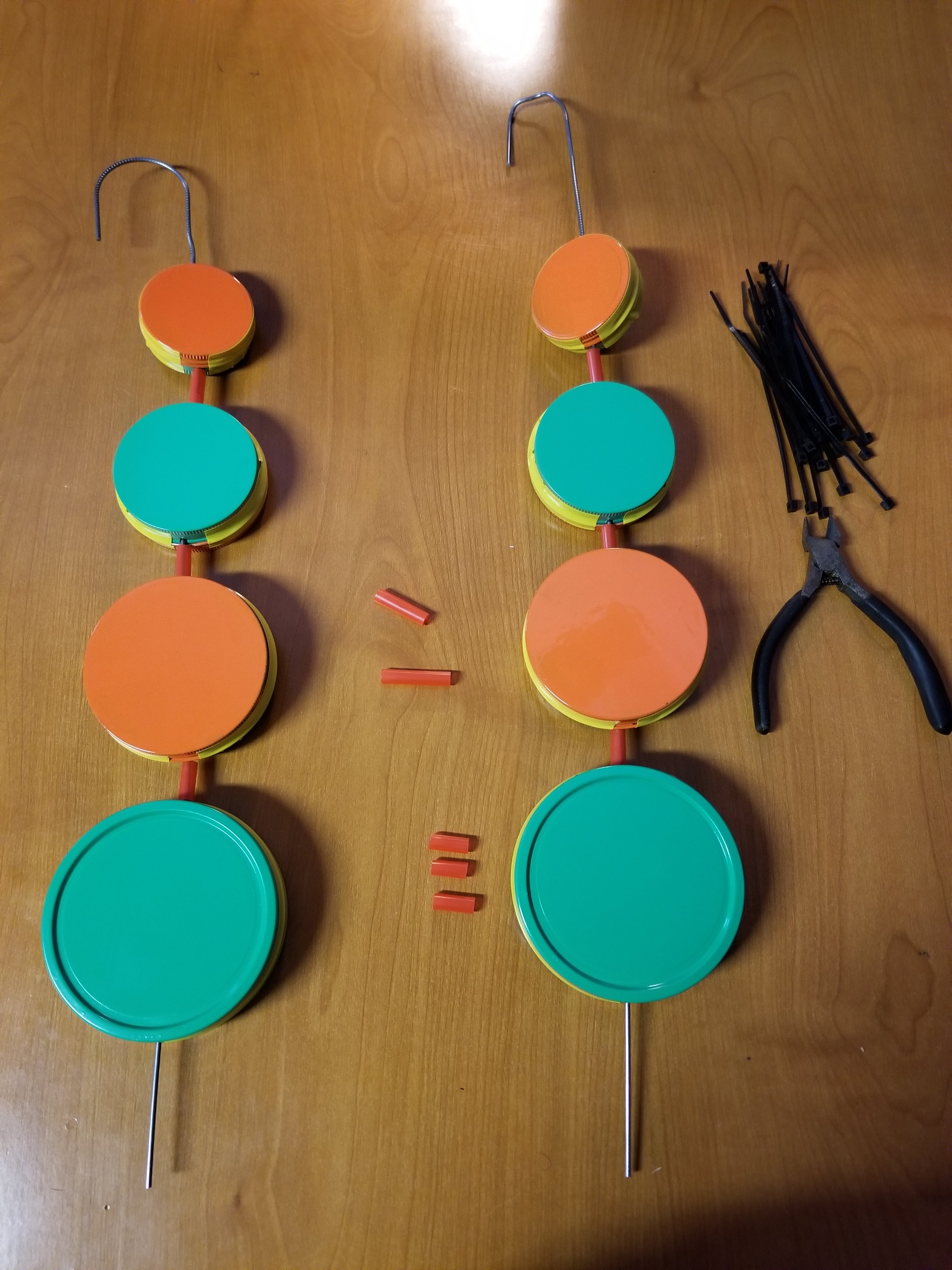

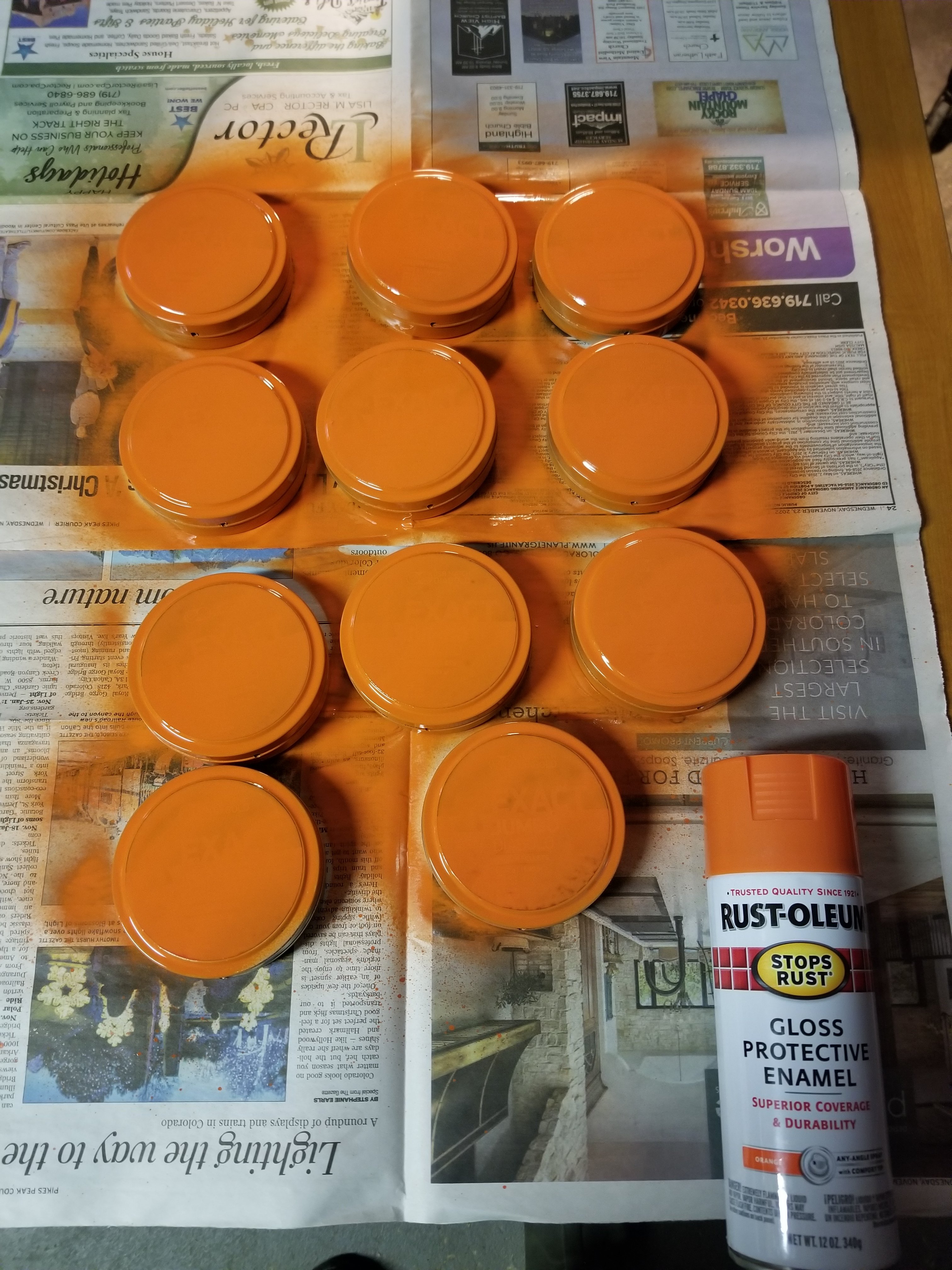

I painted and taped multiple size tins to give the following:

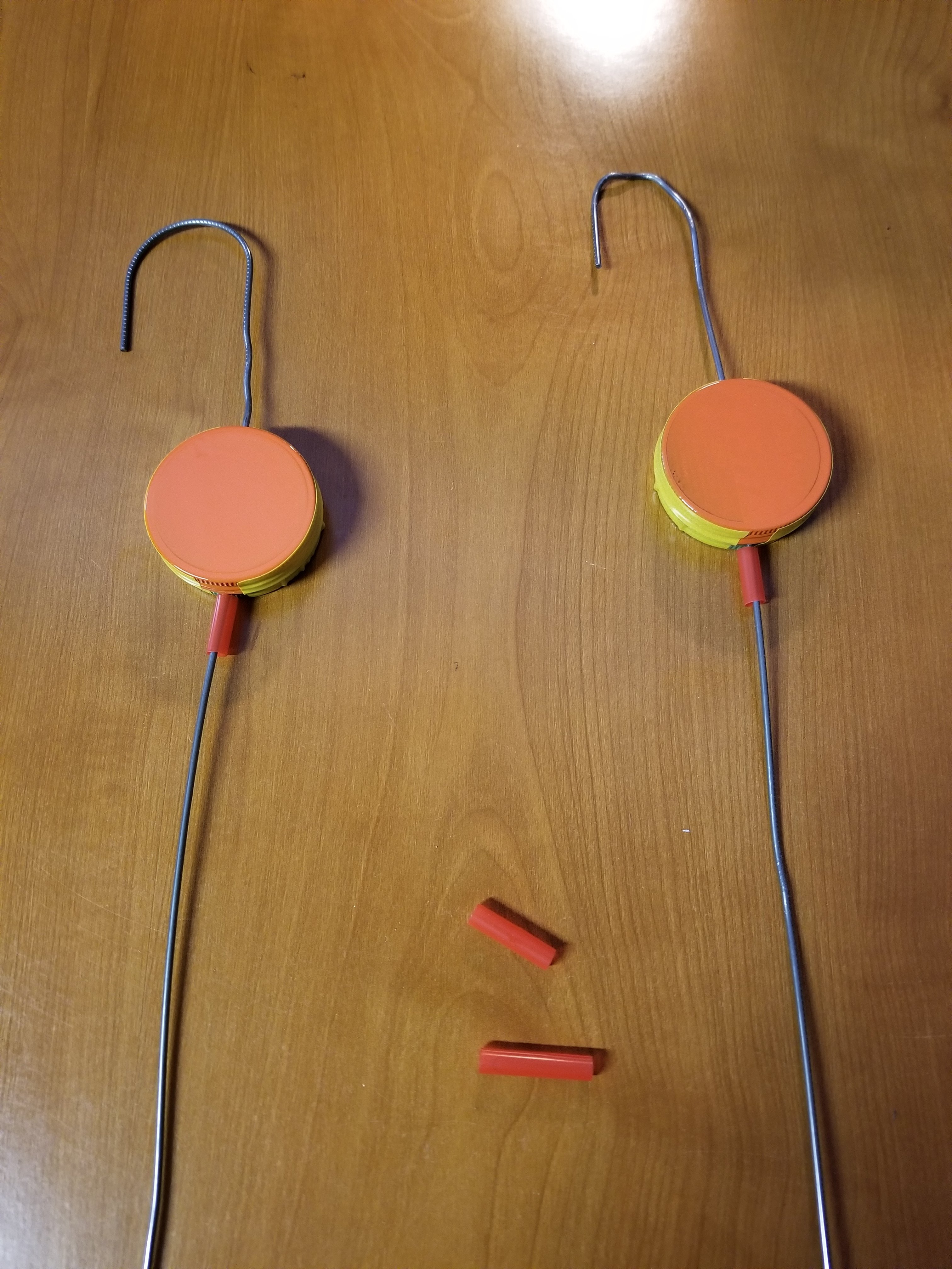

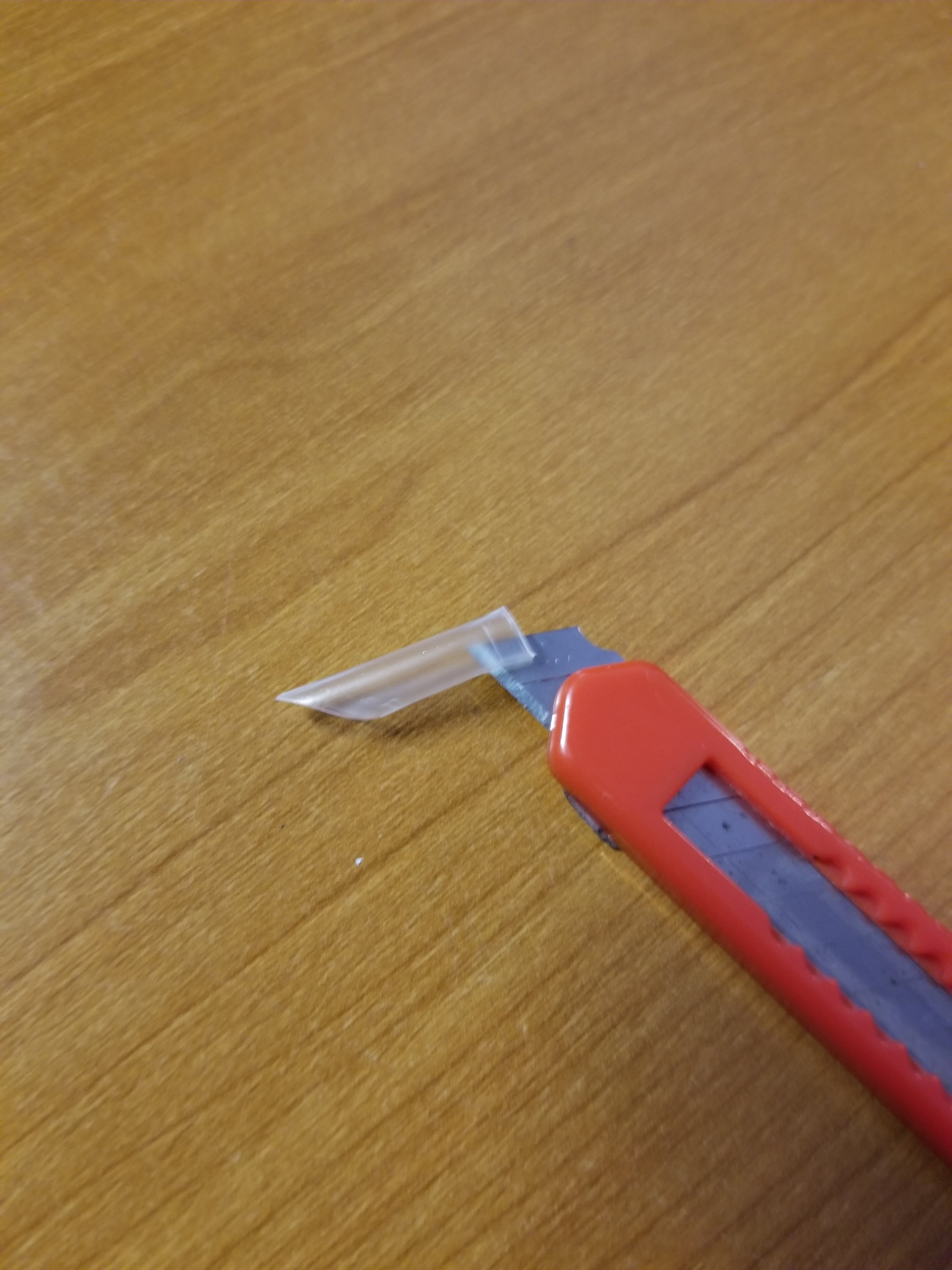

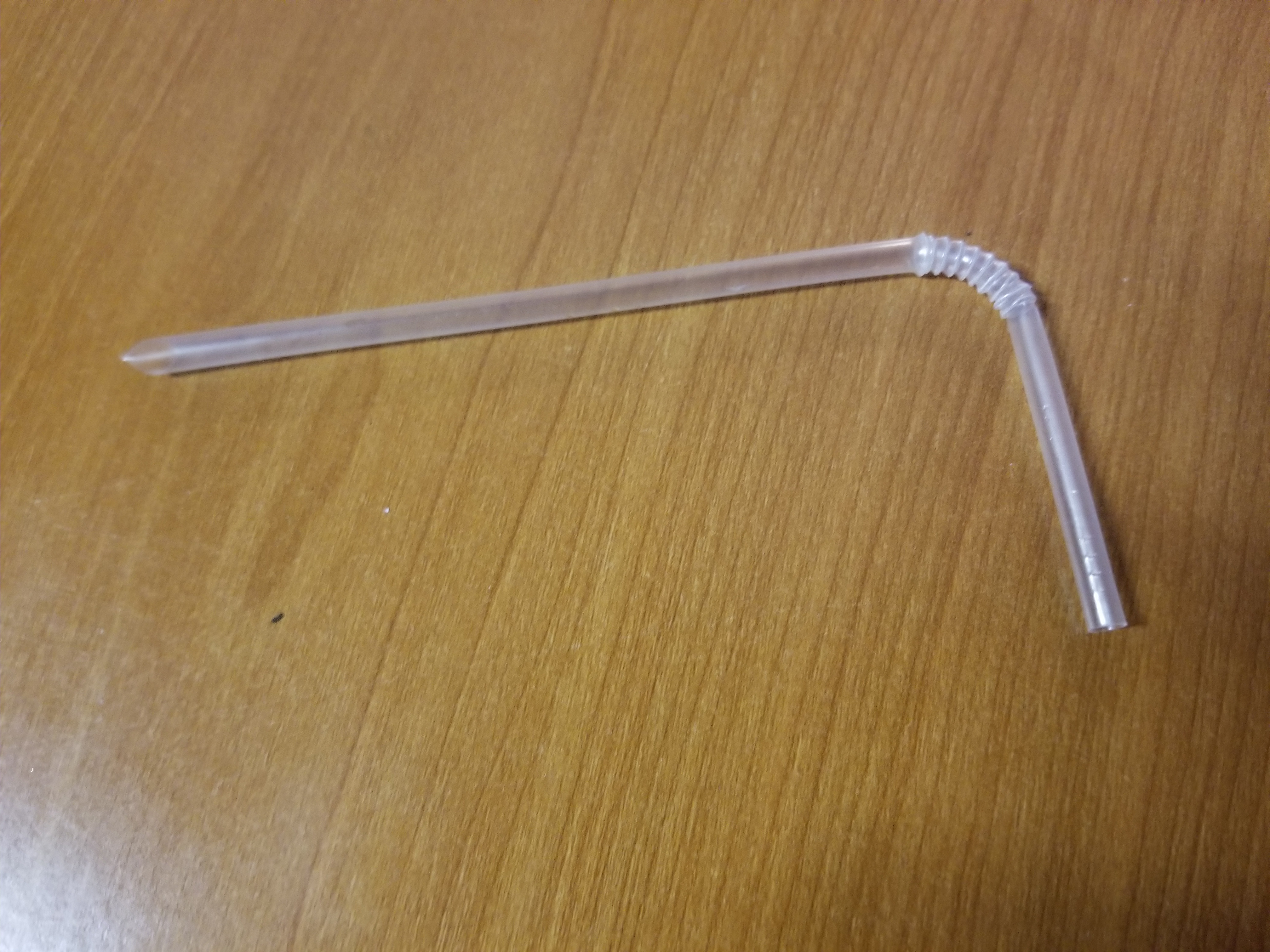

I took a straw and cut it with scissors. I cut about 1" lengths for the bottom, and about 1/2" lengths for the spacers between the tins:

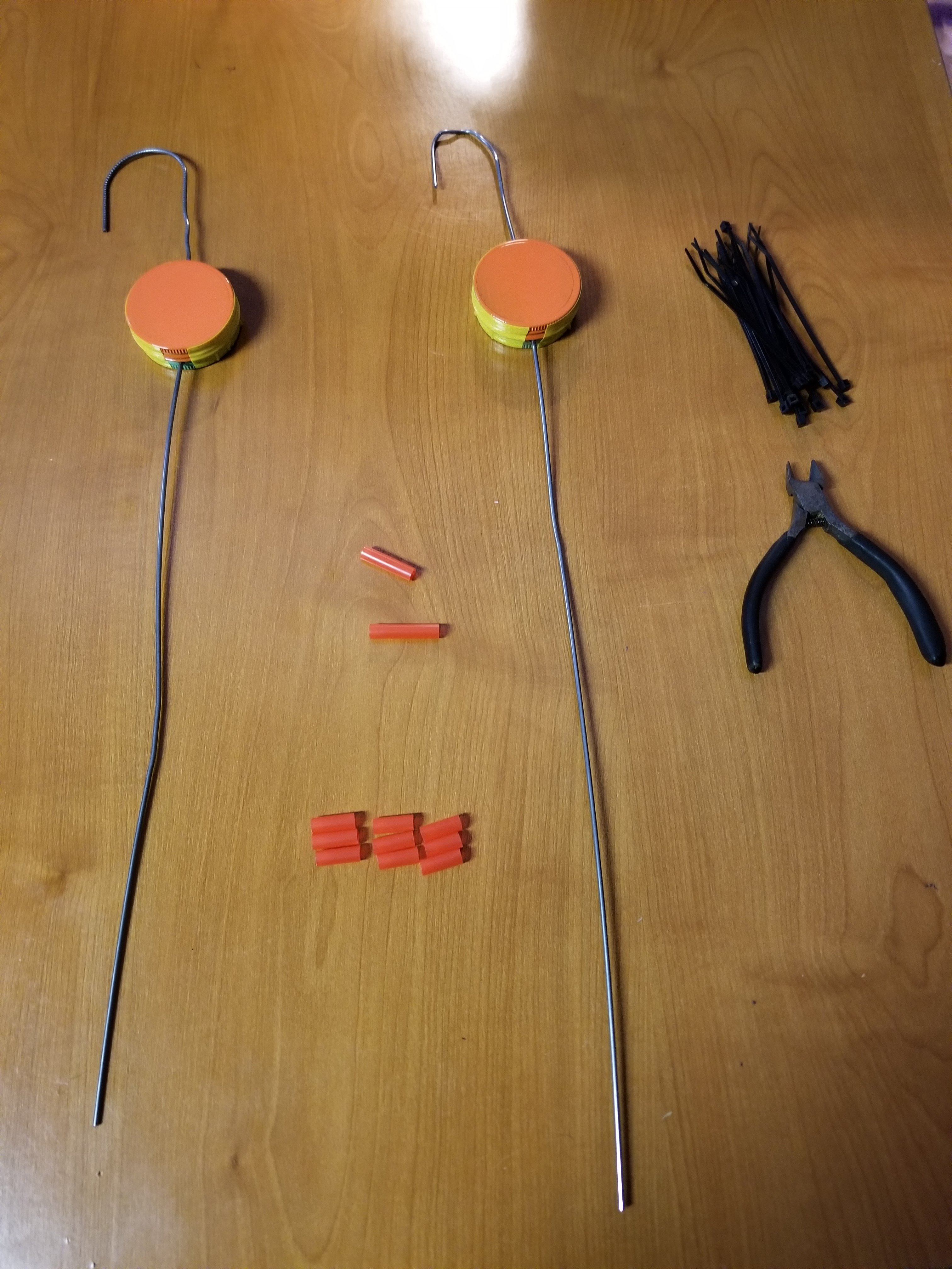

Now take your wire hooks and start threading on the tins:
Adding the straw-spacers in between the tins:
Put slits in the end of the longer (1") straws like the previous procedure so you can install 3 tie-wraps on the end to make sure that all of this stuff doesn't go sliding off the end of the coat hanger.
Trim the tie-wraps up:
The final target is shown at the start of this post. I haven't gotten a chance to shoot these targets yet as we have had 20,ph sustained wind with 40-50mph gusts for the last couple days, so I didn't figure that there was any point to fighting the wind for a demonstration, so I will post it when Mother Nature chills out a bit.
Let me know if you have any comments/or anything.
Cheers!
Jonathan

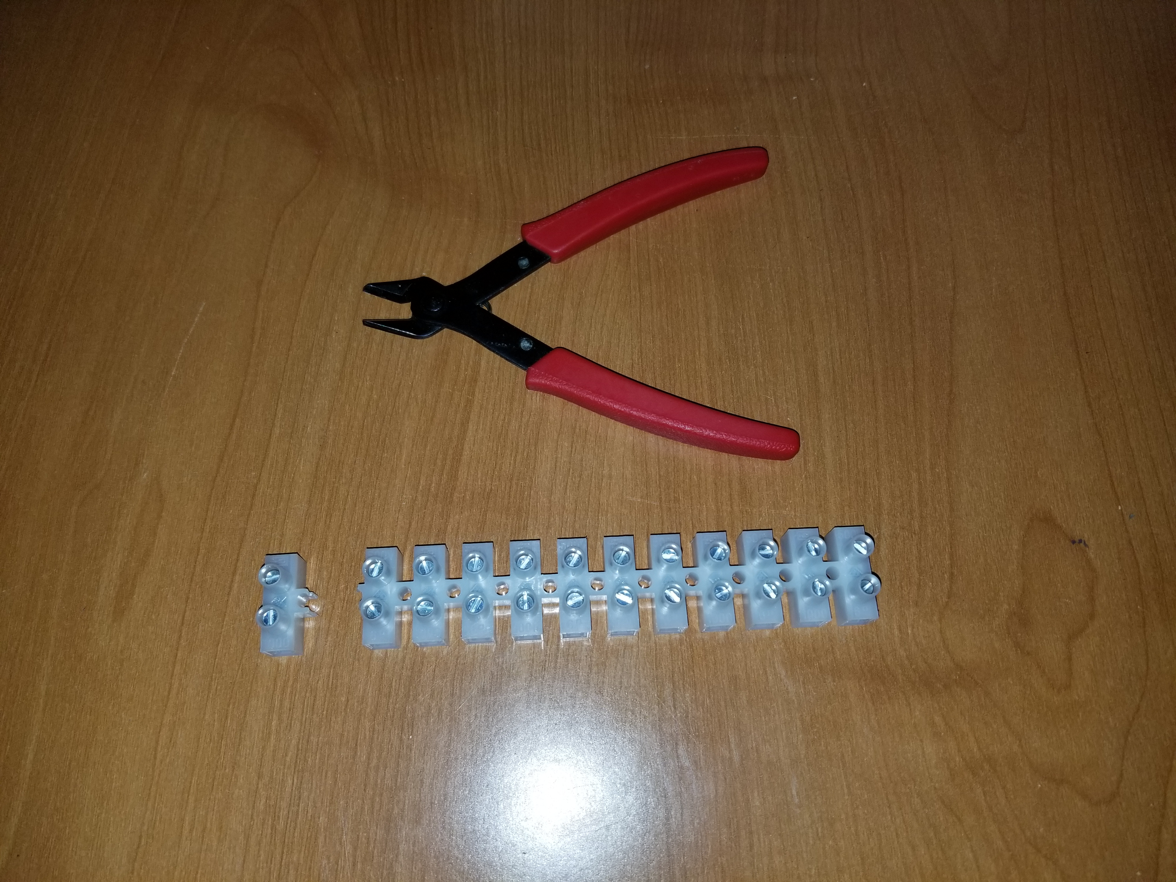

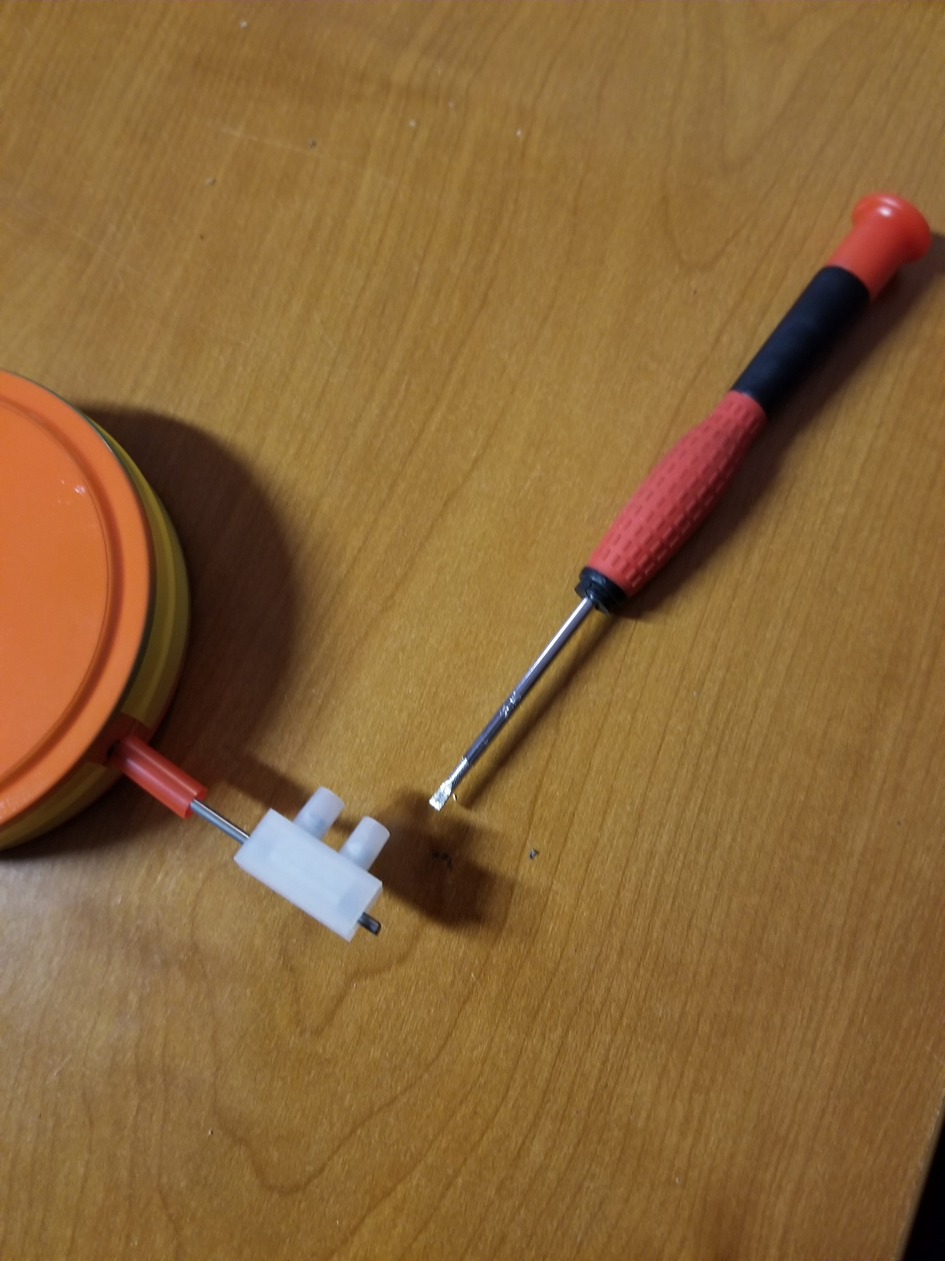

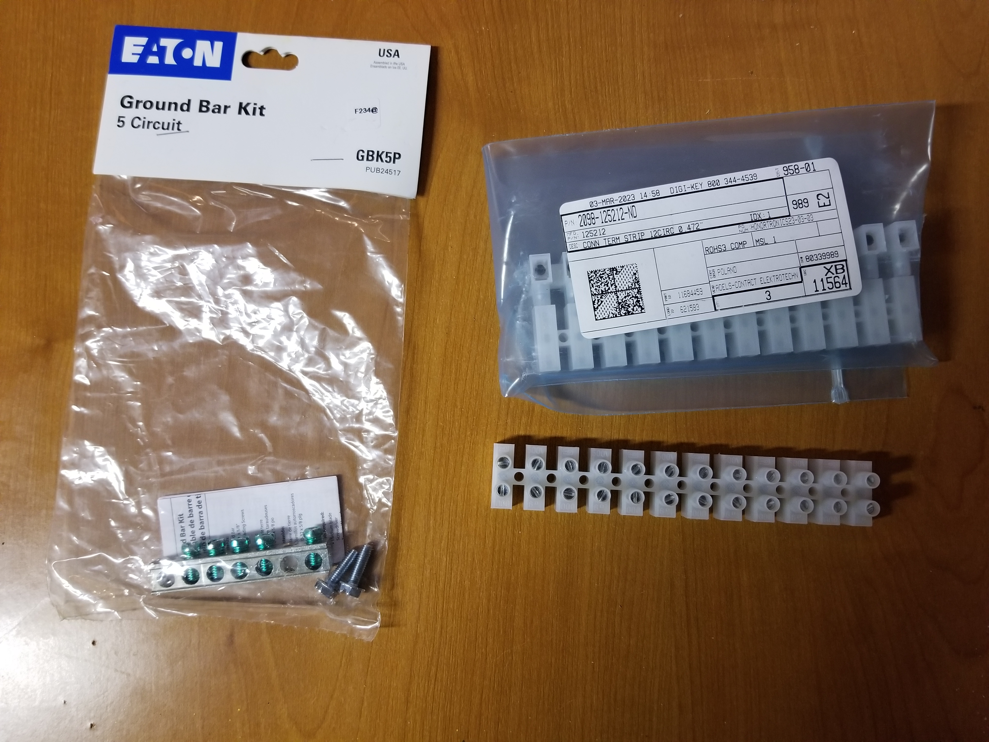

I have one more little update to this design. It turns out that when you are punishing the target, at some point the three tie-wraps on the straw piece at the bottom will pop off and the tins will go flying off the hanger. While this is gratifying, it is a pain in the butt. I wanted to have something that would screw into place, so I picked up these options:
The Ground bar on the left I got at my local hardware for about $10. The one on the right, I ordered from Digi-Key for only $3.03 each. There is no contest, so I am returning the one to the store and using the "Euro-Style Terminal Blocks".
You have to cut the single block off:
Attach the screw terminals to the bottom instead of using the tie-wraps:
Here is the new version:
I'll get out there soon to give these a try, but I expect about the same performance as before.
Once again, Happy Shooting!
Jonathan

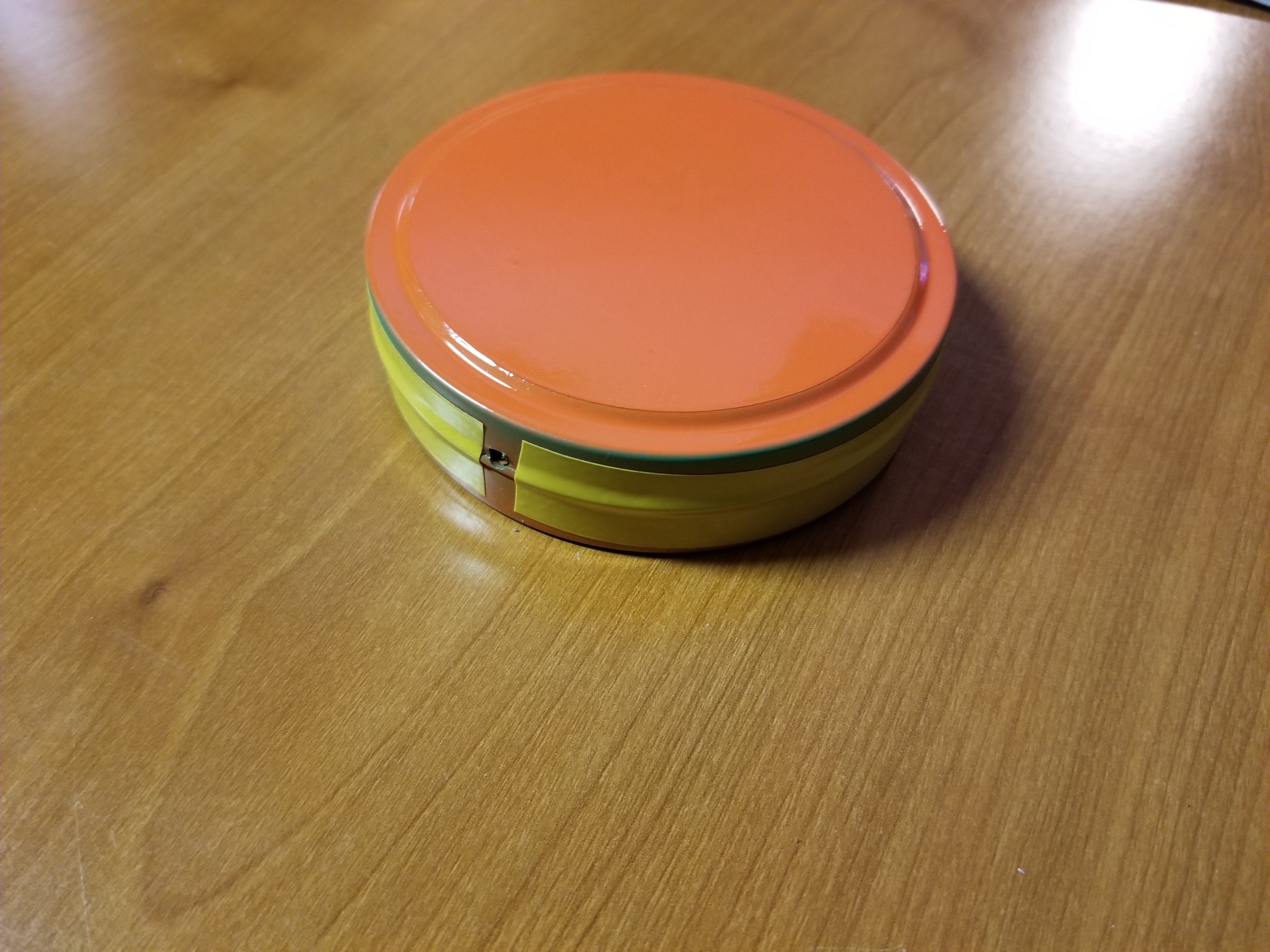

I have made a whole bunch of these spinning targets since originally posting this, and they are great, I must say! Here is a link to the post with a video that I just made today shooting 29 of these little things...among other things.
One thing that I wanted to mention about these targets is that you need to make sure to drill the hole through the lid and the bottom part BOTH. Even if the lid is much smaller than the tin as with this Air Arms tin:
When I first started making these, I was getting "hung up" on trying to get the holes centered exactly, so the tin would be more balanced, and (hopefully) spin better. Well, when the top is small, like the AA tin above, this will blow apart as soon as you hit it. Only the tape holds it together, and that doesn't do well. Doing it like this, will keep it together a lot longer...meaning you get even more enjoyment out of your recycled pellet tin.
Anyway, I wanted to update this thread with this information because I really like these things to hold together until I turn them into Swiss Cheese myself.
