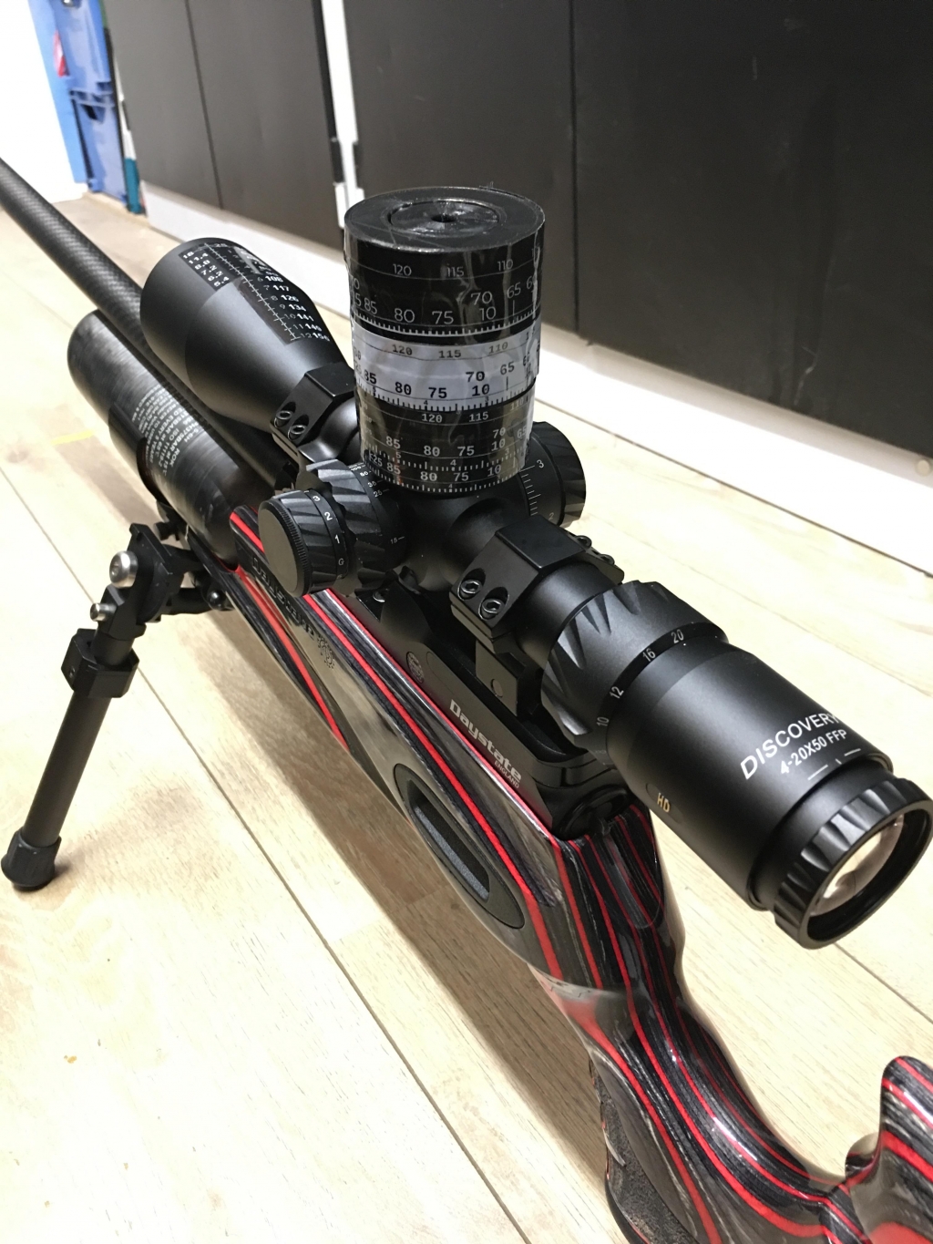

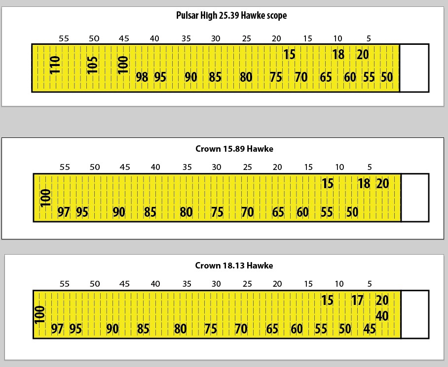

That’s the value at 10 yards. There’s also a “20” to the right. On that scope tape 25 yards is the same as 60 yards but I only print every ten yards and manually put a mark on for 5 yards intervals.

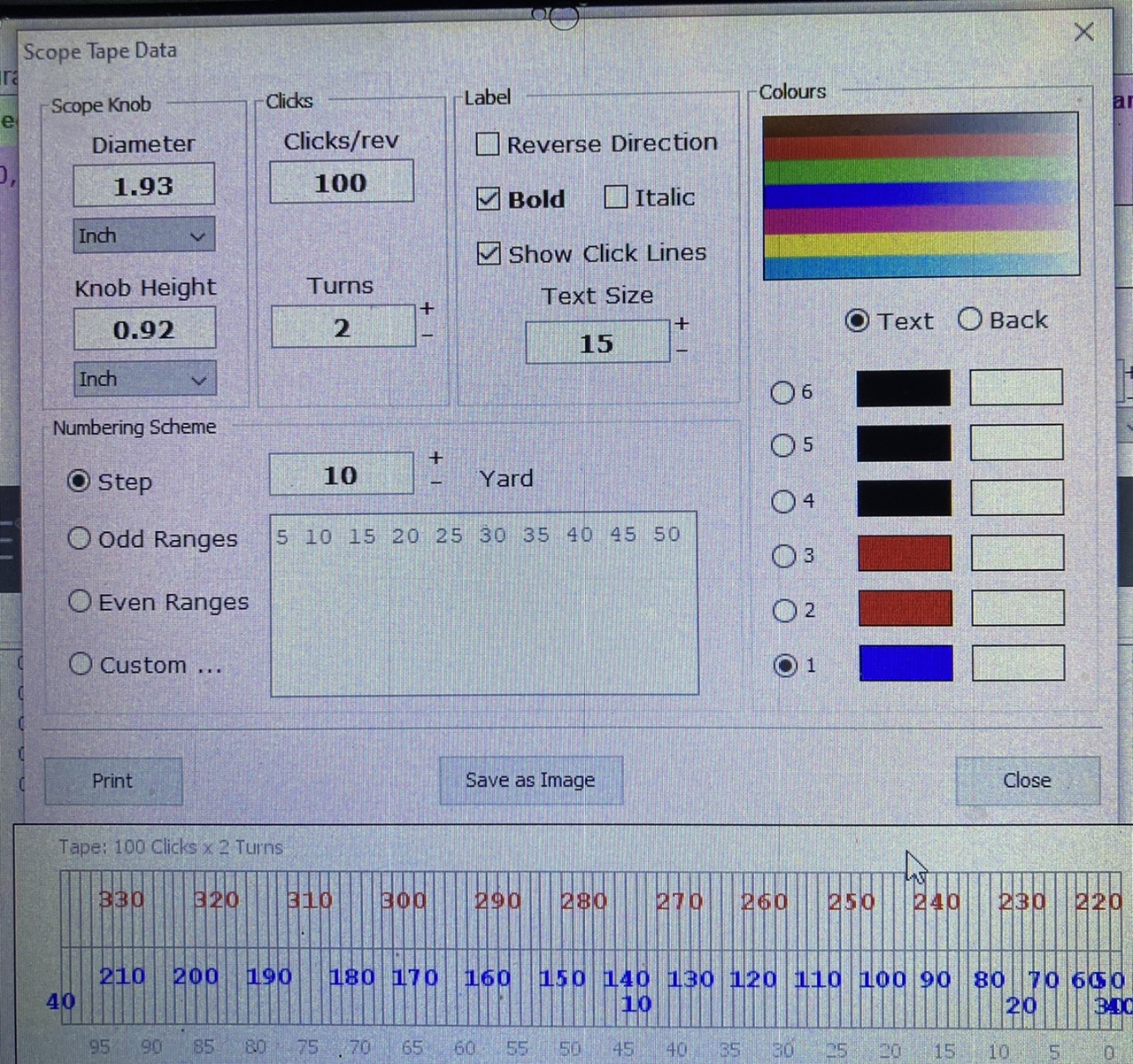

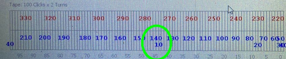

Hello CenterCut, this is what confuses me about my Scope Tape using Chairgun Pro. I have attached my Chairgun Pro display screen on my laptop for reference.
I marked in pink rectangle my points of confusion.
Why is 20 and 40 yards occurring on the same Click Value on the first revolution of the Elevation Knob? On the Table on the left, they are not of the same click value.
A similar condition happens on the 75 and 10 yards as well. The attached diagram in my actual Chairgun Pro screen for my pellets in use.
I really want to understand this. Thanks much.
Its because due to your scope height and pellet speed, you have the same elevation for two values. So your gun will shoot at 20 and 40 yards because when you have the turret at 40/20, at 20 yards the pellet is going UP towards the zero, and at 40 yards the pellet is going DOWN... Same for 10 and 75 yards.
Thanks for the reply. I will try that out in the field. I admit I am still somehow confused but I will be happy if I get close enough. Then that shows I am learning a bit here. Thanks again.

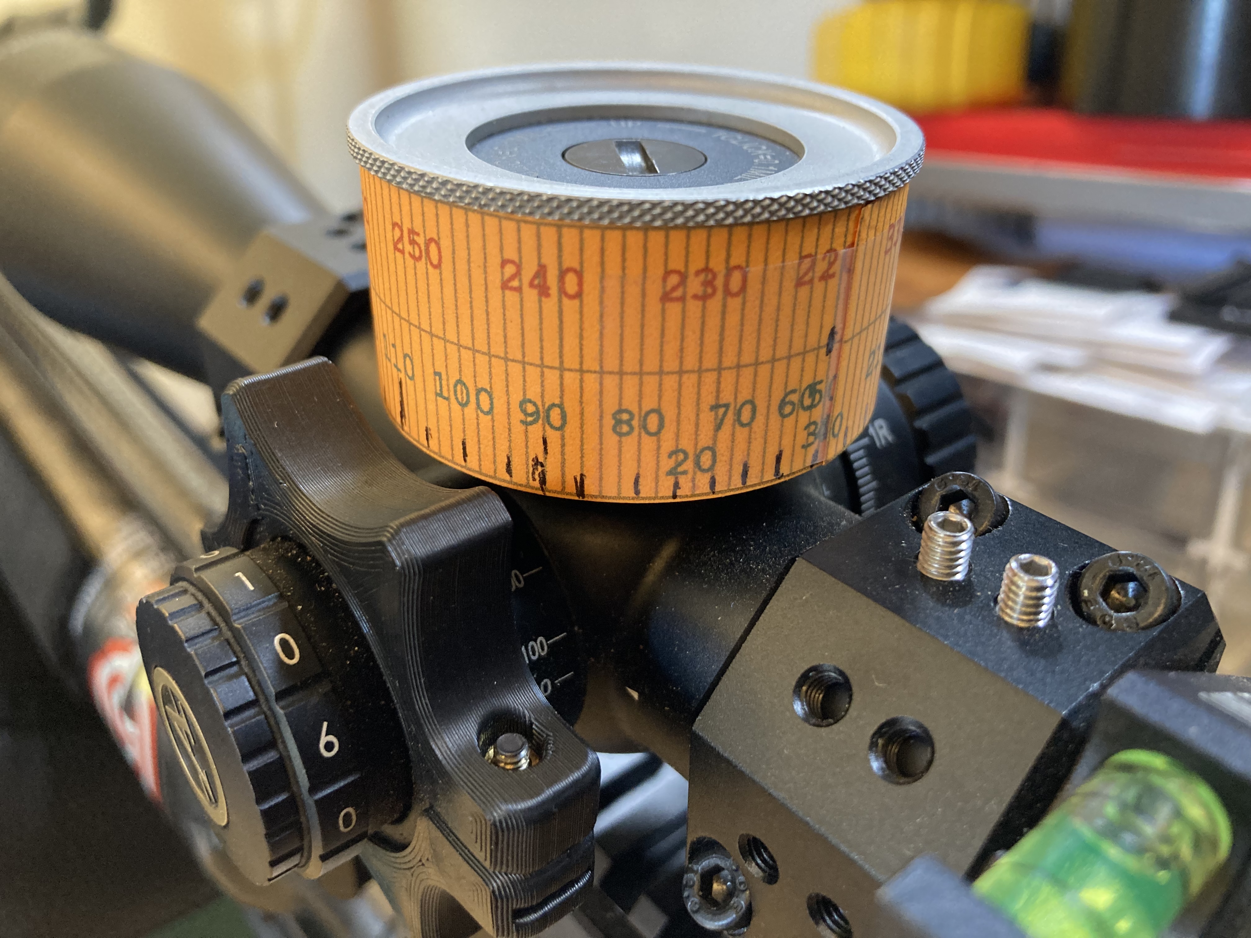

After trying different ways to make the labels, I have to agree that Loeon in correct.
The only issue I had was playing around with the turret diameter size to get things to line up correctly.

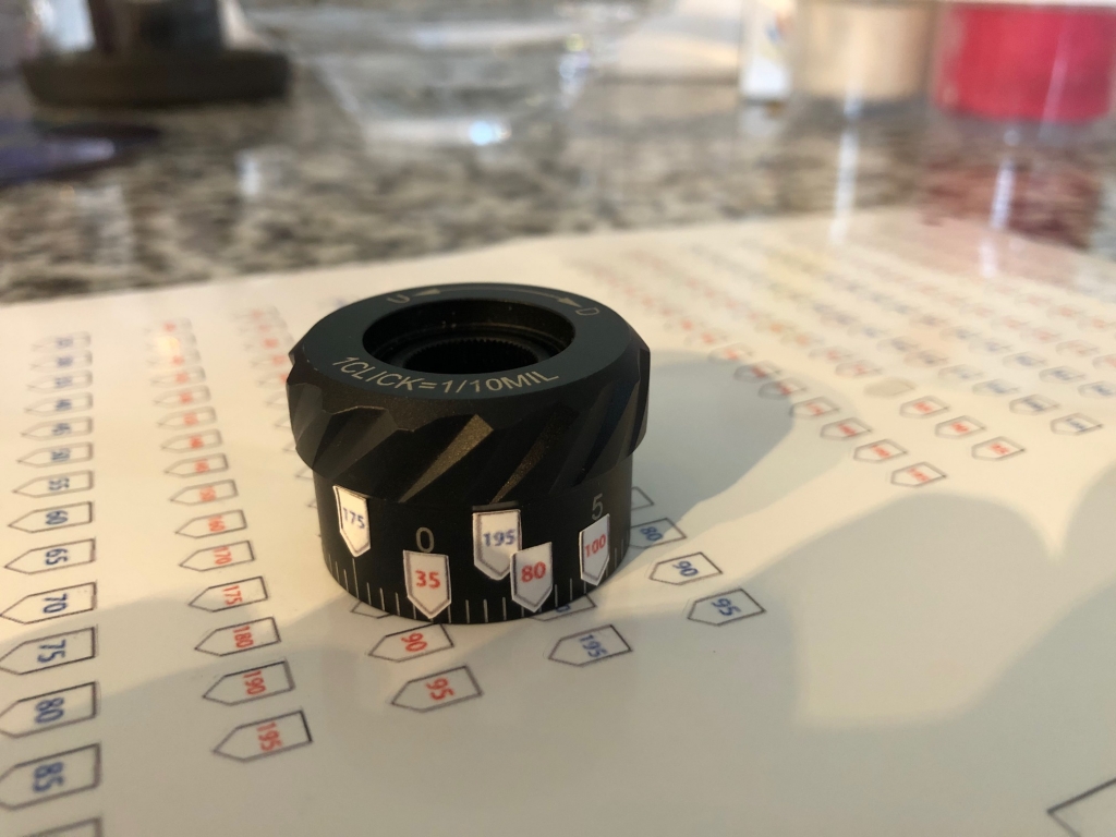

Not to make a sales pitch but I tried this so many times with so many turrets, projectiles, guns, scopes....there are just way to many factors to think that math can compensate for all of the changing variables and still be dead nuts accurate all the time. If you need dead nuts, you need to shoot the gun and mark the yardage, there's simply never going to be anything more accurate than reality.

We’re can I buy some of these stickers
