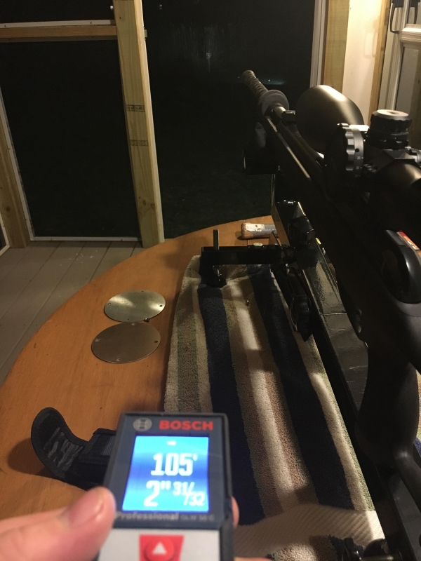

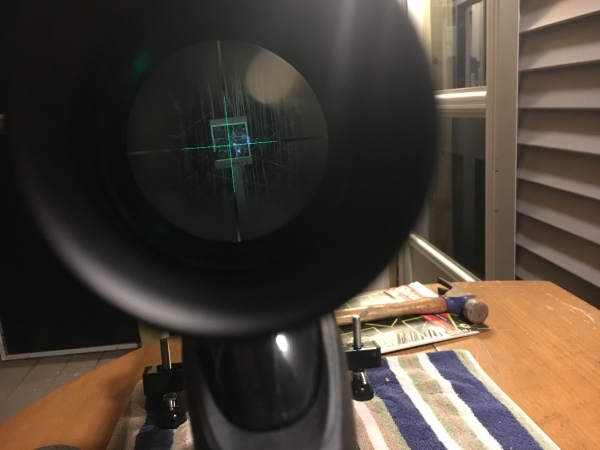

don't take this as a complete failure on SWFA SS 10x42 Tactical 30mm Riflescope until we see how well their customer service is. but this is what happened after about 100 shots on my RWS Diana 350 Magnum Springer .Diana can be a real bitch to scopes even with their Bullseye scope mount.My very first shot was a high bullseye at 25 yards the Scope was dead on right out of the Factory Clear as a bell loved this scope will see what SWFA does. I will keep everyone updated . I did Email them and ask them this question (here is the email)

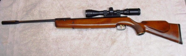

I have the bullseye mount on my Diana 350 Magnum .Heads up you need to make sure that the set screws that mount the rings to the two rods stay tight mine came loose also you will need to clean them at the same time you clean and lightly oil them when you clean your gun your gun. Mine was one of the first and didn't have o rings or spacers like the one in your photo.I have had good luck with mine as far as accuracy goes.
